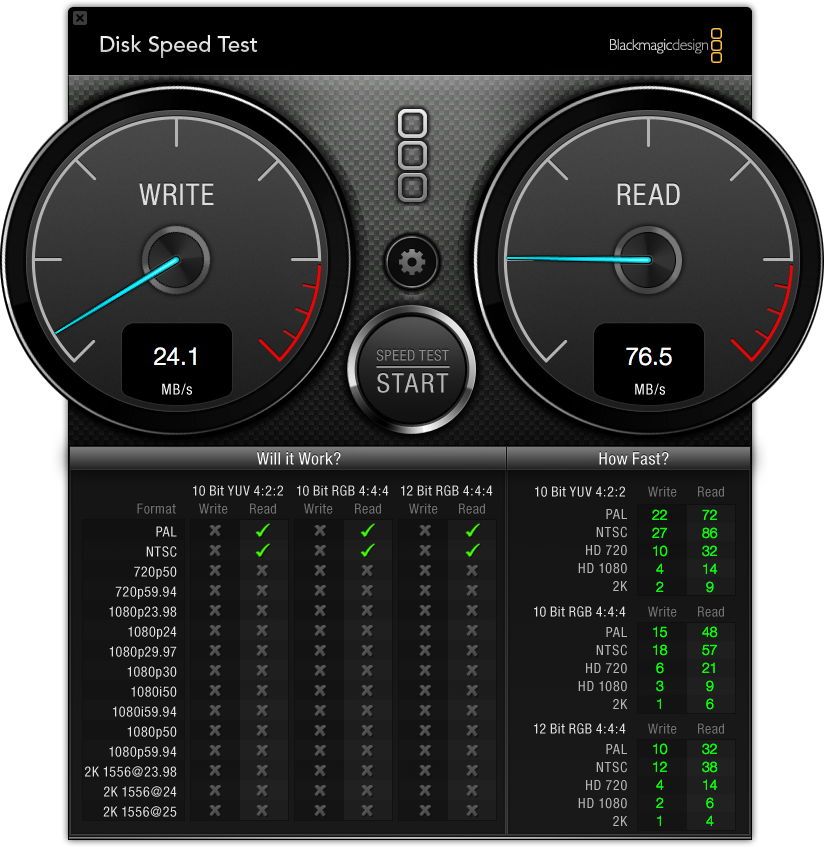

So this isn't USB 3.0 speed?

This is nonsense, because no USB 2.0 bus supports a real signaling rate of 480 MBit/s (60 MByte/s). The limit in the USB 2.0 standard for the maximum signaling rate is 480 MBit/s or 60 MByte/s. The real speed is in the range of ≈ 30 MByte/s (max.). Btw, the transfer rate depends also on the device/firmware/controller. Good examples are NEC and Oxford Semiconductor USB 2.0/USB 3.0 controllers.
Apples System Profiler and Apples USB debug tools tell you the real speed of the interface or device. Transfer rates are meaningless, because a cheap USB 3.0 device can have a transfer rate of 10 MByte/s or less.

Quoting the maximum speed of USB 3 is not really adding anything to this discussion. That's the speed that USB 3 CAN transfer at; it does not magically mean that every USB 3 device can achieve that. A 2.5" 7200 RPM hard drive can transfer data at around 110 MB/s. A USB 3 small capacity flash stick is a lot slower. USB 3 is capable of around 450 MB/s.
A transfer protocol is like a road. Just because a road is safe for 450 km/h, it does not mean that any Trabant can now all of a sudden do 450 km/h. It will still only be able to do its normal maximum speed.
Which drive are you using? That's the speed it's supposed to be.
What do you mean "supposed to be"? There is no "supposed to be" for a USB 3 device. It depends on the device. If I put in a really fast SSD drive into a USB 3 enclosure, then I can get the top USB 3 speed (around 450 MB/s in sequential reads and writes). If I use a RAID 0 USB 3 enclosure with two 7200 RPM 3.5" drives, then I could get around 220 - 280 MB/s.
If I use a 2.5" 5400 RPM hard drive then it will do around 60 MB/s. And it does not matter if I put this drive into a thunderbolt or USB 3 or Firewire 800 or eSATA enclosure.
Edit: The figures above are averages and for illustration purposes only. Some drives are slower; some drives are faster. The performance of a USB 3 device is dependant on the speed of the device itself and the controller that it has implemented. For example some USB 3 external HDD enclosures are better than others, that's why they don't all cost the same.

its a seagate drive, i believe the seagate expansion 3TB drive. 7200 RPM SATA drives with 3 1/TB platters. i got mine for about $125 from amazon 4 days ago. i think the apple tech supports are a bit right though, the firmware has to be recent to really achieve these speeds.
Plugging in my 2TB Western Digital Passport using black magic's disk speed test I got 90mb/s right and 95mb/s read. This is correct, USB 3 is delivering the speeds but remember the drive is now the bottle neck.
Most mobile notebook drives are 5400rpm drives. It's not USB3, it's the hard drive.
