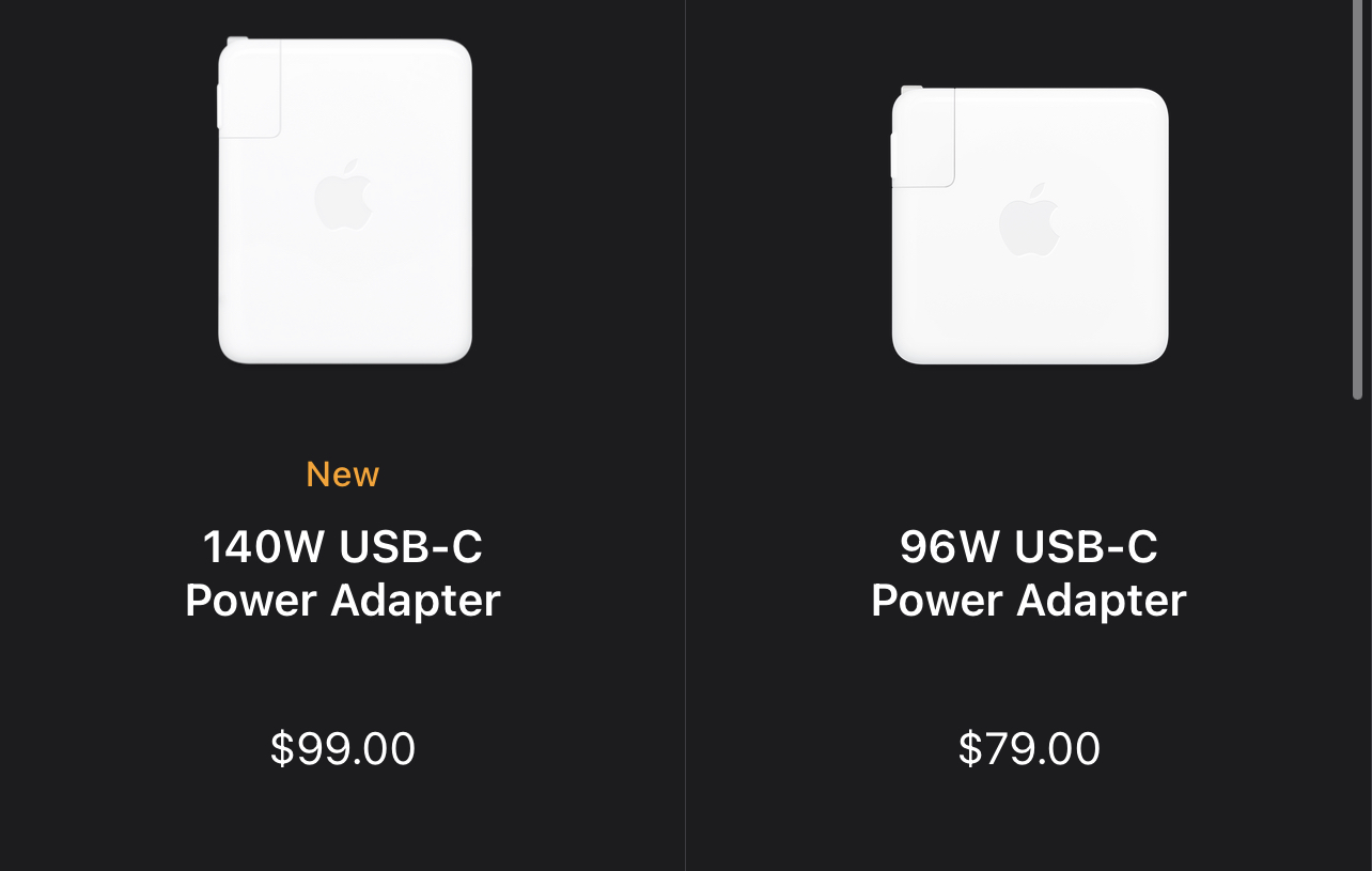

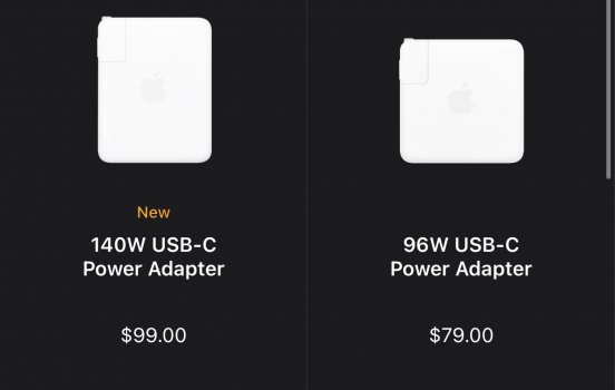

Looks like the 140W is already GaN
You would think though with the GaN technology it would still be significantly smaller. The size of the charger seems in line with the older non GaN Apple chargers.
Reactions: Lwii2boo
Keep in mind this is the most powerful of its kind right now at 140W. GaN chargers still have thermal considerations, which drives some sizing.
And nobody knows the actual dimensions of the brick right now, but it seems to be roughly the size of the 96W. So that’s a considerable miniaturization for 40% more power.
