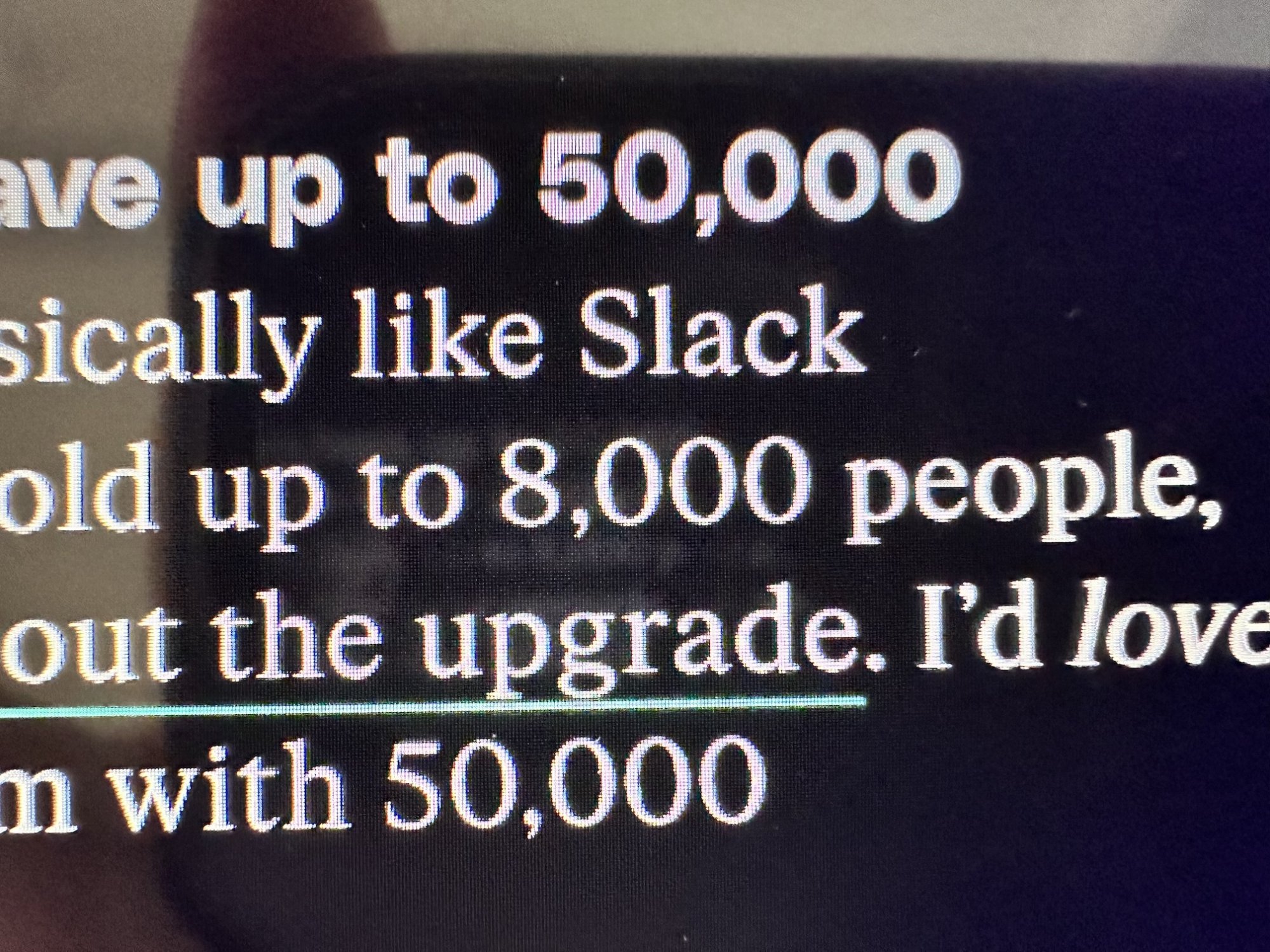

Had my 15" MBA for a week or so and the display does cause me eye strain. I think it's because text looks a bit fuzzy at the default resolution. Pointing my iPhone camera at it shows there's some kind of weird scaling or sharpening artifact where text has a slight halo, almost like a cartoon outline. It goes away if you set the resolution to 1440 x 932 but you lose some of the benefit of the 15" screen real estate if you do that.
The 14" also has this fuzziness. You just don't notice it likely because of higher ppi.
When it comes to scaled resolutions, I think all MacBooks do in fact produce fuzzier texts than native 2x scaling. In this case, the 14" just exhibits a bit less of that fuzziness due to it having higher PPI. But in reality, it doesn't escape from this fuzziness either way. I do see the 14" being sharpest possible at its native 2x scaling resolution of 1512x982.

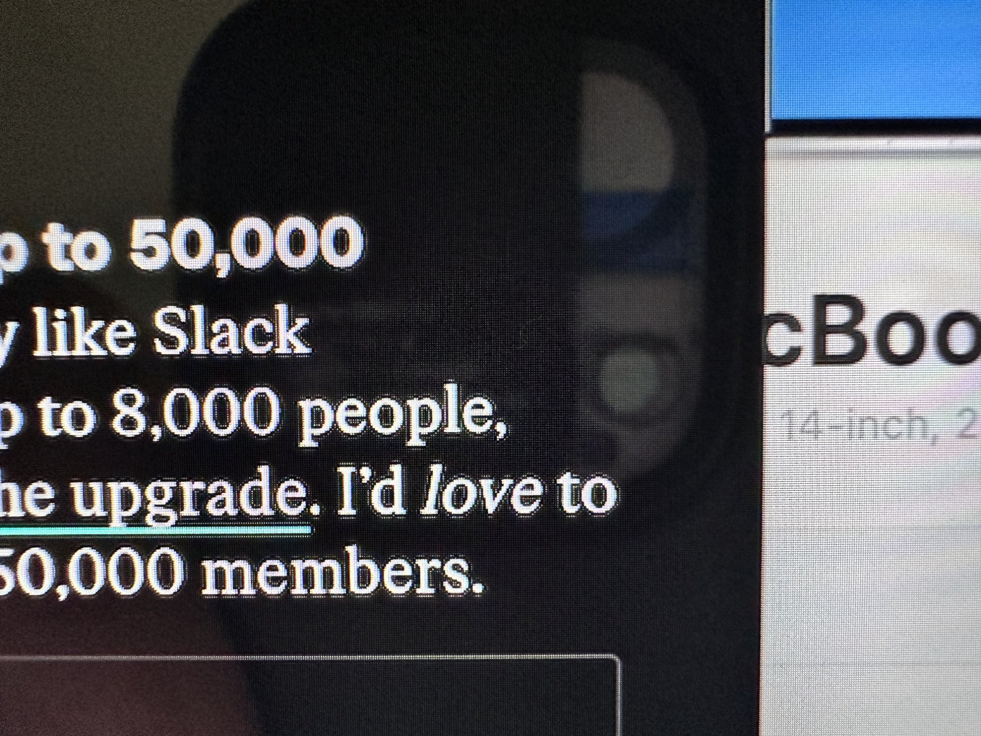

Interesting! I checked this carefully with my iPhone camera, a magnifying glass, and also a microscope. What specific model of the MBP 14" do you have? I have an M2 Pro 12-core MBP 14" manufactured October 2022 here, and it doesn't show the fuzzy effect at all. Here's a close-up at non-2x 1800x1169, with no halos visible. I can't get halos like the 15" MBA at any resolution I tried on the MBP 14". So I'm thinking maybe you have an M1, or a different edition of the M2 chip, and this is something that Apple has improved on somehow in more recent chip versions...
I do have the M1. As you said, it's likely Apple did something with the screen of the M2 model to mitigate the issue. Or maybe I just have the short end of the screen lottery twice somehow. Still, 2x scaling indeed doesn't show any problem at all.
It's pretty much perfect at 2x. No ghosting or fuzziness whatsoever on both displays.
Yeah my guess is they fixed it between the M2 and the M2 Pro, since the M2 was released first and has the issue. The good news is, that means it'll probably be fixed on the 15" MBA M3 when that comes out towards the end of 2023 / early 2024.

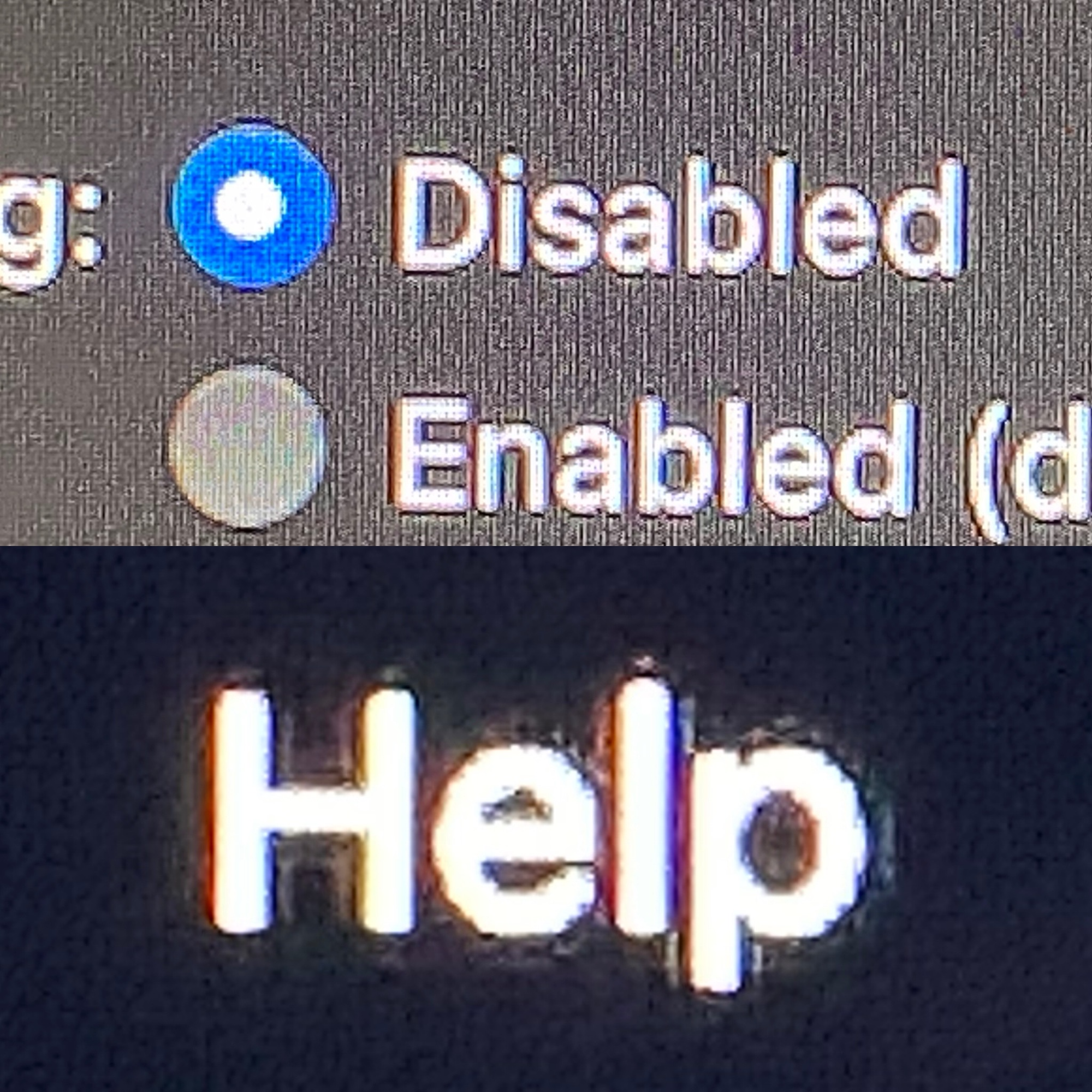

The fuzzy outlines around text due to the sharpening filter applied at non-integer scaled resolutions on the older chips, specifically the M1 and the non-Pro/Max M2. This is one cause of eye strain for me, but there could be other things that cause eye strain on the M2 MBPs (though I don't get eye strain from these personally).

Thanks for the suggestions, I tried all three but they don't fix the halo artifact from the sharpening. It seems to be a limitation of the hardware scaler in the chip.
Thanks. I should go spend some time with an M2 pro in the store. This is definitely one of the problems that was affecting me. It used to look like the edges of letters were moving.

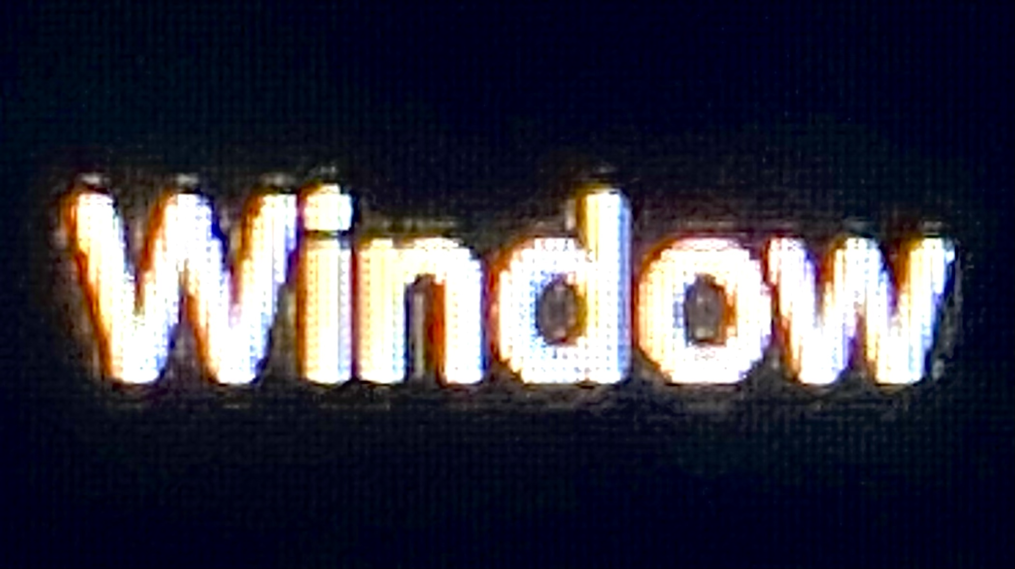

That doesn't fix the fuzzy text. It just makes texts less bold so that the issue is less noticeable. If you take a photo the way I and @CloudsNeverDie did, you'll see that the outline is still there.
I've given this a try on the Mac Studio and yes, the text now appears less bold and less contrasty but I'd say the text arguably looks better, it's more a real rendering of the font and not boosted + over-enhanced. Like all things, there will be an adjustment period as the font smoothing boldness shouts at my eyes and feels punchy, now the text looks a little lighter making it seem a little less appealing at first glance - I think it's easier on my eyes with it off.
