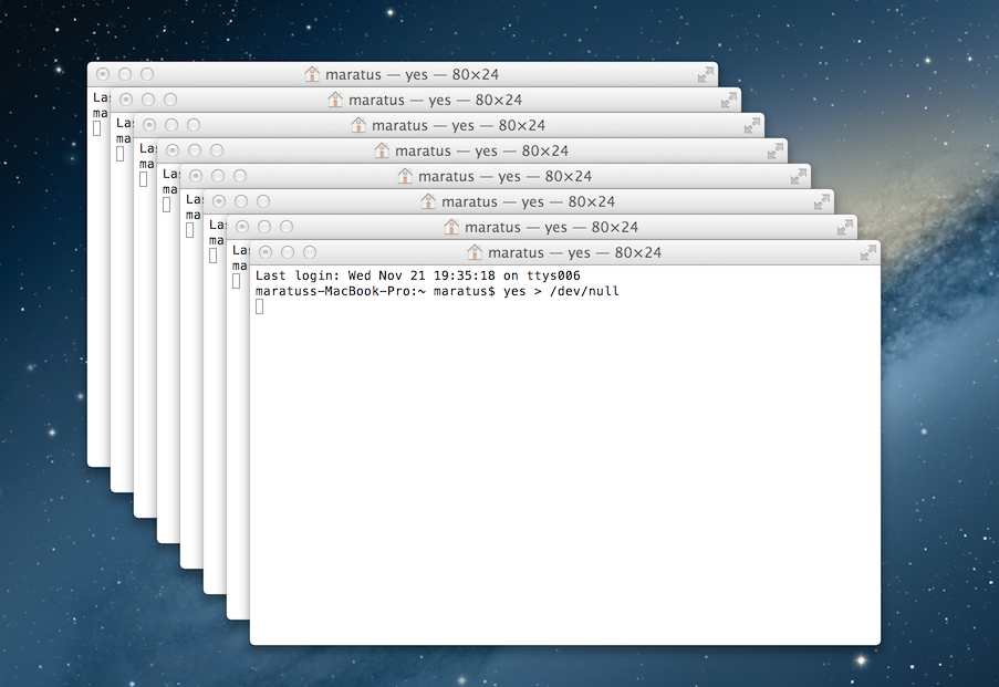

    3. Open terminal and execute this command:
    yes > /dev/null
    create a new terminal window and repeat 8 times. Now you have 8 processes that load your CPU up to 800%.

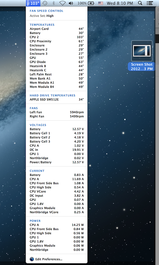

    [​IMG]
    Here's what iStat menubar looks like on the 2.6Ghz model:
    [​IMG]
