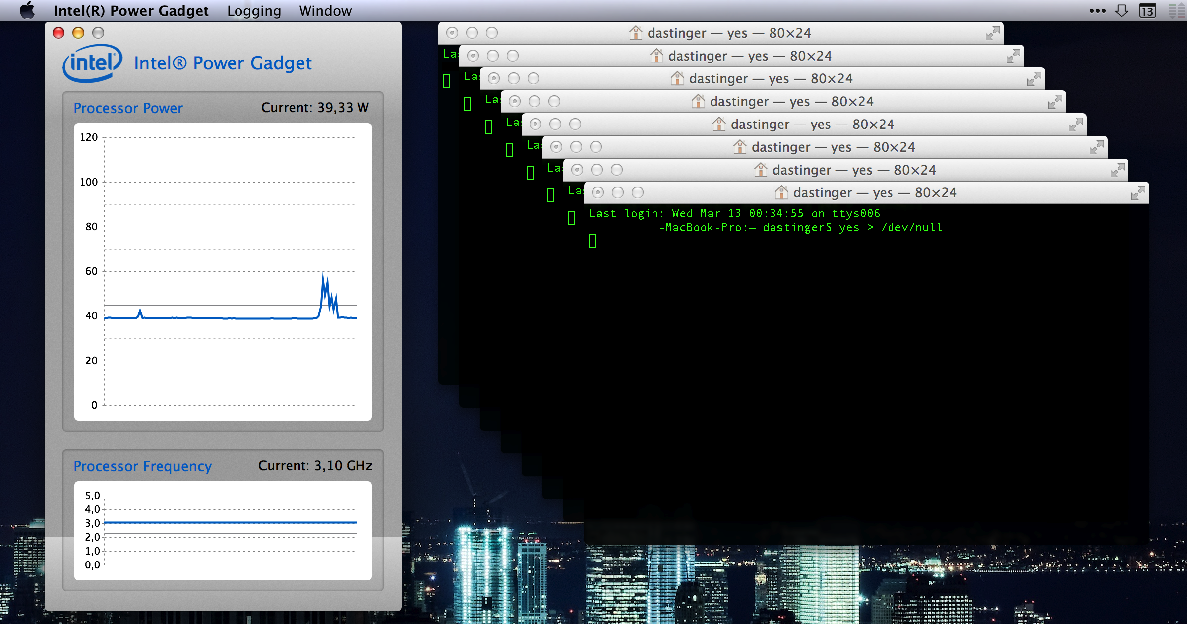

Ran this yesterday with Power Gadget up and running. Didn't log the results but I'll do it again once I get home and post here. I was trying to induce the SMC bug. I know my rMBP suffers from it but I haven't been able to, now that I want it, to test and discuss this with a hardware engineer.
Here are my results.
Mid 2012 15" rMBP
Been running the command for 10 minutes when I took these screenshots:

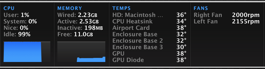

These were taken some minutes after terminating the processes and with Chrome running 9 tabs (first and second were not taken exactly at the same time):
My UI started lagging after the test so I guess I managed to trigger the SMC bug. I'll play a bit under Windows in a minute and be sure about it.

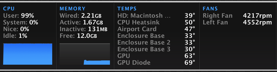

According to screenshots of post #54
I see that temps of GPU were 63C and GPU diod 69C while NVIDIA 650m was switched off. I believe NVIDIA GPU was heated by the hot heat pipe (CPU and GPU share the single heat pipe). So we know the temperature of heat pipe at the location of GPU. It is about 69C
Here are my results.My UI started lagging after the test so I guess I managed to trigger the SMC bug. I'll play a bit under Windows in a minute and be sure about it.

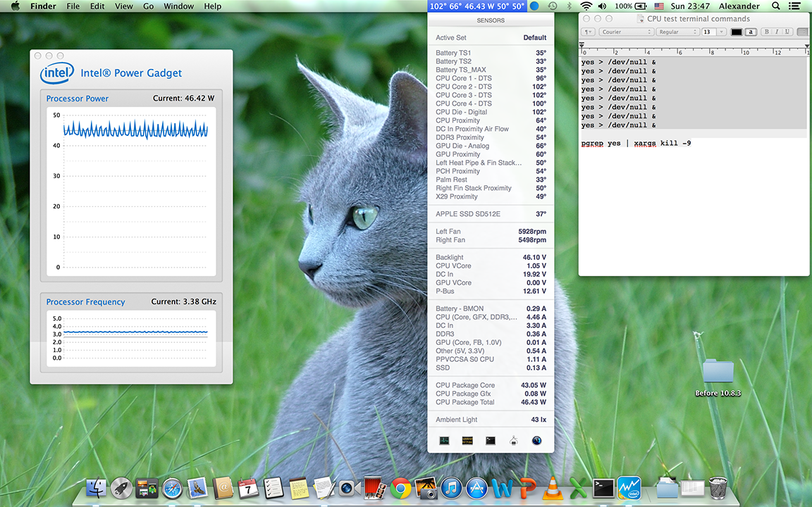

Early 2013
rMBP 15" 2.7GHz 16GB RAM
MAC OS 10.8.3
My results:

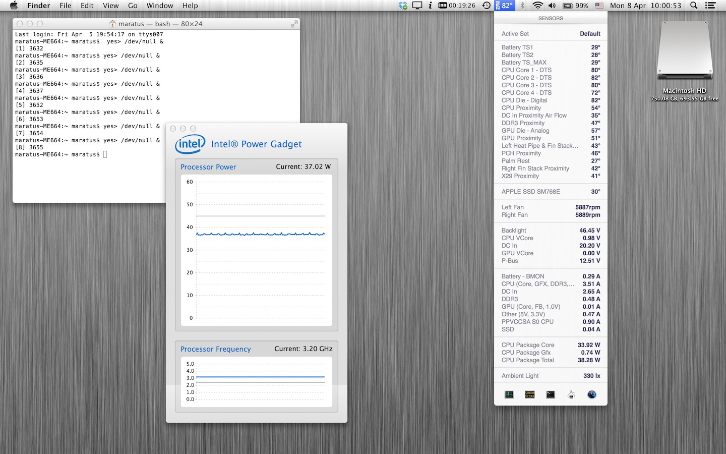

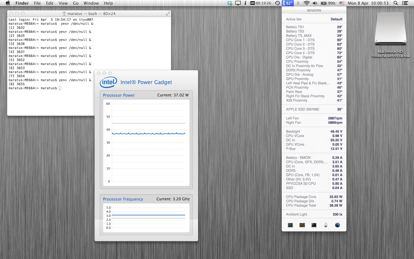

Interesting.

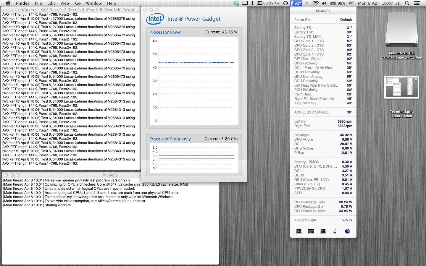

Here're my updated results for comparison.
Early 2013
rMBP 15" 2.4GHz, 16GB RAM
Mac OS 10.8.2
First is 8 processes in terminal -> 37W
Second is 8 threads of Prime95 -> almost 44W
So far, the Palm rest / Battery temps seem to reflect ambient temps more or less consistently.
Performance of the thermal interface can be derived from CPU Die minus GPU Die - Analog, because when 650M is switched off, it's temperature is very close to that of the heat sink.
The efficiency of the fans/radiator can be derived from GPU Die - Analog minus ambient or, which is somewhat safe to say, Palm Rest/Battery average. Palm Rest is being heated up a little bit but it stays within 2C of idle temp for quite a long time.
These calculations aren't extremely precise but are good enough to do a direct comparison. My battery / palm rest temps are slowly rising to 32C now when idling as I switched it on only 30min ago, so we probably have the same ambient temperature. At the same time we both have 66C for the heat sink when CPU wattage is similar (mine Prime95 and yours terminal load)
