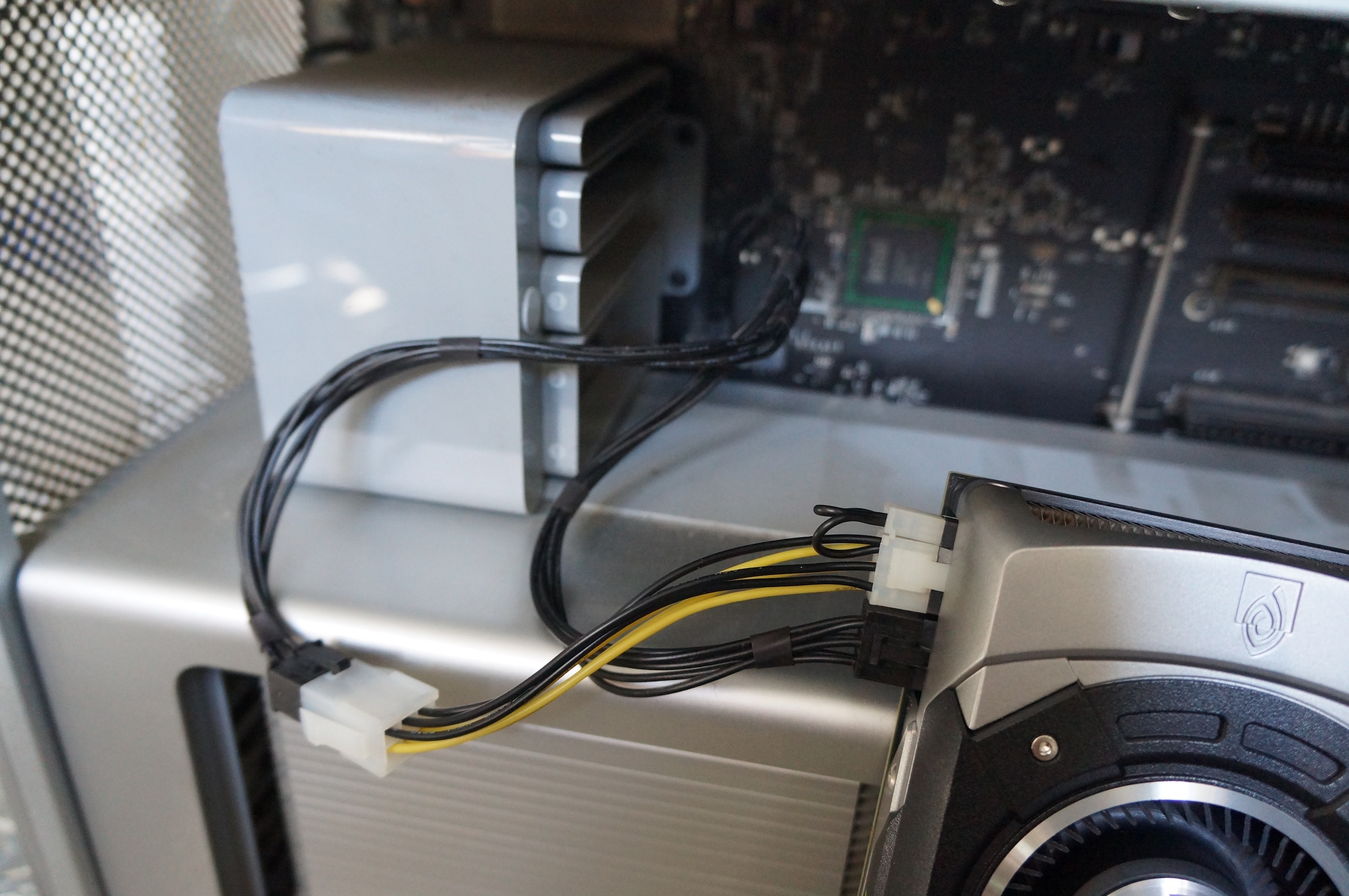

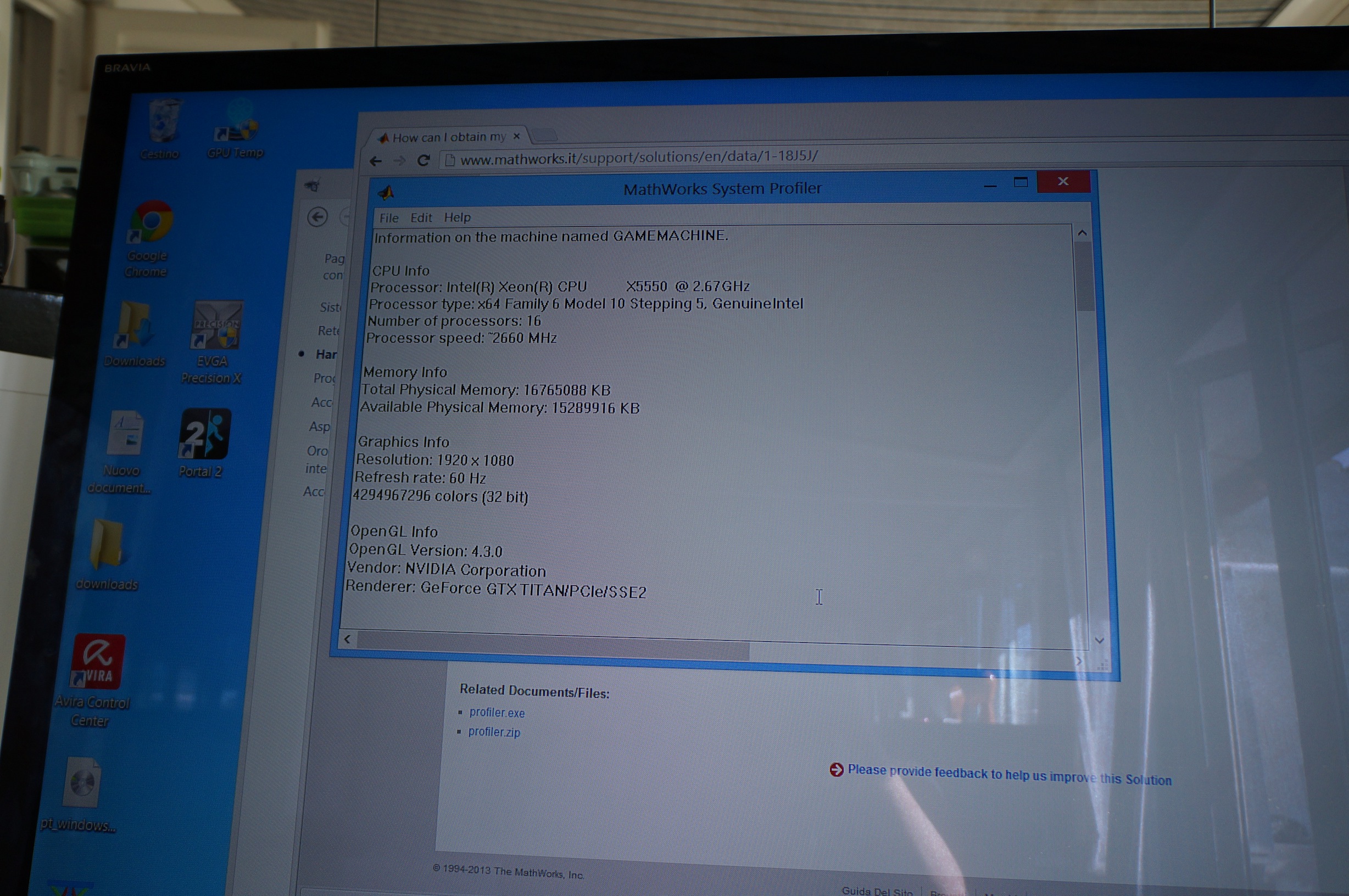

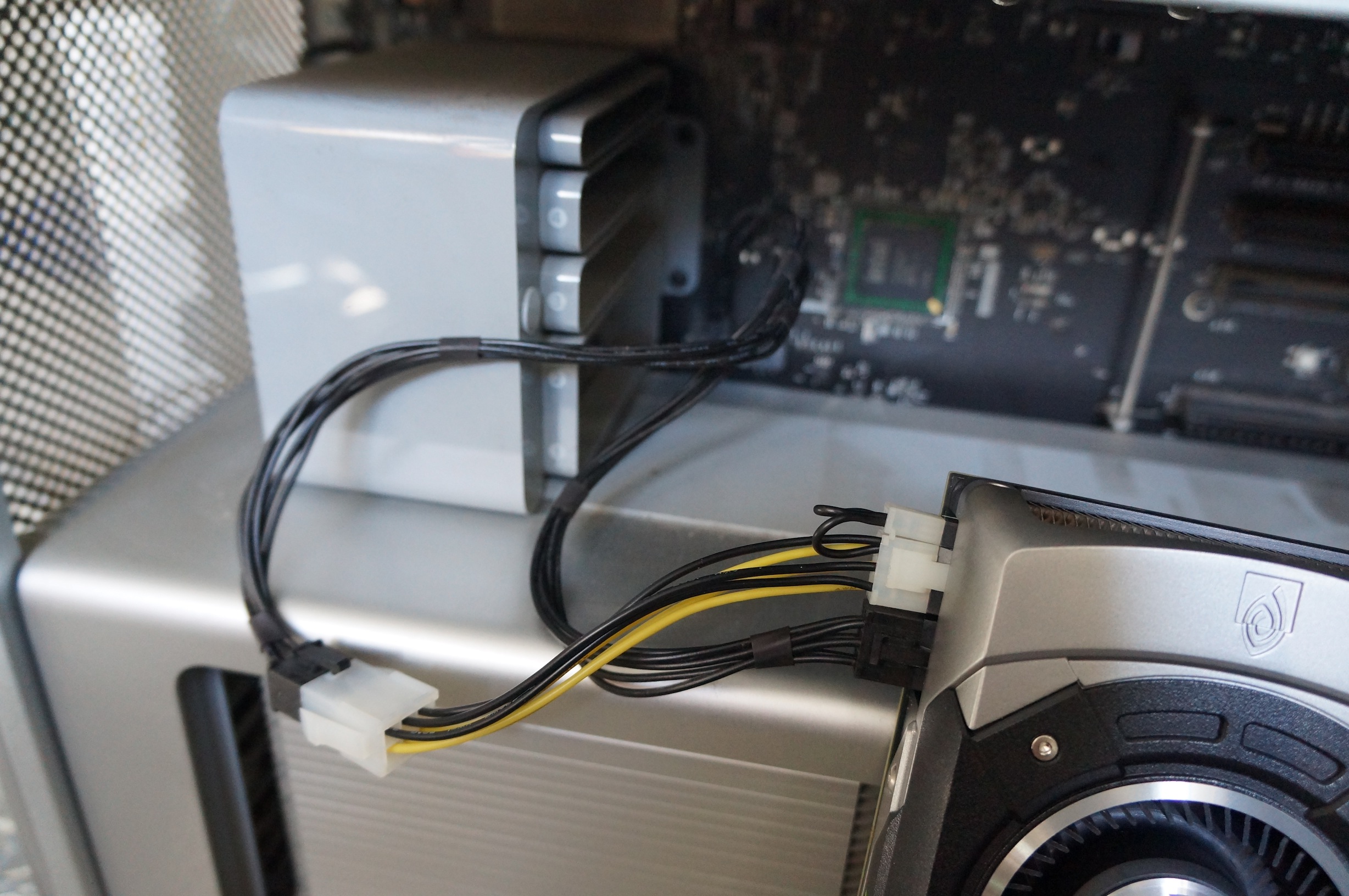

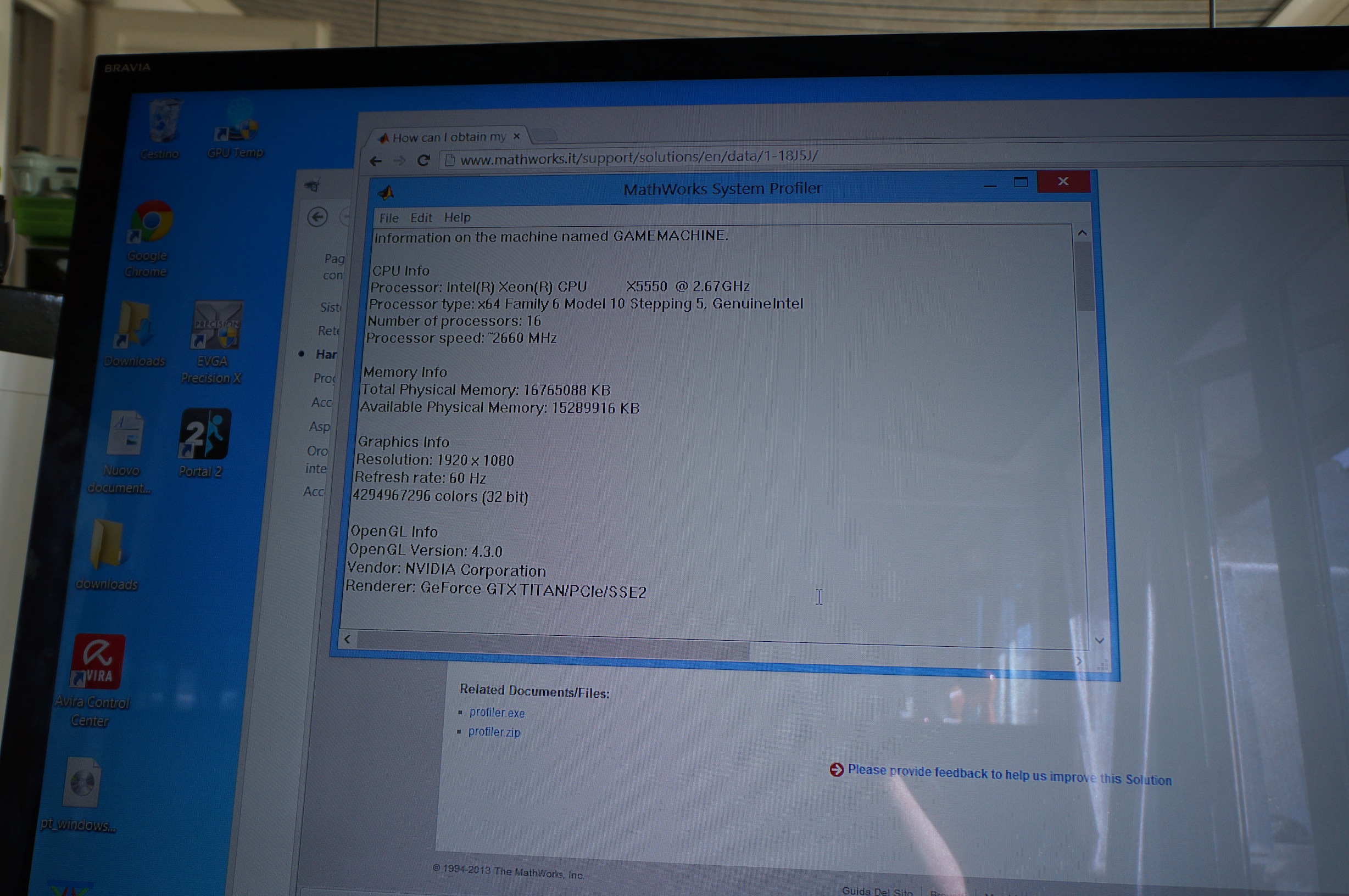

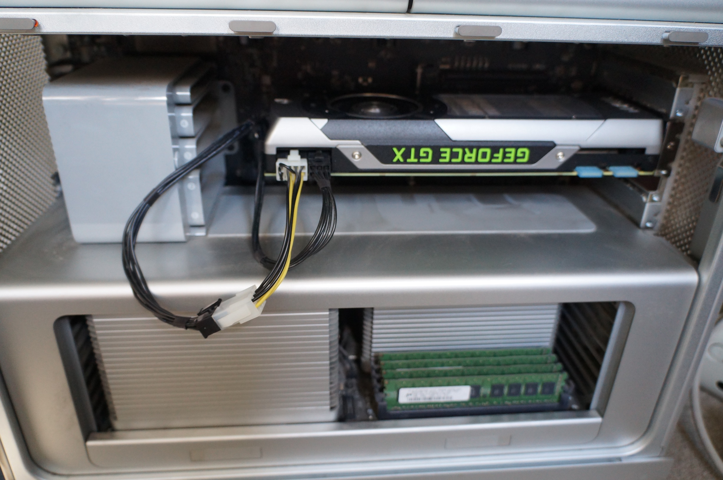

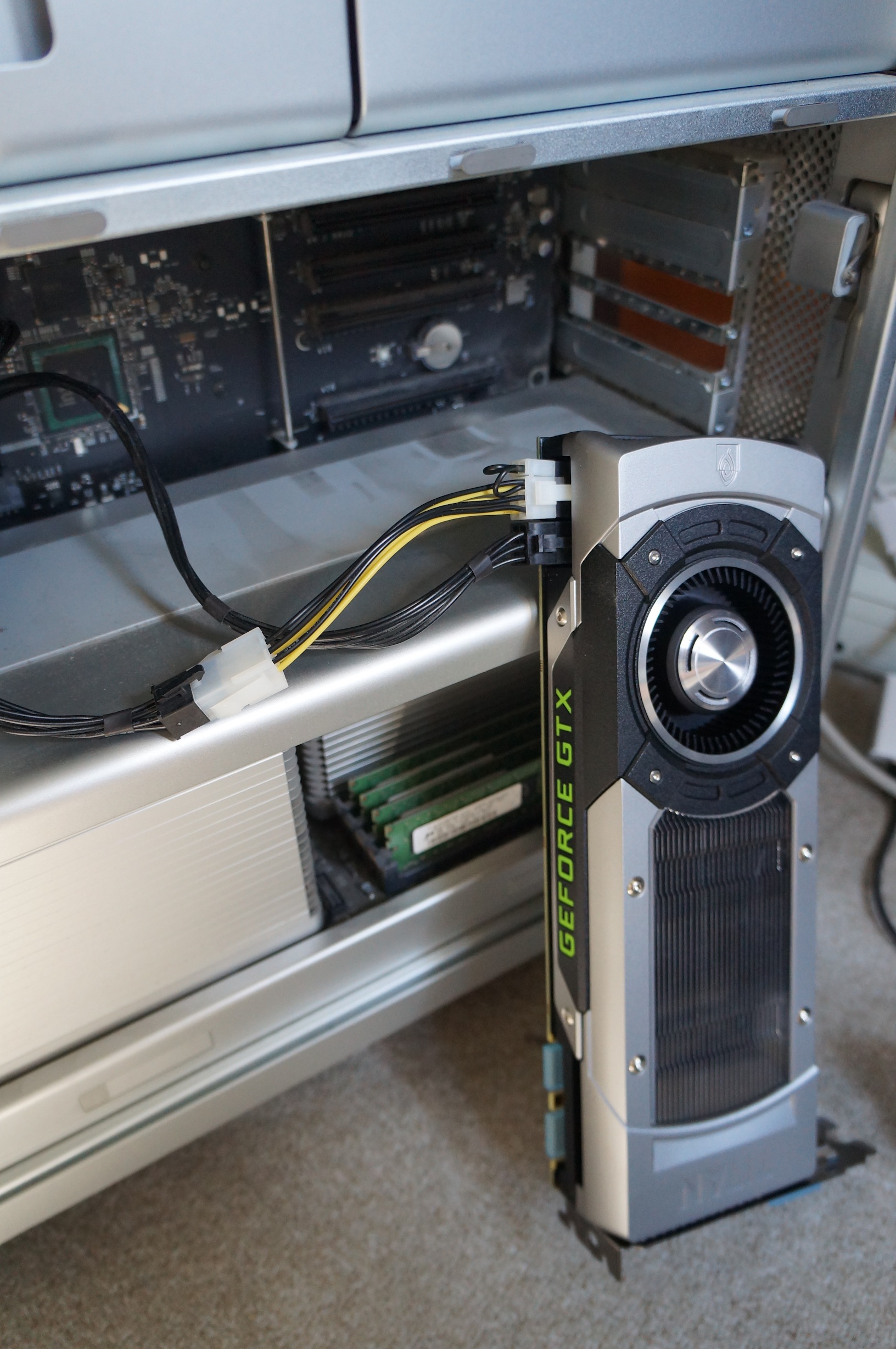

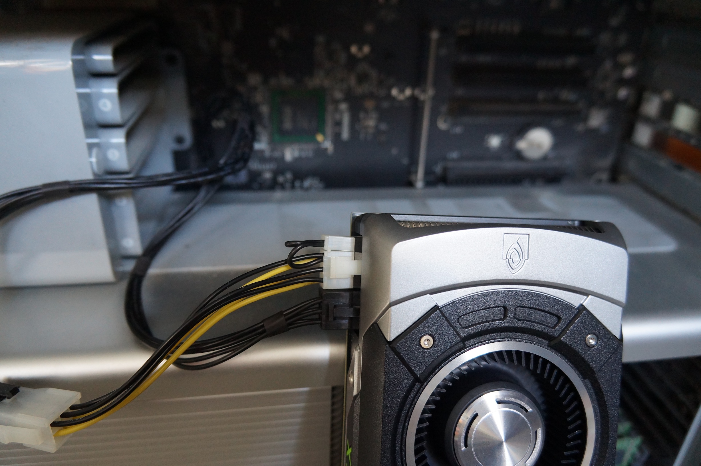

I am moving a mac pro to a gaming machine.
The computer is now working under windows 8. NO POWER HASSLE WHATSOEVER. No power setup. Just a standard 6 to 8 pin adaptor.
I believe this is going to be the new official mac pro top card in next models. Even esthetically they match.
Here are the pictures.
Any questions are welcome.
Flavio

Sorry i am quite a noob on this side. Is this what you mean?

As you can see in the post, i'm on windows.
Unofficial osx drivers for the titan are not out yet so I prefer to wait.
The purpose of the post is to make everyone sure that this card is power compliant with the mac pros.
Shouldn't you use the Titan in the bottom PCI-E slot because it's X16... while the top slots are X4?
I can see there are 2 16x and 2 4x. Its on the second 16x so i give it a bit of air underneath. Correct me if i'm wrong :)
You're probably right.

As stated in response to the other thread, the card is NOT compliant with a Mac Pro limit of 225w on a single PCI-E slot with 75 from the slot and 150 from the two plugs. The Titan has a stated draw of 250 and has tested actually higher than that. 271 in one review at peak usage. You are risking cooking something. Try running a GPU stress test at 100% for 24 hours or render a 30 minute multilayer 1080p60 HD video with numerous effects and let us know how it goes.
There is more than one horror story from quite sophisticated Mac Pro users who don't think what you are doing is a safe bet. You may get away with it for a period of time and then...the smell of smoke. I did it over two decades ago on an original IBM PC. You don't forget it.

I can't advocate it as I don't want the responsibility of blowing up even 1 logic board due to my advice.
A foolish man in Germany had me mod a GTX580 lightning which required 2 @ 8 pins. Despite my entreaties to the contrary, he used it with 6 to 8 adapters.
Then he played games in Windows and OVERCLOCKED AND OVERVOLTED it. (Yes, I know...) He then wrote me a day later surprised that his machine was having significant issues, not only with 580 but also with his RAID card. I am 100% certain that he drew too much current through card, when it didn't get enough from the 6 pins, it drew it through the PCIE bus and burned a trace there, killing a power channel in his PCIE bus, which killed his RAID card. A mess.
So, it is possible to really screw things up. But he wasn't asking for it, he was BEGGING for it.
As with anything, YMMV, if your mac Pro is maxed out and in a hot room and has cards above and below each other, you have less headroom than someone with a single Quad core and no other cards.
The other point I can make is that I have a 3,1 and a 4,1 and the 3,1 will cut out much more quickly with Furmark at full screen than the 4,1 will.
The 3,1 will even crap out doing that test with a 570, which in theory should be OK. So, in my case, my 3,1 has less headroom than a newer 4,1. The older 4,1 was also crapping out quite a bit before slot totally fried running 580 with 6 to 8 pin. The reason I don't popint that story out more is that that machine had tested a few HUNDRED cards before dying, so slot may have had more wear than most. But sparks came out and SLOT 1 is now capped off.
To be safe & secure, use proper power.
If you enjoy living on the edge, use adapters and keep your fingers crossed. But I don't recommend it.
