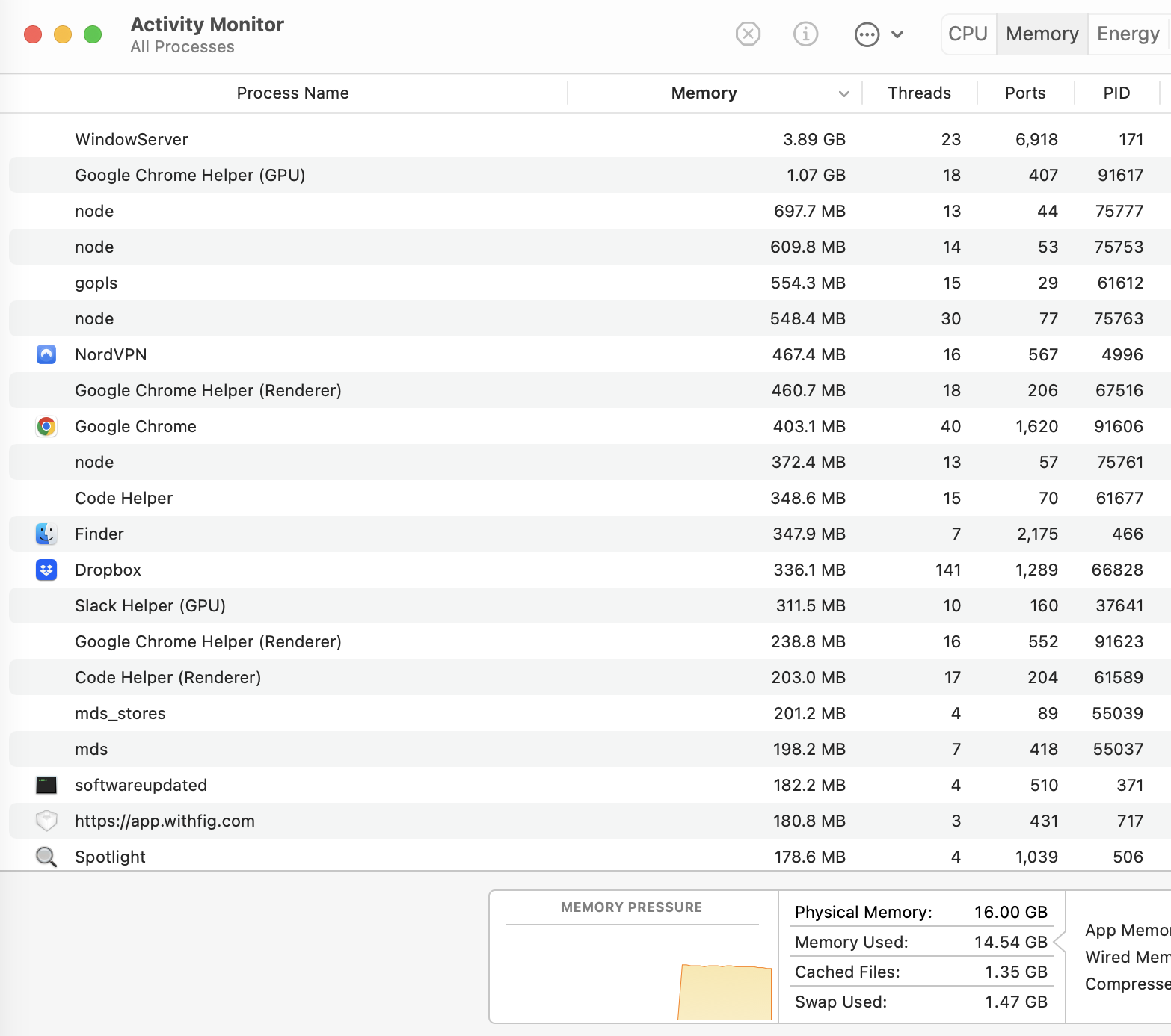

Anyone serious about software development should most definitely upgrade to 32GB of RAM.
For me, I run the following when I write and test code:
  • 2x Typescript watch Node.js services
  • 1-2x React Node.js servers
  • Go server
  • VS Code
  • Chrome tabs + Chrome dev tools
  • Communication channels including Slack, Whatsapp, Discord
  • TablePlus database tool
  • Notion for note-taking
My M1 Pro with 16GB of RAM struggles sometimes with stutters - especially when Typescript does its thing. I noticed that I'm almost always beyond 16GB of RAM usage and swaps are always used.
If you do software development for a living, and you plan to keep the machine for a while, go for 32GB of RAM at minimum.
I planned to wait until M3 before I upgrade but I'm considering upgrading if/when M2 Pro hits and getting a 32GB machine instead.
You don't even need to fire up a couple of VMs so your memory usage could even be lower compared to other developers. I'm using 32GB M1 Max for now and I could still see yellow memory pressure if there are lot of VMs in the background.

You probably have external screens attached also looking at the memory usage of window server? The memory on the M1 is used both for graphics and for programs, the older Intel ones with dedicated graphics cards could fare a bit better in that.

Seeing that pressure in yellow is unsettling.

LMAO. Apparently OP thinks RAM is supposed to sit there unused.
It doesn't matter if your Mac has 8 GB or 128 GB. The Mac will use every bit of available RAM on purpose because it is designed to. That's what it's there for. What's the point of having RAM if the system doesn't use it?
I love when people post this and think it means they barely have enough RAM, when it is literally the system working as its designed.

Just because the system is 'working as intended' doesn't mean the system is working fast. OP's workflow might 'work' on 8GB but it won't be fast enough for someone that cares about reducing as much system stuttering as possible when working.
The memory pressure graph is a hint. OP is clearly not the guy with one tab open on a 32GB machine complaining about not enough memory.

That matters not if the system is slowing down due to too much Swap. At that point your memory pressure is the clear indicator you need more memory. Sticking to 8GB because it's designed to is just plain wrong.

No, that's not what I said. I said it's stuttering and apps are opening slowly.
I actually ran 8GB for a similar setup to this when I only had an M1 Macbook Air. It was quite miserable. I thought 16GB would be enough but it's just barely ok. I always have to think about closing apps to free up more memory.

This. Although used RAM % is not a good indicator (will usually be around 80%), if there's swap then that means you're actually running out.
