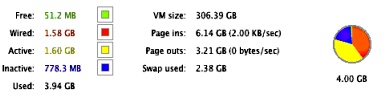

According to memory usage do you think 8GB might be enough?
When was the last time you restarted your computer? However, by simply looking at your screenshot, I would upgrade to 8 GB of memory. You have significant page outs compared to page ins, but you might not necessarily "feel" a difference since your page ins and page outs are cumulative from the last time you restarted. Your wired + active is quite high as a percentage of your total memory and your free (free + inactive) is relatively low.

Do you think 16gb might not be necessary?
According to your screenshot you basically need 9 GB of memory (Page Ins + Page Outs). If the price difference between 8 GB and 16 GB was still huge like it was last year, then I would say don't bother, but since 16 GB is quite cheap now, you might as well. OSX will use the extra available memory quite happily to cache itself, which will speed up your system.
