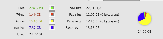

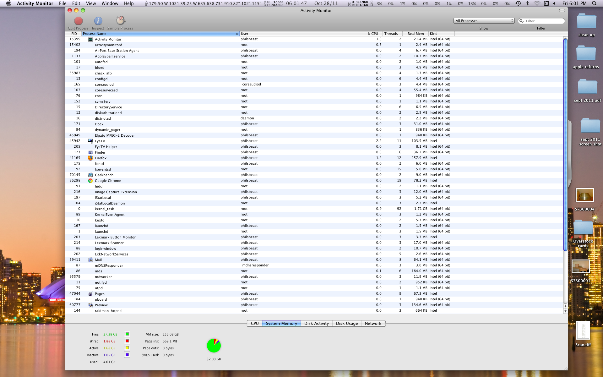

Thanks. How do I look for Page Outs? I have just been going on available RAM.
SEE MY THUMBNAIL
I have 660 mb page ins and 0 page outs. 32gb ram is more then enough for me.

Hmmm...for me, 17GB of pages outs with 24GB of RAM.
