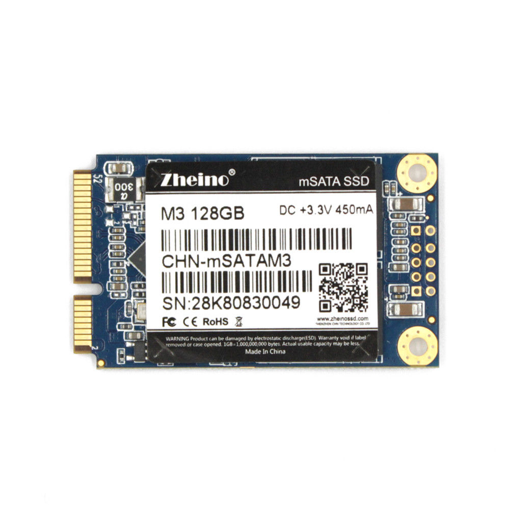

So, my new mSATA SSD arrived today. Yesterday I cloned a copy of the drive to a disk image on my Quad. Used that image to clone back to the new SSD.
It's a Zheino 128GB. You can see it below…
I bought the adapter that @AphoticD uses and everything worked perfect.
I am typing this on it right now after booting from the new drive.

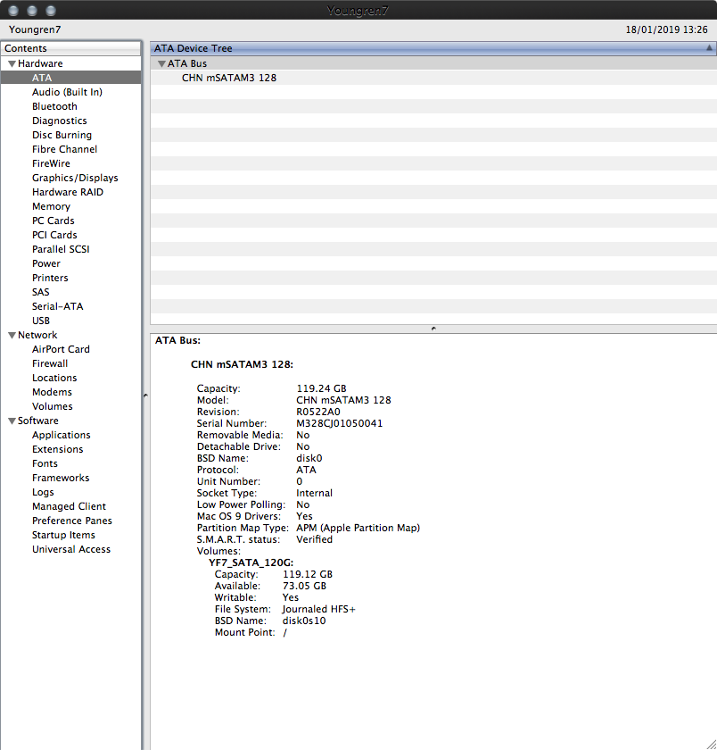

[doublepost=1547843258][/doublepost]Here's what System Profiler says…
I never actually used my Powerbook with a spinner, so I didn't get to compare them. When I bought my first PB to upgrade from my 1GHz iBook G4, I bought an SSD to go in it at the same time. So, although I had a massive speed boost with the upgrade, there were a ton of variables involved in that.

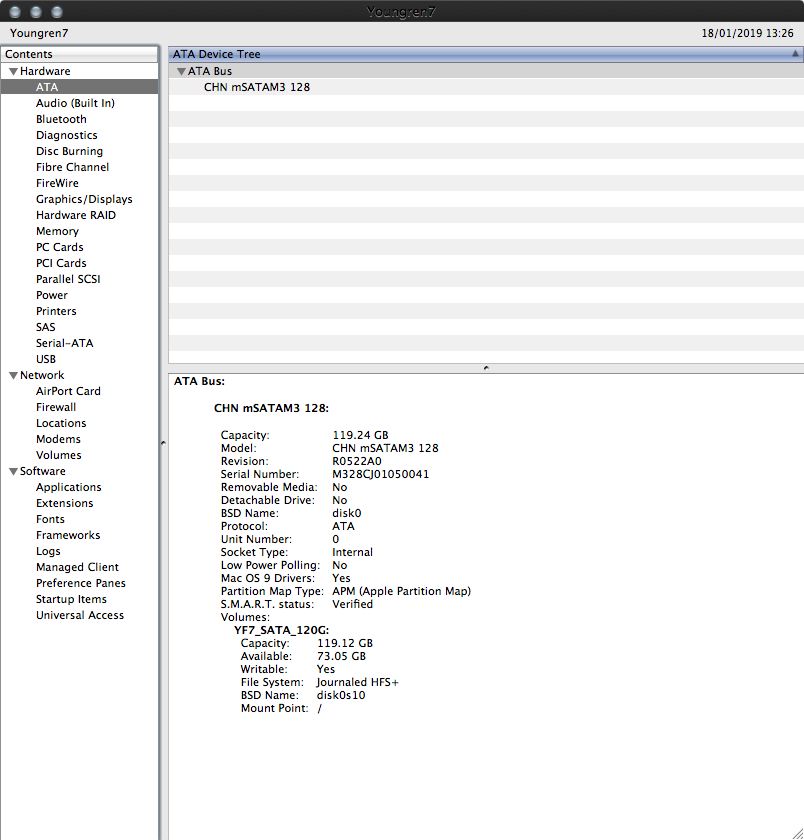

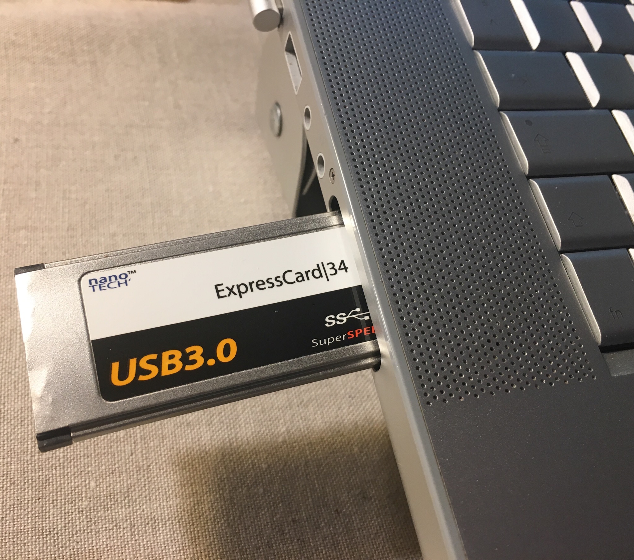

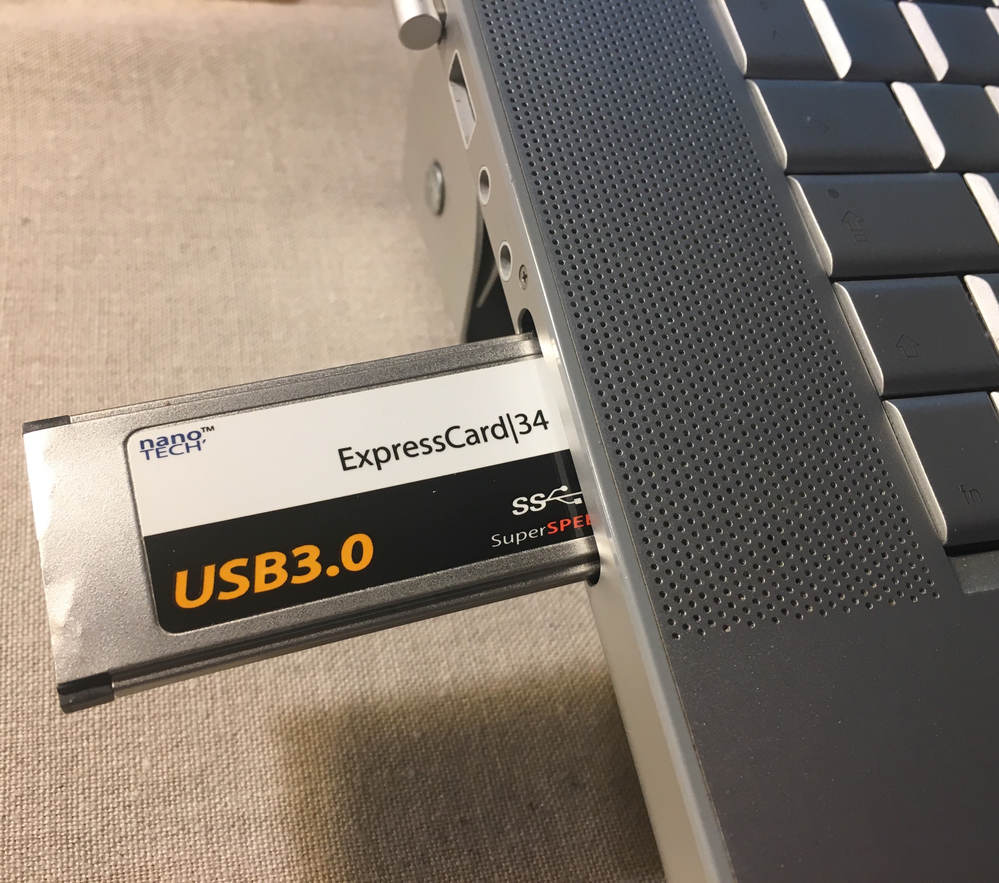

PS: this is another valued add-on of mine for the A1260 lifting the books state of USB-connectivity close to the 2012 models: https://www.ebay.de/itm/2-Port-USB-...432287?hash=item3d17de08df:g:HaQAAOSwubRXFLH3
Pretty expensive, but a great time saver when it comes to backups etc. And it's hot swappable, "one to rule them all" I didn't regret the expense yet ...
