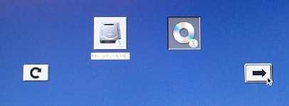

2.) I can hold the Option key down and it brings me to a blue screen with a square on the left that has a refresh signal on it (circle with an arrow) and on the right it shows a box with an arrow pointing right >
(Which I've now found to be this screen
But without any of the boot options.)
Those are the only two screens I can get to show up.
I know that the USB Drives work, so not sure why it won't show the external harddrive or thumb drive. The optical drive should work, so don't know why it won't show a CD. And the Harddrive itself works, so I don't know why it won't boot up. The only thing I can think regarding the harddrive is that there's something wrong with the sata or power connection, but that's not the problem since it won't boot to anything else either.
