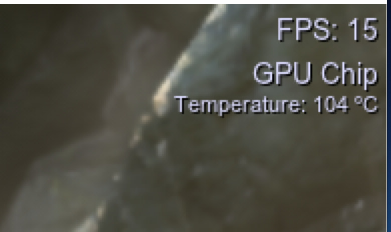

Mine was mostly 102 degrees, after 10 minutes it reached 104. When I quit, the fans were at 2300 rpm. Please share your fan RPM if you have that information (Using iStat)
Thanks
104º/2300rpm
Flickered to 105º once or twice, but for less than half a second so not enough for me to warrant that value. Reached 104º very quickly.

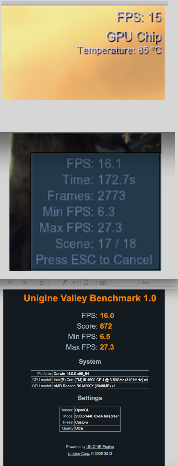

So I did a benchmark starting at a 50C GPU diode, followed by one at starting at 104C.
These are the results below.
Throttling? Not sure - 3.5% drop in performance.
take two (retina 5k, i7 4Ghz, 32gb, 1TSSD, M295X):

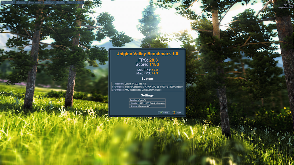

Up the resolution to 2560x1440. You need to click 'run' then edit the settings after it starts.
You are right, this is the correct one:

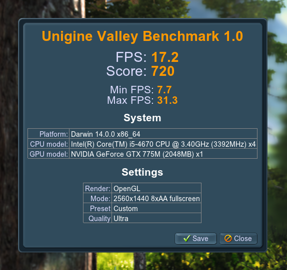

Just out of curiosity I decided to run this benchmark on my 2013 iMac i5 3.4 nVidia 775M with all the same settings you guys suggested.
GPU temp according to the program hovered around 80c (82c max) so the fan never increased from 1200rpm.
That I don't find surprising. What I do find surprising is the results of FPS and score. Shouldn't you guys be in an entirely different ballpark? Did I test something incorrectly?
EDIT : I obviously didnt take part in the poll as I don't have a 5k iMac FYI. Also to point out I've had the GPU get much hotter with games (ESO 95c), so if you guys are seeing throttling with this benchmark I'd imagine you'd certainly see it real world.
