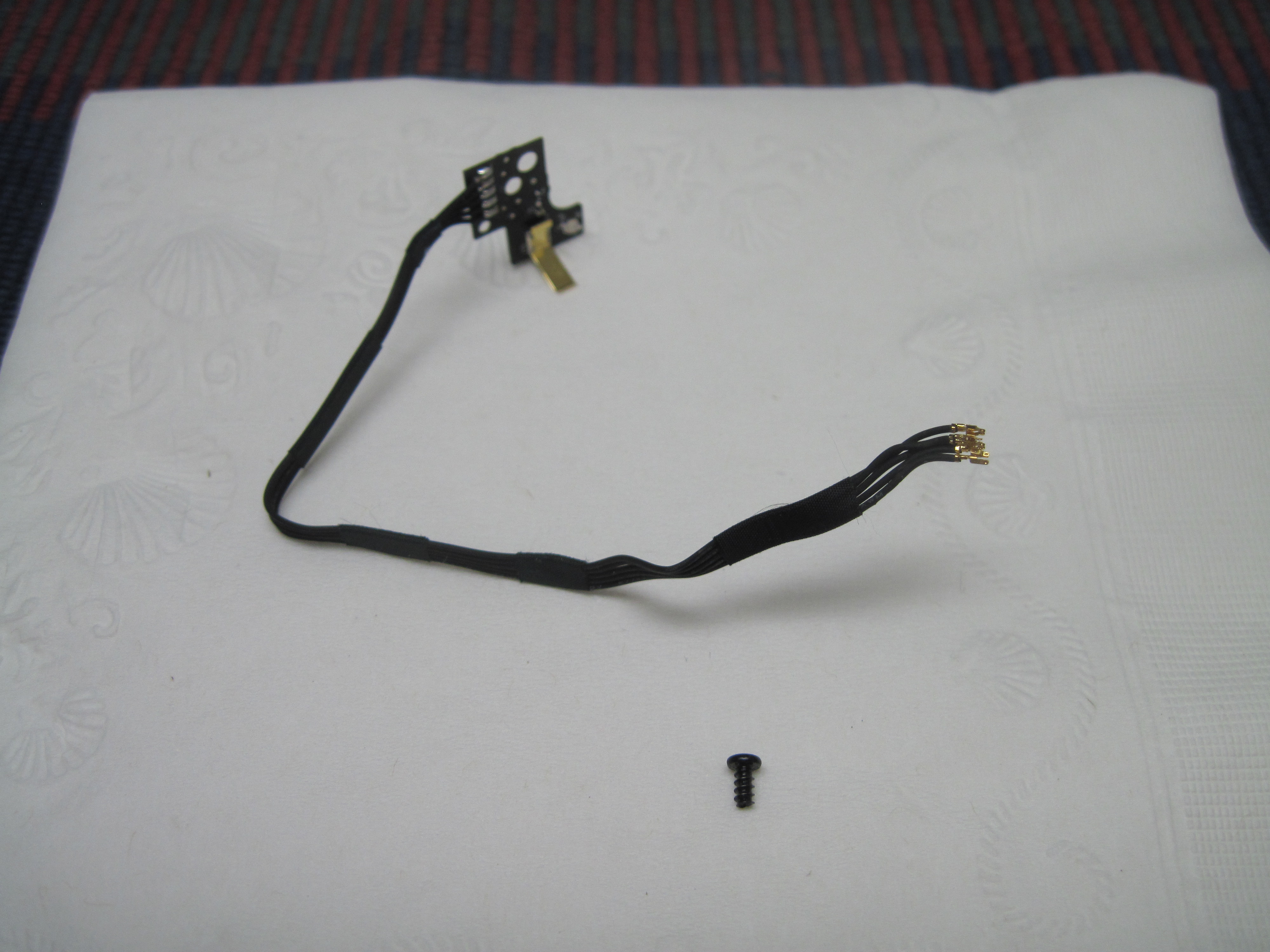

Well A first after a few hundred 2010,2011,2012 teardowns I broke something. I was pulling the mobo out I had detached:
1) the fan
2) the 1tb hdd
3) the grill antenna
4) the power cable mobo- psu
5) the ir cable
I pulled the mobo and no go. All of a sudden it moved 2-3 inches instantly and even though the ir cable was not attached it snagged and pulled the plastic end off. well at least the mobo was not damaged.
I ordered a replacement cable at this site.

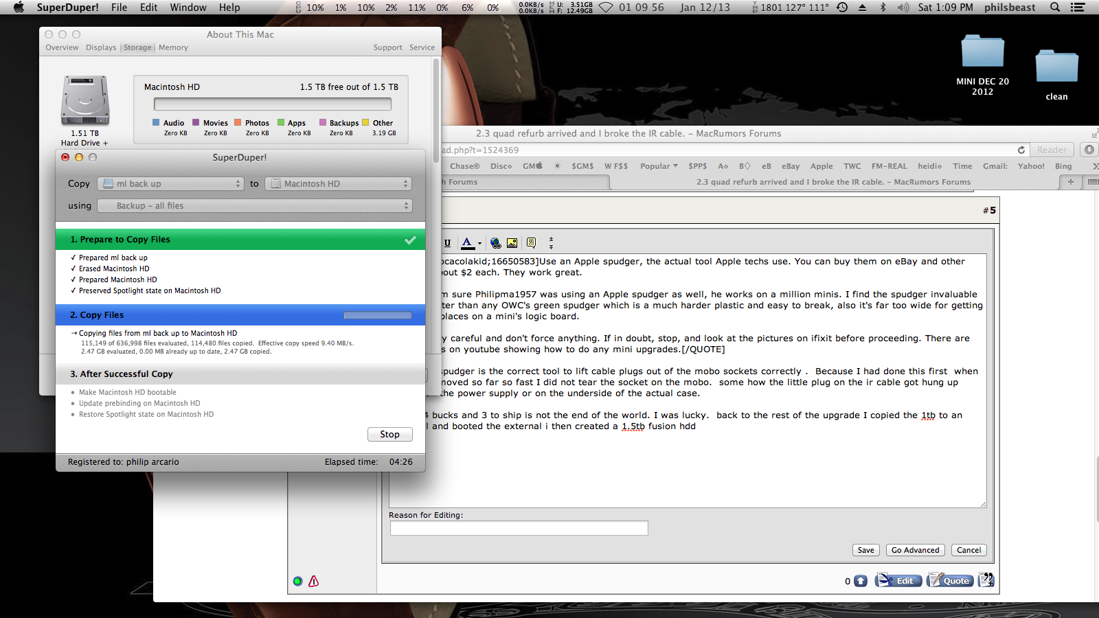

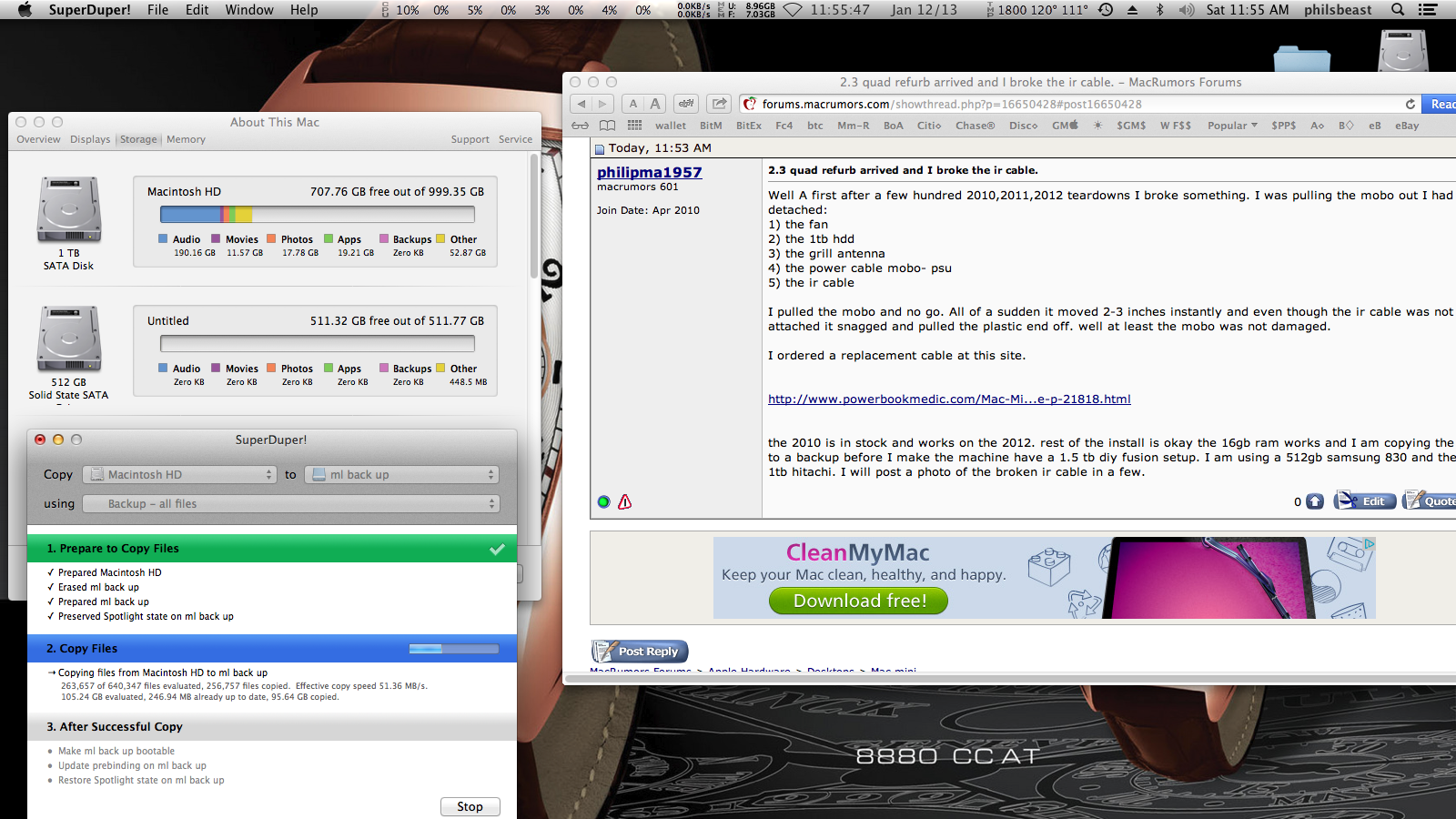

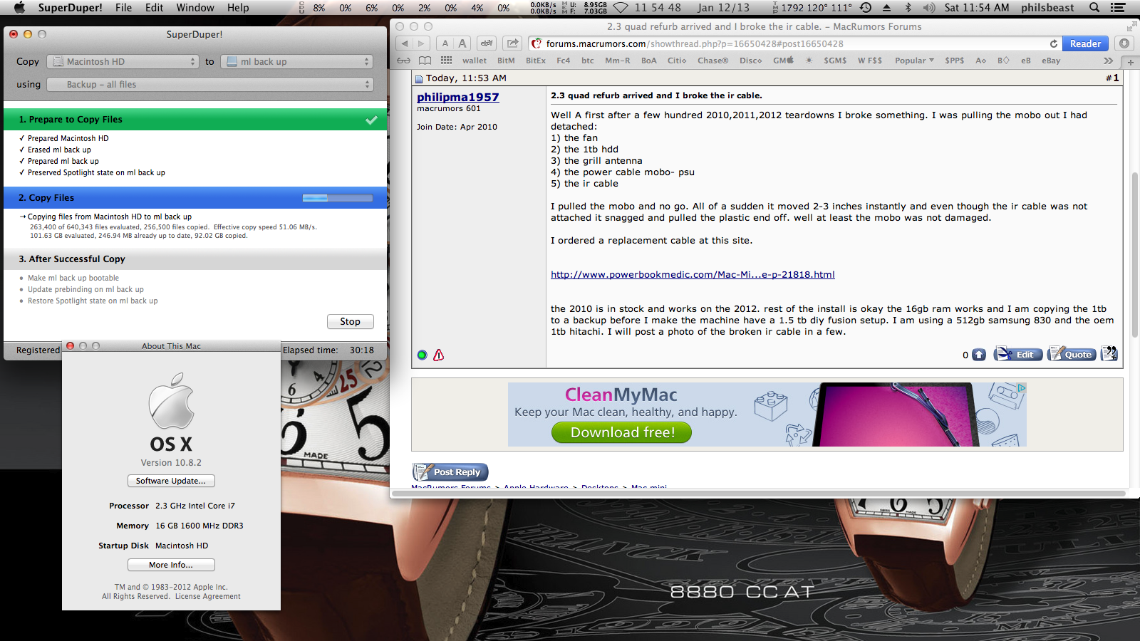

the 2010 is in stock and works on the 2012. rest of the install is okay the 16gb ram works and I am copying the 1tb to a backup before I make the machine have a 1.5 tb diy fusion setup. I am using a 512gb samsung 830 and the oem 1tb hitachi.

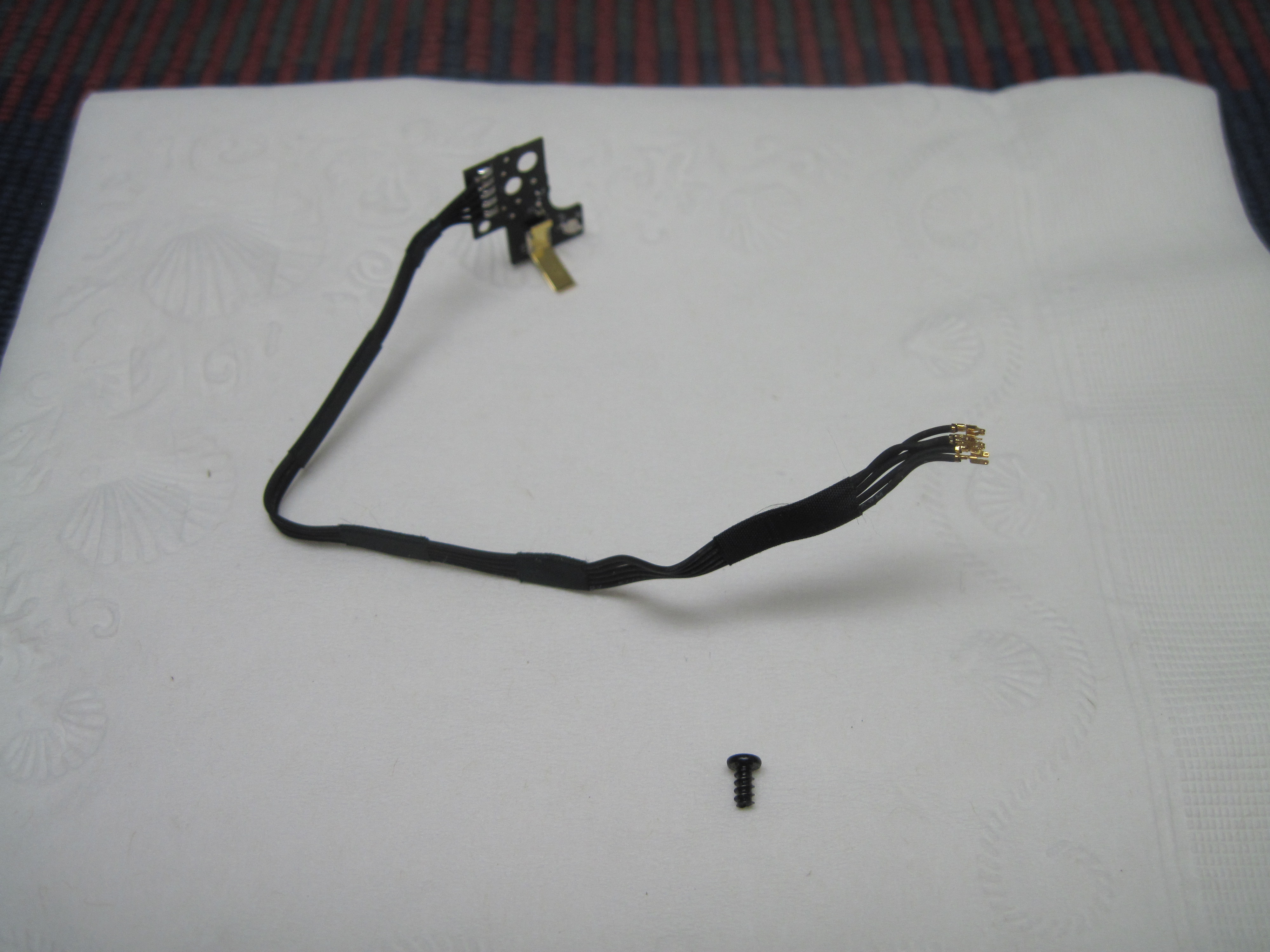

I will post a photo of the broken ir cable in a few. here is the cable attaching screw plus some screen shots.
I may just keep the cable as a spare part. I will use this machine for about 10 months or the new 2013 mini. I may then put the cable in and sell it. I will post a bit on how this works.

yes the spudger is the correct tool to lift cable plugs out of the mobo sockets correctly . Because I had done this first when the mobo moved so far so fast I did not tear the socket on the mobo. some how the little plug on the ir cable got hung up maybe on the power supply or on the underside of the actual case.

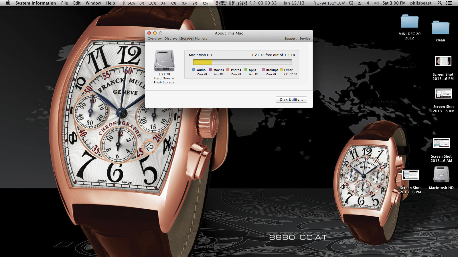

Well 24 bucks and 3 to ship is not the end of the world. I was lucky. back to the rest of the upgrade I copied the 1tb to an external and booted the external i then created a 1.5tb fusion hdd and I am copying the ml back to the fusion. easy peasy . Now I have 1.5tb fusion with 16gb ram and a 2.3 quad. yeah no ir or little power light but the cable is on its way.

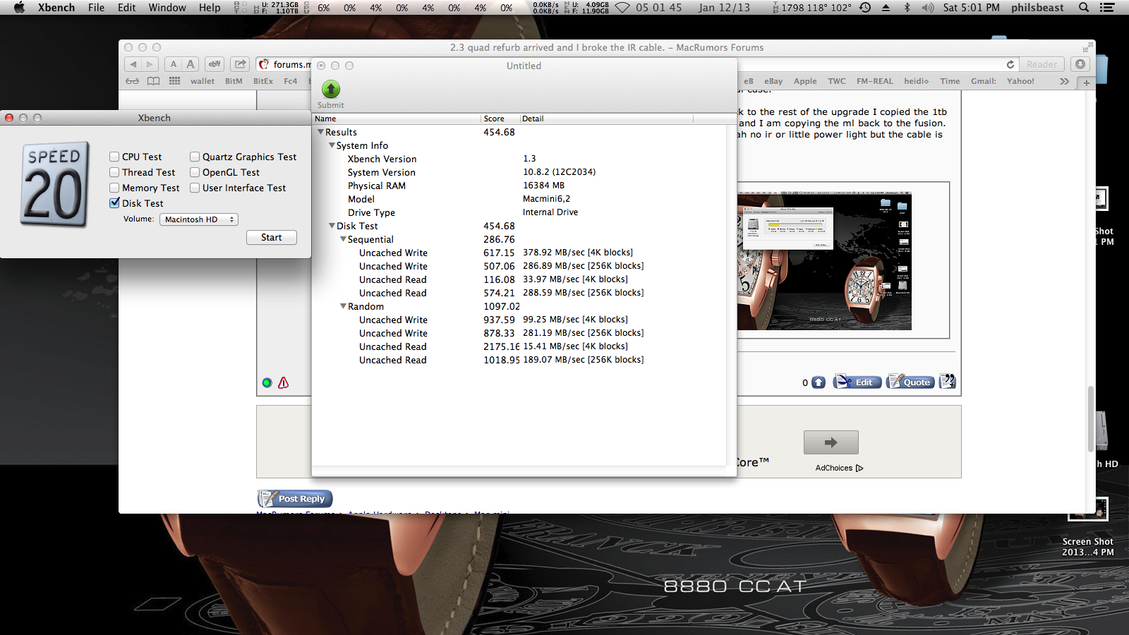

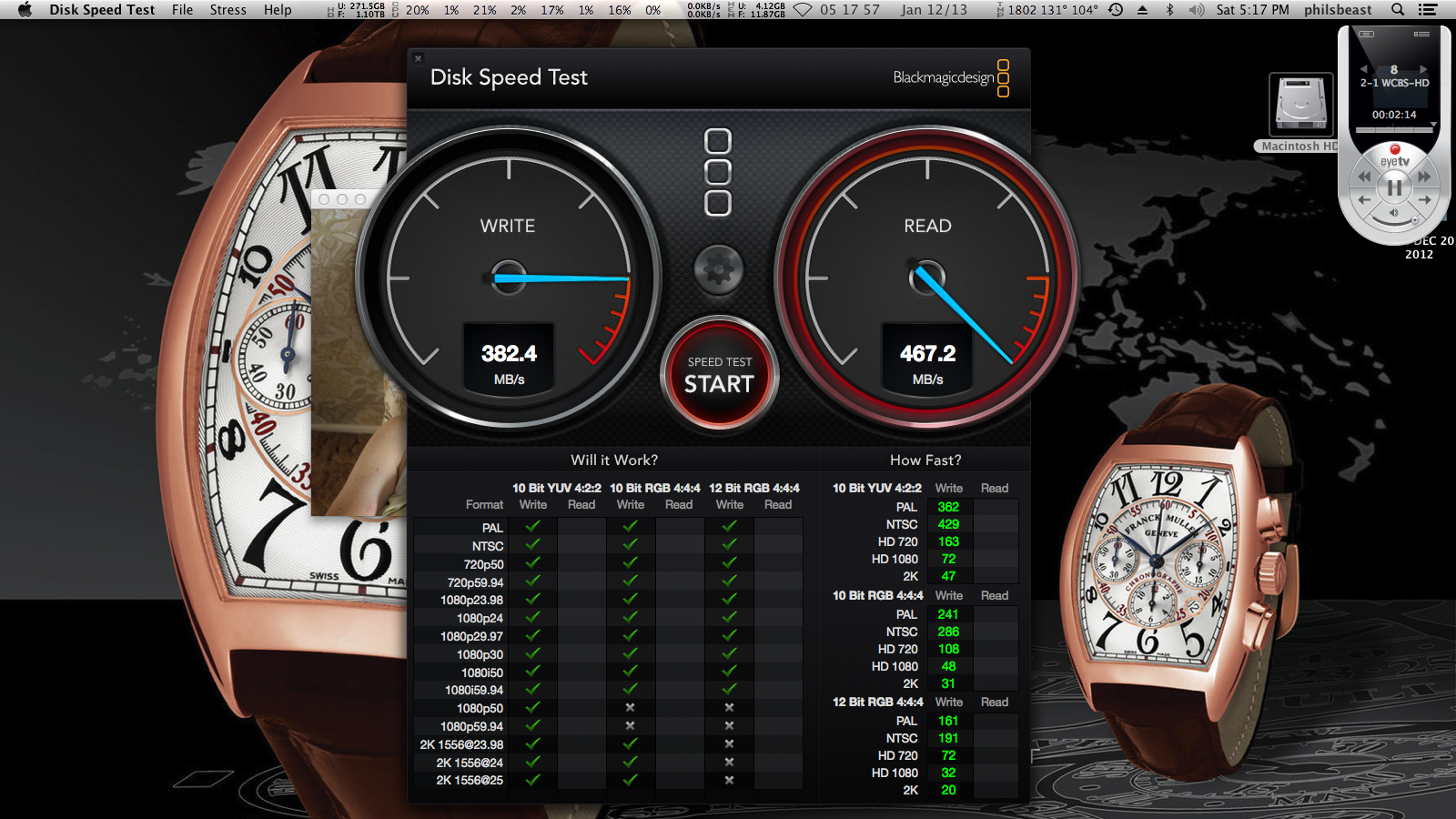

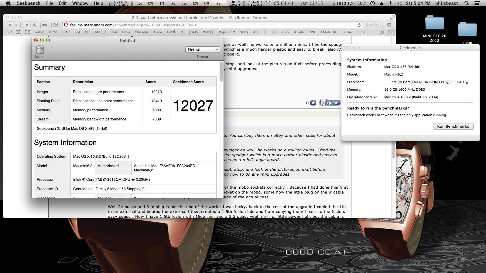

okay I got the fusion working and migrated everything to it. I ran an xbench disk test scores are decent. geek bench scores for 64 bit are more then 12000. If this works well I am going to build a second one in a month. this is a very nice piece of gear.
I ripped the IR cable, too. Shoved the little ends back into their sockets, taped it over, working fine.
I tried that but the small plastic part was too damaged. the part came today and all is well. so my mid mini refurb cost me 679 plus 27 or 706 still lower then 799.
