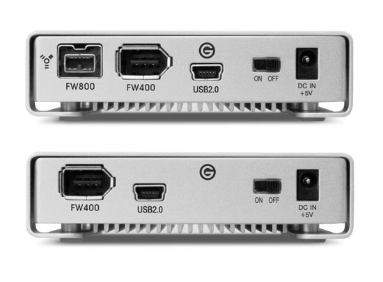

Yes, I'm talking about mechanical hard drives. I'd find it pointless to pay lots of money for a super-fast backup drive that only works in the background. You say I could just as well use USB 2.0 instead of Firewire. The external G-drive already has both USB 2.0 and Firewire (both 400 and 800) so I was thinking backups would take less time compared to USB 2.0). I was thinking of opening up the enclosure and simply replace the 320GB drive with a 1TB drive. That way I could keep using Firewire, but I really don't have any hard evidence on the speed difference.
(photo taken from here).

One thing I would like to add. What I do for a while now is avoid powered (external power supply) external drives. I know you want an internal drive, I am just adding this bit of info. The external power supply is just another thing that can and most likely go wrong/fail, more than the drive itself. Also extra cable and extra size etc. The last powered ext drive I bought was an 8TB one last year and I don't plan on getting more ever since I started buying 5TB 2.5 drives that require just the USB cable to transfer data and power the drive.
But most 2.5" laptop external drives don't need an external power supply as far as I know (we've been using that G-drive for years without any issues, connected just via a Firewire cable to the iMac).
I personally hate those power "bricks" with all the additional cabling and fuss. I didn't think about the reliability issue of an external power supply, but you're absolutely right. A good reason to avoid them.
I will of course have to open up the G-drive enclosure to see what's inside (no big deal, just a couple of screws) before buying anything. Good point about checking for SATA I, II and III and of course the RPM speed. I hadn't heard about hardware heaven, so I'll check out that as well.

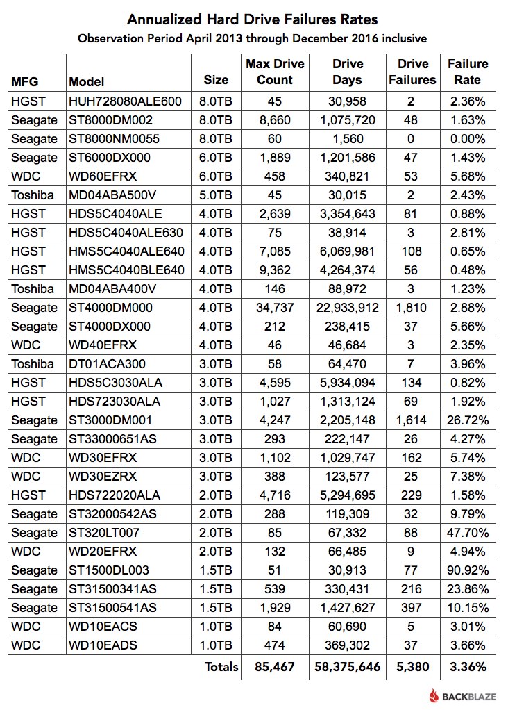

For selecting drives you might want to check the latest Backblaze failure rate report:
https://www.backblaze.com/blog/hard-drive-failure-stats-q2-2017/
There are numerous discussions about whether this data suggests possible failure rates in a home environment, but it is the only large scale disk failure analysis that I know.

For backup, I will just go for the cheapest, and make sure have more than 1 backup.
Brand doesn't really that matter. The failure rate is more about a particular model, not brand. (Even though the following table is for 3.5" HDD, but 2.5" is more or less the same story).
And HGST is actually WD now. If anyone want to avoid WD, should avoid HGST as well. Anyway, I have multiple WD Red and Black HDDs, none of them failed so far. I quite like the Red series actually. I also own few Seagate HDD and SSHD, only one of the SSHD failed, but that particular one was dropped onto the ground by my wife, and then failed (read error) about 6 months later. So, it's hard to tell if it's Seagate's fault, or my wife's fault.
