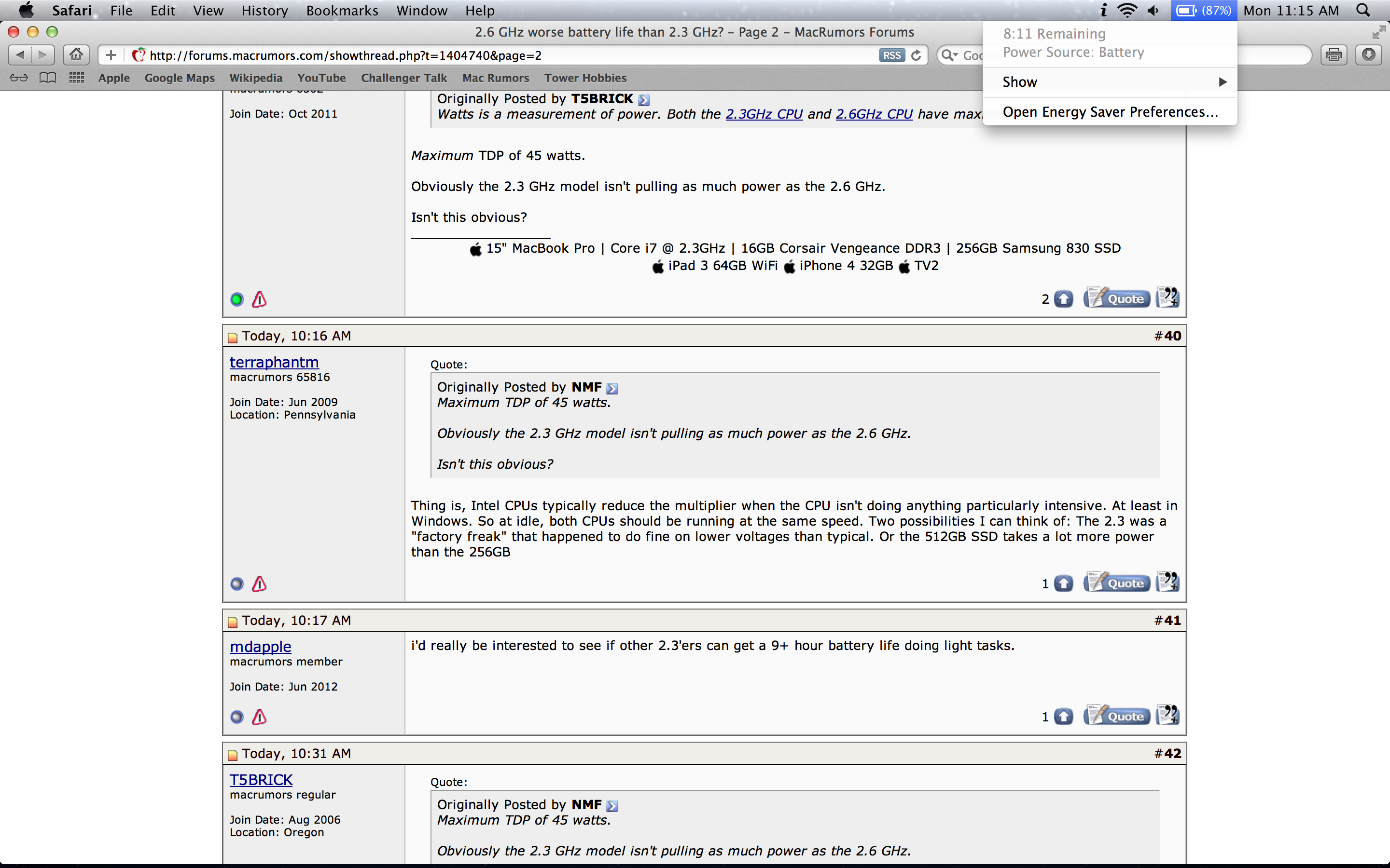

i'd really be interested to see if other 2.3'ers can get a 9+ hour battery life doing light tasks.
Surfing Macrumors, its possible. My brightness was set 6 notches from maximum.
