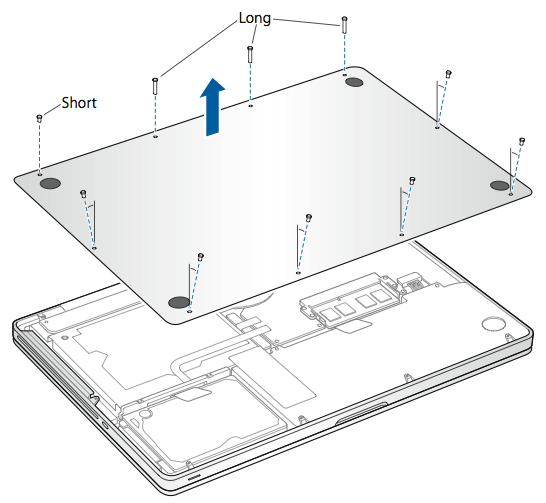

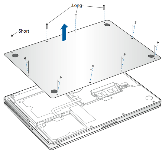

At this point, I would consider "swapping" the SSD for the internal drive. On most MPB's this is a VERY easy task, SO LONG AS YOU HAVE THE RIGHT TOOLS (shouting intentional).
You can find a well-illustrated guide at ifixit.com.
You'll need a small screwdriver (probably a Philips #00) and a TORX driver (T-6?).
These can be found at hardware stores, Home Depot, Lowe's, etc. "for cheap".
The hardest part about swapping drives is removing the screws on the back and reinstalling them. Watch out for the "longer" screws, that they go back where they came from.
NOW -- with the drives changed out, will the Macbook boot up from the SSD?
If it does, you're back in business (insofar as a running MBP is concerned), even though you still have to try to "get at" the data on the old drive.
Put the old drive into the USB3 dock and connect it.
What happens now?
Do all this, and get back to us...
I have purchased the external drive and an SSD from Amazon. When they arrive in two days, I will move forward in hopes of getting up and running.
The screw diagram for the bottom panel is attached for a 13" classic MacBook Pro. The screws are a standard Philips #00 screwdriver.
Excellent diagram by altemose above.
You'll need the TORX driver to access the screws on the hard drive itself, and transfer those to the new SSD.
Ifixit's instructions talk about removing the battery cable, but I left it in place and had no problems.
Do this job on the dining room table (or other clear flat workspace), and put a towel over it so you won't scratch the top of the MacBook.
The drive is held in the slot by a small bracket. You just unscrew the bracket and lift the drive out with the "pull tab". Swap the mounting bosses on existing drive (TORX screws) to the new one, drop the drive back in, put the bracket back on, and replace the back cover. Again, hardest part is removing and replacing the back screws.
