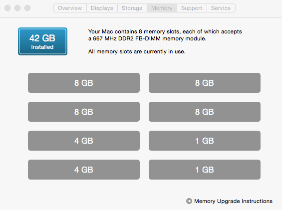

RAM must be installed in pairs. There is a diagram on the inside of the removable side-panel, or take a look at the Apple web site.
There has been a lot of chatter about RAM and Mac Pro 1.1
I just installed another 16G which is currently available on ebay as cheap as sand.
go get some, although used and its from "China"
search key as follows many different manufacturers hynix micron etc :
Micron 16GB 2X 8GB 2RX4 PC2-5300F DDR2 667MHZ ECC Fully Buffered FB-DIMM Memory
Reactions: raymanster

I had a severe problem with an update (may be due to having User Home Folder split up on two different disks). So my system was gone after the update. After a new installation of 10.11.6 I experience some strange behavior. Start up an shut down work fine, but when I try to restart, the screen goes black and the computer seems to be locked in a kind of loop. Fans go on and off, no start up chime is played and the the Mac Pro seems to rest in this state forever. It can only be shut down by holding the power button from there. I tried to reset NVRAM and SMC, I even replaced the battery (well for the first time on this old machine) but the problem persists.
Any suggestions?
My system is a Mac Pro 1,1, updated to 2,1 with 2 x 2.66 GHz Quad-Core Intel Xeon and 32 GB Ram, ATI Radeon HD 5770.
Are you sure your HD is OK? Just wondering if it could be a failing drive. It would be pretty easy to try a different HD or even better an SSD. Have you tried booting from an earlier OS (perhaps Snow Leopard) to check it functions OK.
Reseating the RAM / checking that all RAM is being seen by the Mac and that no lights are on on the riser boards, would be worth checking too.
Problem solved.
HDD and SSD were OK and the problem persisted no matter which OS I booted from. I later realized, that RAM was not always recognized and showing different numbers (never had that before). So rearranging some RAM bricks (even if all are the same size and manufacturer) solved the problem.
Good to know it is sorted. Strangely, after running fine for ages I recently had a problem with a pair of RAM modules not being recognised but it didn't seem to cause any obvious issues. I reseated and moved around the modules and they all worked for a while but in the end I had to swap out a couple of sticks.
