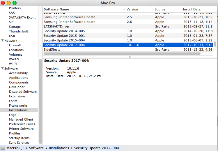

Just finished updating my MacPro1,1 running El Capitan with the latest Security update from the App store.
Installed without any issues and system appears to be running just fine.

I'm guessing you mean Security Update 2017-004? I just saw it in my App Store updates for the first time today and your post is two days old so I just want to make sure you don't mean Security Update 2017-003 which I think was the last one. Thanks.
Yes Security Update 2017-004, installed the day it was released, Oct 31.
