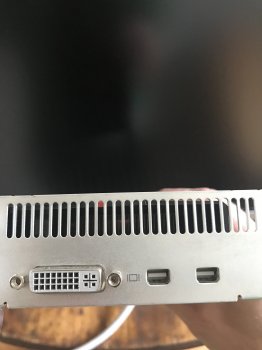

I am hoping for the just in case to work. Awaiting a new gpu: ati radeon 5770 to arrive, I bought one that is apple compatible so hoping it works out of the box.

I did remove all the 1G RAM
El Capitan loads. I am able to enter password but now it keeps freezing and locks up.
I did manage to look at the Memory and it confirmed 16G RAM.
Not sure if the gpu -- I do have a new one arriving on Saturday to switch out the ati radeon 1900 512 that is in there now.

Is that the original X1900? If so that is the issue as they don't work with El Cap and are crap anyway - I replaced mine as it was causing sleep/wake issues under Snow Leopard but missed out on Apple's recall.
Not the original gpu.
I still have the original but it flickers horribly.
I had this flash ati radeon x1900 on ebay back in 2009 or 2010 as it was suggested back then. I never knew about a recall, Hummm. I have always come to MacRumors and lurk -- reading and learning when I had the time. It appears I will need to make the time to keep up.
I know the gpu is failing as it was giving me issues in Lion with flickering and weird activity on the monitor.
In Lion often suddenly the system would not respond -- perhaps it went to sleep and I could not get it to respond.
Its why I went looking for a new gpu and choose the 5770 based on recommendation read on this forum.

[doublepost=1530501722][/doublepost]Jus wanted to report I managed to change out the graphics card and it loaded without issues.
In the process now of loading up all my apps.
I do notice the wifi single be to spotty at times -- so plan to directly plug in.

You do have the extra power lead connected to the 5770, I assume. I had the Mac version running a 30" cinema display for a long time without issue.
Thank you for responding! My 5770 only has one power connection from what I see.
[doublepost=1530634122][/doublepost]
Try moving the cable to the other connector on the gfx card...
Thank you for responding ! I feel like I tried every cable combo, which were you referring to ?
The DVI cable from the monitor to the card. 5770s generally have 2x DVI sockets (plus one other). Try the other DVI socket...
I have only one
