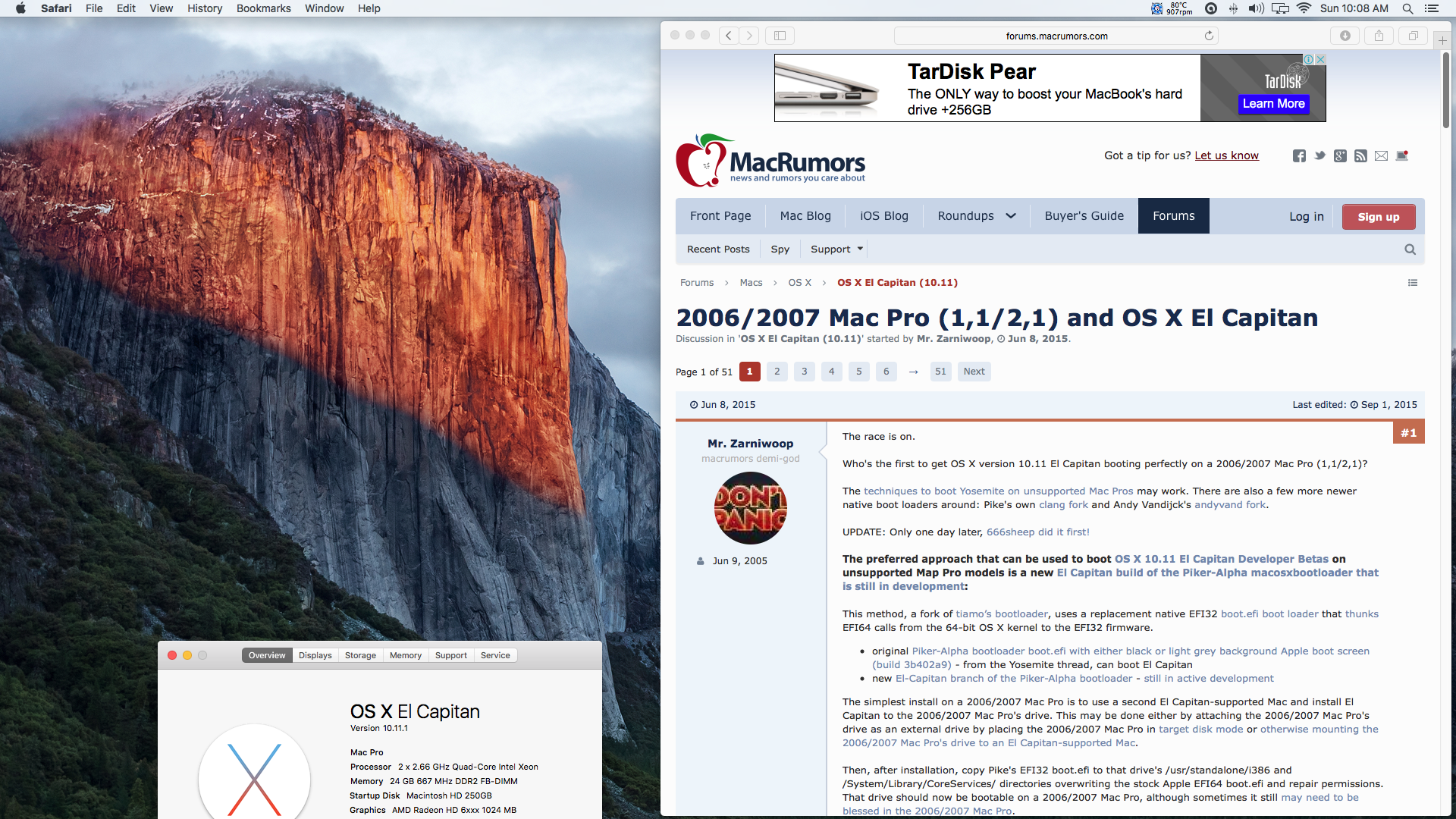

I am a long time guest and have finally signed up. I felt so compelled to do so due to this fantastic thread. I have a Mac Pro 1,1(flashed to 2,1). I have done the usual things with this Mac Pro, upgraded the CPU's to 2 quad core 2.66 and have 24gb of Ram, Radeon HD6870 and an SSD.
I had tried other methods of installing Yosemite with SFOTT and Chameleon with success. But using Pike-Alpha's boot efi and installing from a El-Capitan Mac book air has been the simplest and best method so far. A huge thank you to Pike-Alpha and Tiamo for all their efforts and all of the forum members here. My 2006 Macpro lives on when I was about to give it up for something newer. I have no other need to go to a new machine other then having work around the issues of the new OS's.
So thank you all.
Techchallenged1

One question I have is if I want to show the correct card identifier in about this mac do I need to flash the HD6870 card? I know I have to do that for the boot screen but was not sure about the identifier.
Regards
Tech
