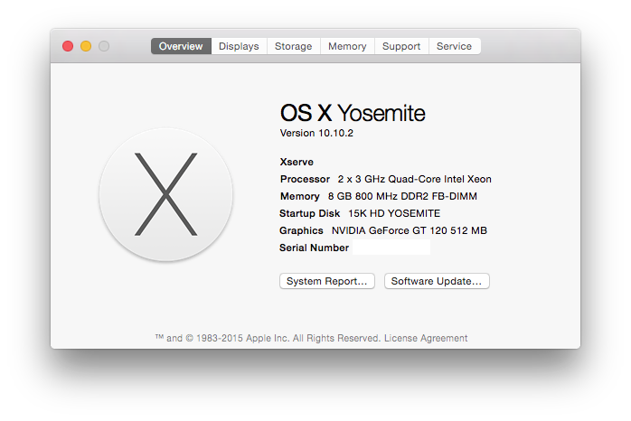

1. Installed Yosemite on the drive
2. Edited the PlatformSupport.plist in /System/Library/CoreServices/ and added the board-ID of the Xserve early 2008 2,1 (Mac-F42289C8)
3. Saved the file
4. Repaired permissions
5. Connected the drive to the xserve and booted
6. Running Yosemite now
7. Rebooted
8. It starts with Yosemite
9. Party time
Now the only thing is to get a new graphics card.
Which one do you recommend? And should i take out the X1300?
Update :
OK i just installed the 10.10.2 update and changed the PlatformSupport.plist
Everything is running!
@MacVidCards do you have the GT120 which is ok to use in my system, i will need two of them because i want to update the other 2008 xserve too. And do you ship to the Netherlands?
Thank you all! Got my Xserve 2,1 on Yosemite
I had install it on a supported mac to Xserve HD (Target mode), now my question is… Can i change PlatformSupport.plist on the Yosemite installer? Do i have to change Distribution file also?
Glad it worked.
You don't need to change it on the installer just install as you did and change the PlatformSupport.plist afterwards, i know it is a bit more work but when you install an update of yosemite you have to change that file anyway if it is changed.
