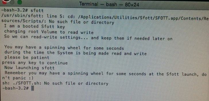

Firstly, thanks to everyone involved in this project, and thanks to anyone who takes the time to reply to this post. My issue is as follows:
My home-made fusion drive will not boot.
I installed Yosemite using an SFOTT key, over the top of a previously perfectly working mavericks installation.
I have even tried a fresh install of Yosemite onto my fusion drive, then, before first boot,booting up to a different partition and installing PIKEYOSEFIX to my fusion drive using the installer.
Additionally, when boot with my SFOTT key, to try to update the the boot EFI (is that correct?) and launch the terminal it tells me that there is no such file or directory (Please see attached image)
The key itself has worked before . I have used it successfully to install Yosemite on one drive in my Mac Pro 1.1. but that drive is so slow I want to get my fusion drive back up and running. IT was working perfectly with Mavericks.
THANKS IN ADVANCE
THANKS IN ADVANCE

In order to get the Fusion Drive in my 1,1 up and running, I needed to install on a single drive and then use a utility such as CCC or SuperDuper! to clone the install onto the Fusion Drive. If you have the means, you might give that a shot.
I might try that thanks, foolishly, I did not make a clone of my working Mavericks system so my backups are bit of a mess. But I might have to do that later, thanks.
I am really hoping for a less drastic solution however!
I have done as you suggested, seems to work, now to sort out my mess of files all over the place thanks again
