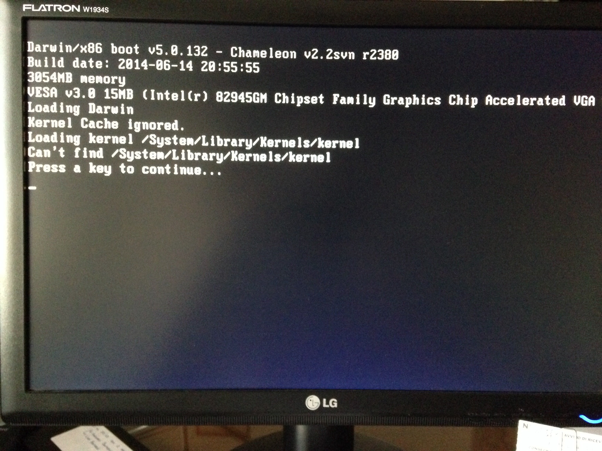

As i told some days ago, and as you souggested i'm trying to install Yosemite on my Macmini 2,1 using your guide and installing everything on main hard disk.
I proceeded like this: i created 3 more partitions: Boot, Installer and Yosemite;
I created the Yosemite installer partition as described in your guide;
Then i used the Chameleon Installer to install it in the Boot partition (i make the "standard" installation");
Then i copyed the "Extra" folder to the root of the Boot partition and modifyed the SMBios.plist: here i replaced the Serialn number, but event the Computer Model and Board Id... with the one of my macmini... (i don't know if i should replace only the serial number... but i though mine isn't a Mac Pro... So!);
Then i copyed the "Kernels" folder fron the downloaded files in the /System/library folder on the installer Partition;
I opened Terminal and give the sudo bless... command
Then i rebooted...
Once rebooted the display was black, and it starts like if it was a PC...
I noticed he tell that there wasn't a Kernel...
Anyway it went go and i could select to boot with Installer partitions but after this it stops as you can see in the image...
So where am i wrong?
Thanks :)

Thanks for the effort as usual. I am getting a /System/Library/Kernels/kernel not found error. Any thoughts?
Even with:
<key>Kernel</key>
<string>/System/Library/Kernels/kernel</string>
...present in your "org.chameleon.Boot.plist" ?
You put the "Kernels" folder from the download in my guide in the "System/Library/" folder on the installer partition?

My guide is for a Mac Pro with an updated graphics card. I'm sorry but I can't really support you because I have no way of testing your configuration. It could be that the DSDT.aml file is incompatible or could be other driver/kext issues that are part of Yosemite.

Sa you can see in the image I'm having your same problem...
Any idea?
I used Chameleon r2380...
@ HENNESSY : thank you anyway :)
Anyway any suggest would be welcome even if you can't test it ;)

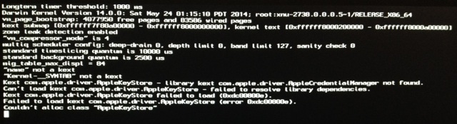

Hello guys,
I'm running 10.9.3 on my upgraded Mac Pro 1.1 (to 2.1) with Ati HD 5770 Mac version.
Any idea what this error might means on my try to install Yosemite DP1 with the Hennesie2000's guide?
Thanks in advance,
VAG
Hello guys,
Thanks in advance,
VAG
Do you know what com.apple.driver.AppleKeyStore is? Seems to be the issue. Maybe its been edited or not signed right?
I tried searching online and it seems to be related to kernel cache which I think has to be ignored to boot 10.10 until the compression type is changed to lzss
It has caused trouble for people trying to enable TRIM on 10.10 then get fail to boot because some kext has been edited
I found it easiest to install onto my drive via a supported mac then just boot straight from a known working copy. I know its not easy but I had a spare 2.5" hd I could use with an external case to install to to try out 10.10 and for now I'm just leaving it alone. First time since 10.4 DPs I'm leaving this to my secondary Mac because its not ready yet

If you put the kernels folder in the right location on the installer partition then it would be able to find the kernel. The installer doesn't seem have the kernel which is why it must be added. Once Yosemite is installed that is the location of the kernel on that partition.
Hello guys,
Thanks in advance,
VAG
Try booting with GraphicsEnabler = No. If that works then try using the DSDT.aml file posted on page 11, not the one in the first post. Gpatpandp was also having issues with the Mac HD5770.
OK. I am fully functional. iMessages and FaceTime work fine. I had to set GraphicsEnabler to No. I am not using the new dsdt.aml file.
I have a MacPro 1,1 (2,1) and an HD5770.
Tried but it's the same result...
Nothing to do with TRIM, I've disabled it and nothing happens.
Memory error. Had to turn off the GraphicsEnabler.
I have the same Graphics Card...genuine Apple ATI Radeon HD 5770...the new dsdt should work perfectly. Set Graphics Enabler = No or simply omit the key entry all together and you won't experience the memory allocation error.
Ahh, I instructed him wrong. The DSDT handles the graphics acceleration fixes.
Will do. Right now I have the Enabler off and the dsdt turned off also. The system is very stable. I will enable the new dsdt and give it a reboot.
Thx.......
