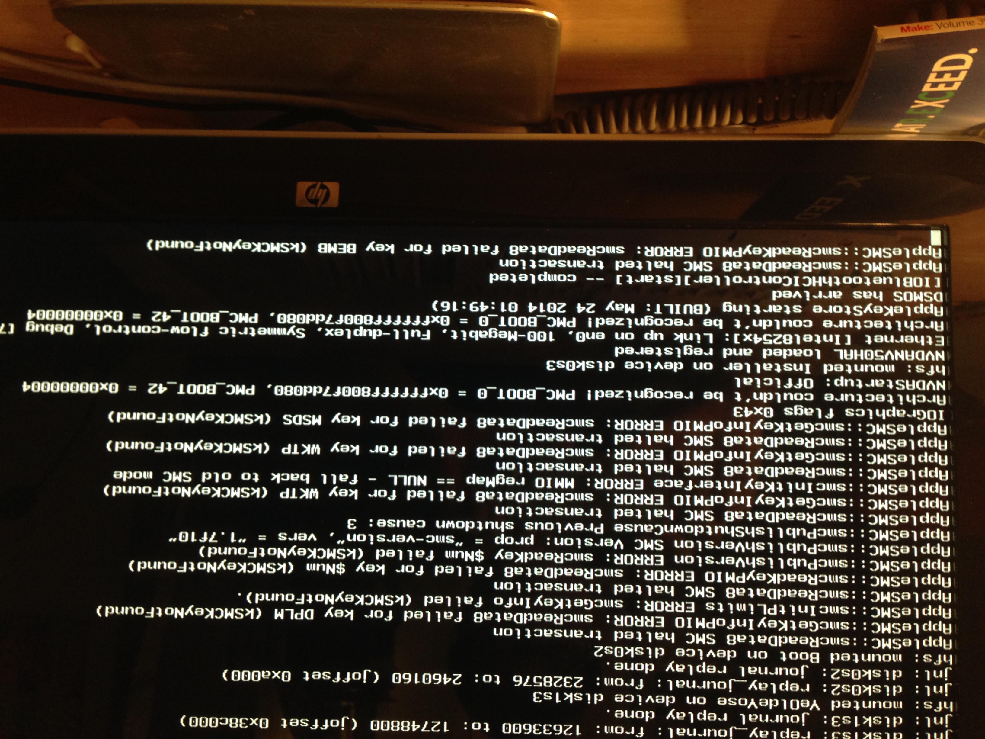

Hmm, trying the new Chameleon method from the PDF. I get this odd error then my machine restarts:
