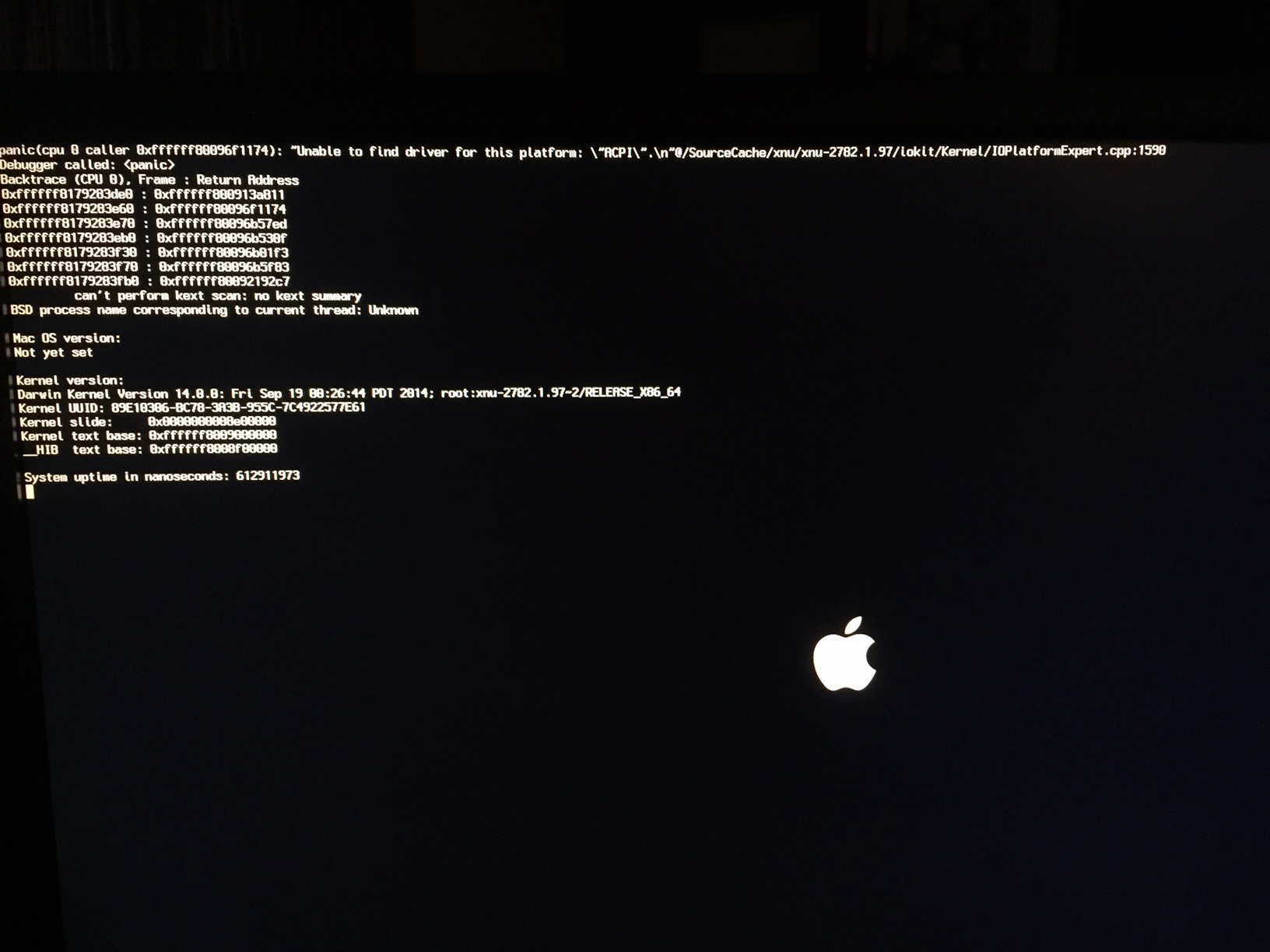

Hey Guys,
I followed Hennesie2000's guide for Yosemite install but upon boot, with the black apple logo up, i received the following error: (see screenshot as well)
"unable to find driver for this platform: \"ACPI\",\n"@/SourceCache/xnu/xnu-2782.1.97/iokit/Kernel/IOPlatformExpert.cpp:1590
....... etc
I have a Mac Pro 2,1 with a NVIDIA 8800 GT successfully running a patched Mavericks install. Please help with any ideas of what is needed to get by this error.
