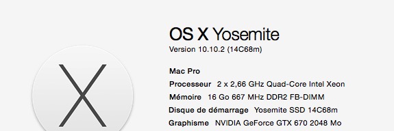

Hi,
Installed 10.10.2 14C68m update using Tobyg's script modified by Hennessie as per post #1584

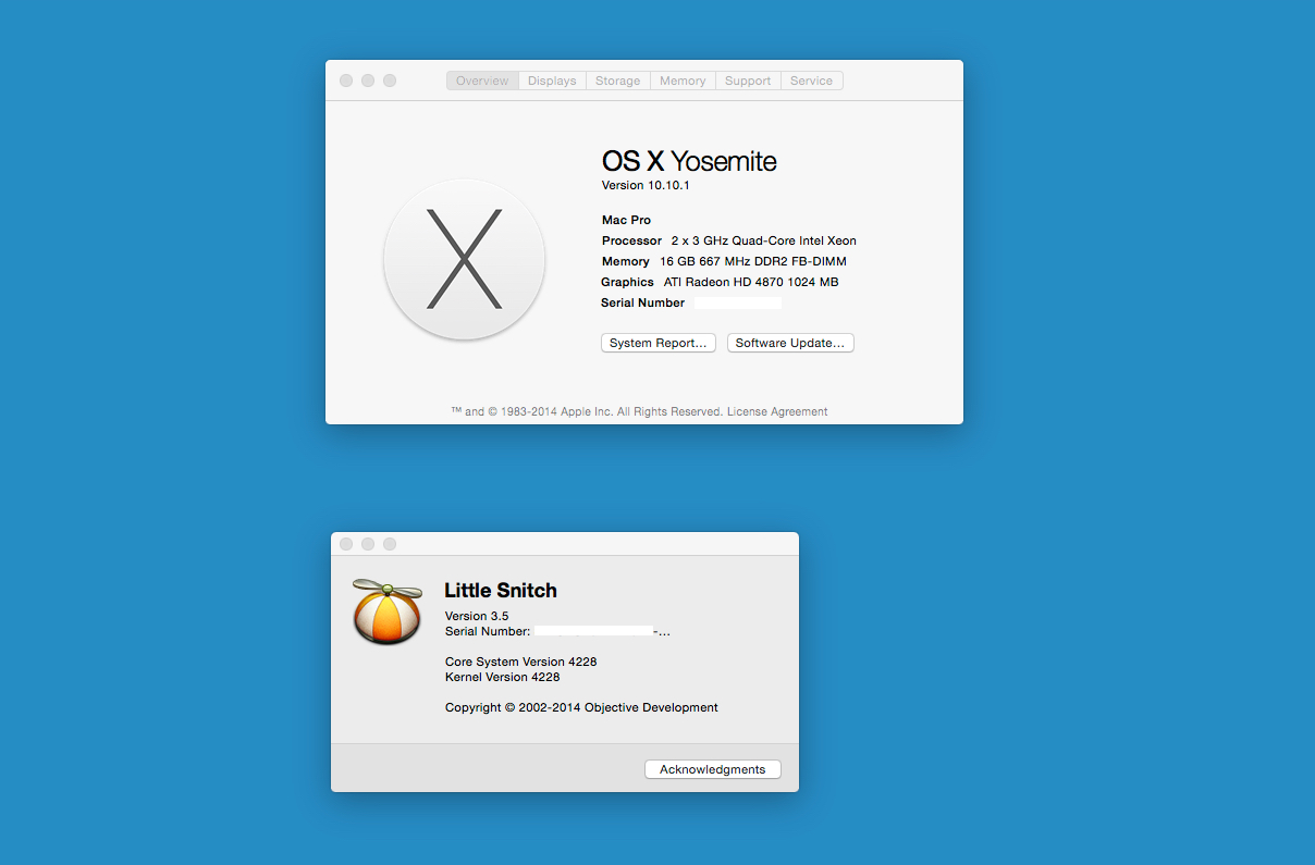

Holly molly...well indeed it does work. Though most definitely the proverbial "nature of the beast" when dealing within a hack realm, gotta hate when others report a certain procedure occurring while experiencing no issues or problems whatsoever while your the unlucky schmuck that simply has tried everything and yet still it will not for you. For all those that are unfortunately falling into the later part of this category, I feel your pain.
At any rate, I grunted it out and finally these additional things worked for me:
Firstly, I wasn't about to screw up a perfectly fine boot drive just because it initially would only work with Little Snitch v3.4.2 and not v3.5 so I worked entirely from a clone backup and ONLY when everything worked as it should did I restore to my main OS X 10.10.1 boot drive.
On the clone and while backing up my Little Snitch v3.4.2 rules/preferences, I COMPLETELY removed my v3.4.2 install and after booting up initially in safe mode, performed a clean install of v3.5.
Upon rebooting in safe mode again, I actually downloaded and used Onyx v2.9 instead of the apps that I already had installed that I thought did the same thing and as suggested, used Onyx this time to perform the System Cache cleaning.
AND finally...and this perhaps is the most crucial aspect, before you begin anything, go to the very first post/page written by "Mr. Zarniwoop" and download the most recent/latest Pike Alpha boot.efi build (I choose the white background/grey apple) and make sure you are booting with it.
Hope those struggling find this to be helpful.
