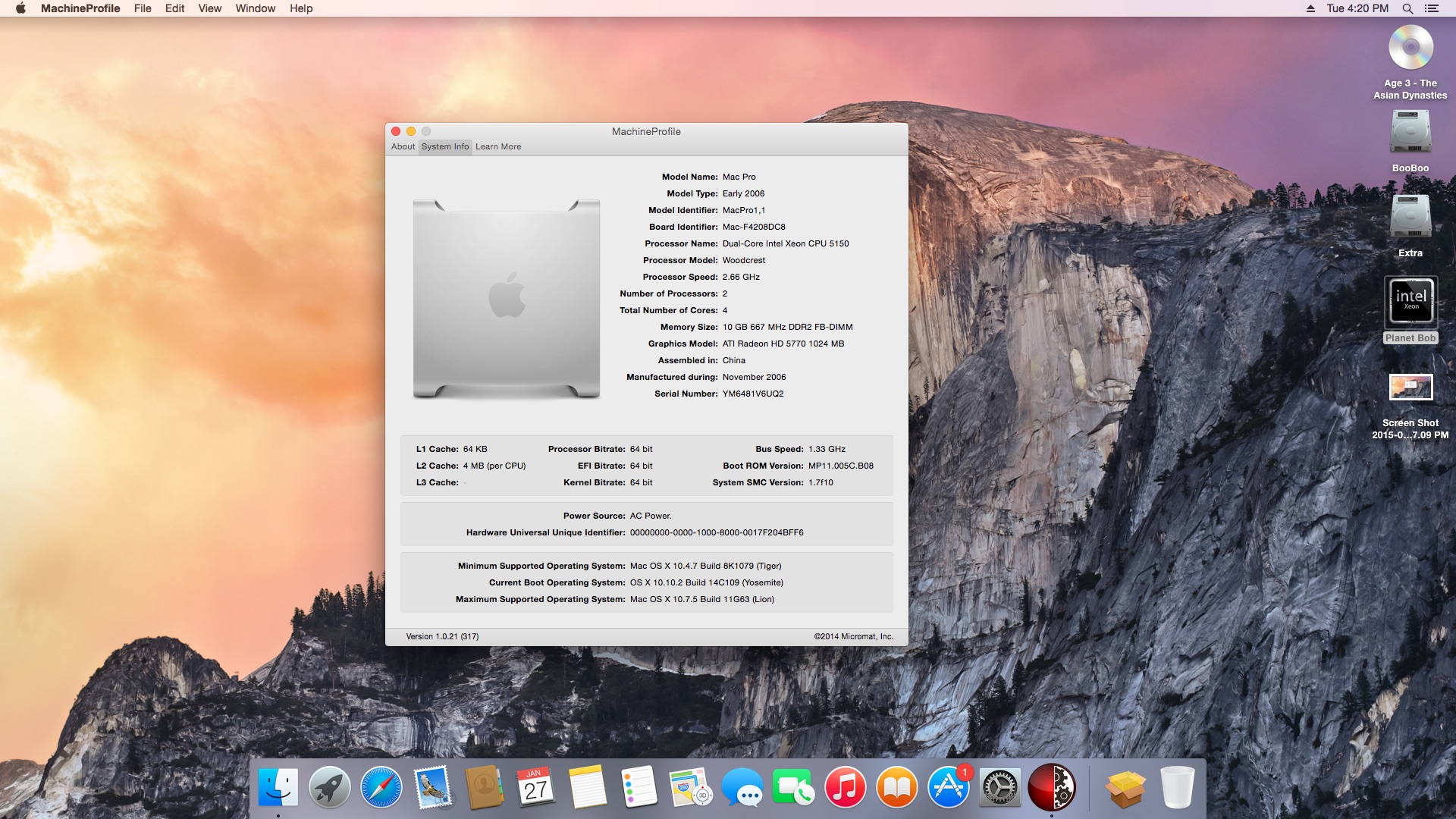

Success on Mac Pro 1,1 with 5770
Attaching screenshot. 10.10.2. Notice that I lose my optical drives after a time, and everytime the mac goes to sleep it wakes up without the superdrive or Blu-ray drive.
