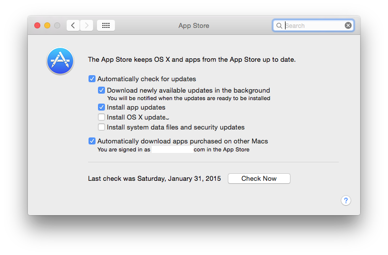

Disabling OS update?
Hi, I've read a lot of the difficulties people have been describing here with the 10.10.2 update and honestly don't have the time to sort out a possibly problematic EFI overwrite to my Mac Pro 2,1. I'm currently at 10.10.1 through all the genius EFI and script coding you guys here have provided. I donated to Tiamo back on Maverick's and the 25 euros to Piker-Alpha and would donate to more of you coders if I knew where to send it. at least enough for a beer or two :)
My question is: after a scary 10.10.2 Notification Center popup here this morning I went fishing for a way to disable that update from installing itself unbidden but I found nothing in the App Store. I also checked System Preferences for anything related to automatic updates. The notification seems to be claiming to have already downloaded it and wants my permission to install and restart. I seem to recall the last time I ignored a Yosemite OS update it went ahead and did install 10.10.1 at the next restart anyway. Ugh, what do I do?
TIA for any advice.
System Preferences > App Store
I just updated my MacPro2,1 to 10.10.2 with no issues but I previously had the PikeYoseFix installed. Others who had their Piker boot.efi overwritten by the 10.10.2 update either installed PikeYoseFix and then didn't reboot, so it never actually ran, or don't use the script at all.
The correct sequence:
  • first, install PikeYoseFix
  • if exceptionally cautious and running Trim Enabler, you may want to disable it
  • you must reboot before installing an OS X Update that overwrites Pike's boot.efi so the PikeYoseFix script installs fully for future automatic execution
  • only then install OS X Update
  • safe to re-enable Trim Enabler if you disabled it earlier
