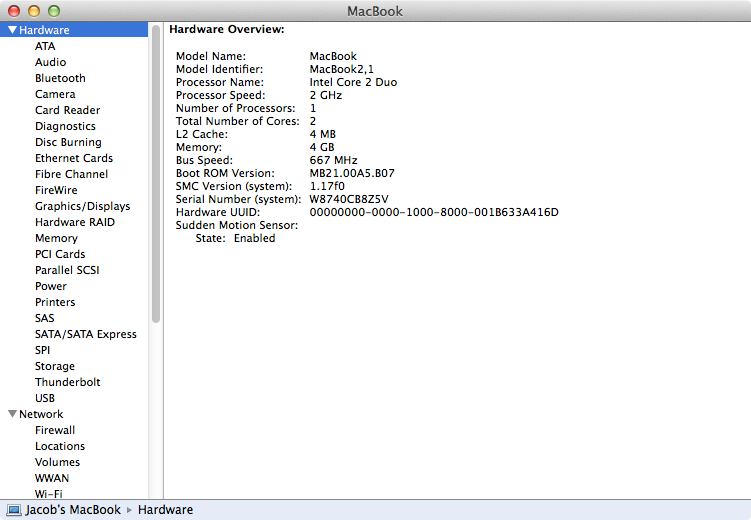

do you have screenshots of your current macbook settings, just so I can verify that you're using a macbook late 2006 model? I've been through other threads but that all seems to relate to the macbook PROS and not the actual white/black macbooks themselves.
