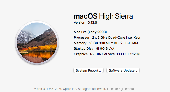

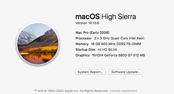

@tsialex , I've been trying to get my 3,1 to Catalina using the dosdude patcher. According to his website, I should be able to do it and yet I can't seem to get a stable install. I've only gotten one install through 100% (through setup all the way to a desktop screen) but it crashes extremely frequently. I have one ssd mounted on a PCIe and another installed in a regular HD slot. For the other 49 failed installs of catalina, they fail either during the install process or install almost completely ("about a minute left") and then crash. However, the volumes are recognized as startup disks with 10.15. If I choose it as a startup disk or run the post-installs and do the same, I'll see the APFS fix and then the computer crashes and turns off. Any idea what could be the reason why?
I've never used any dosdude hacked installs and I don't own a MP3,1 for a very very long time, sorry but I can't help you. One thing that I can tell is that your GPU is completely unsupported since High Sierra, your life will be easier with a more recent GPU like GTX 680 or any other Kepler NVIDIA GPU.
I recommend that you go to the Catalina Unsupported thread and ask about your problems there, it's the correct place to ask for help.
