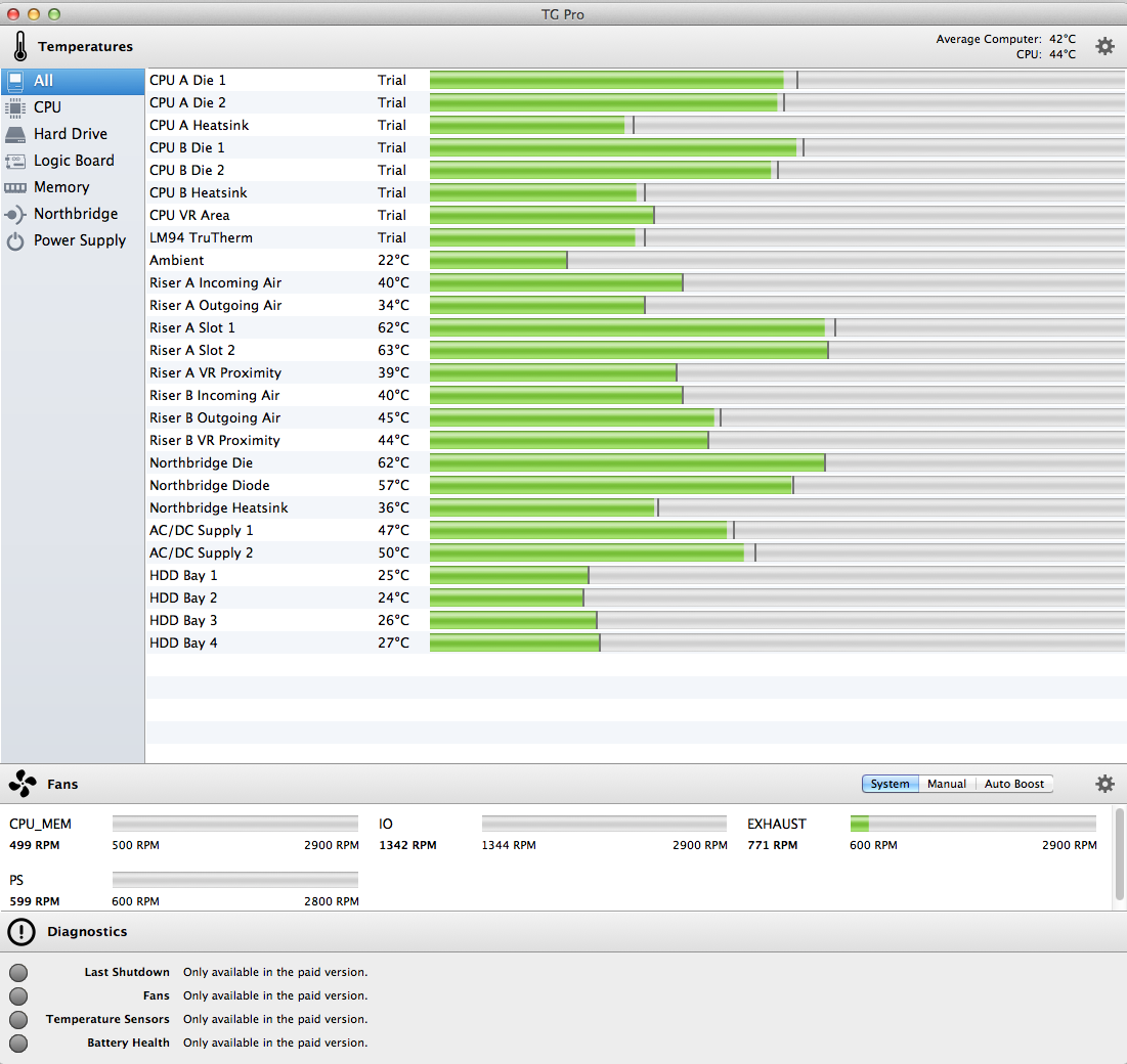

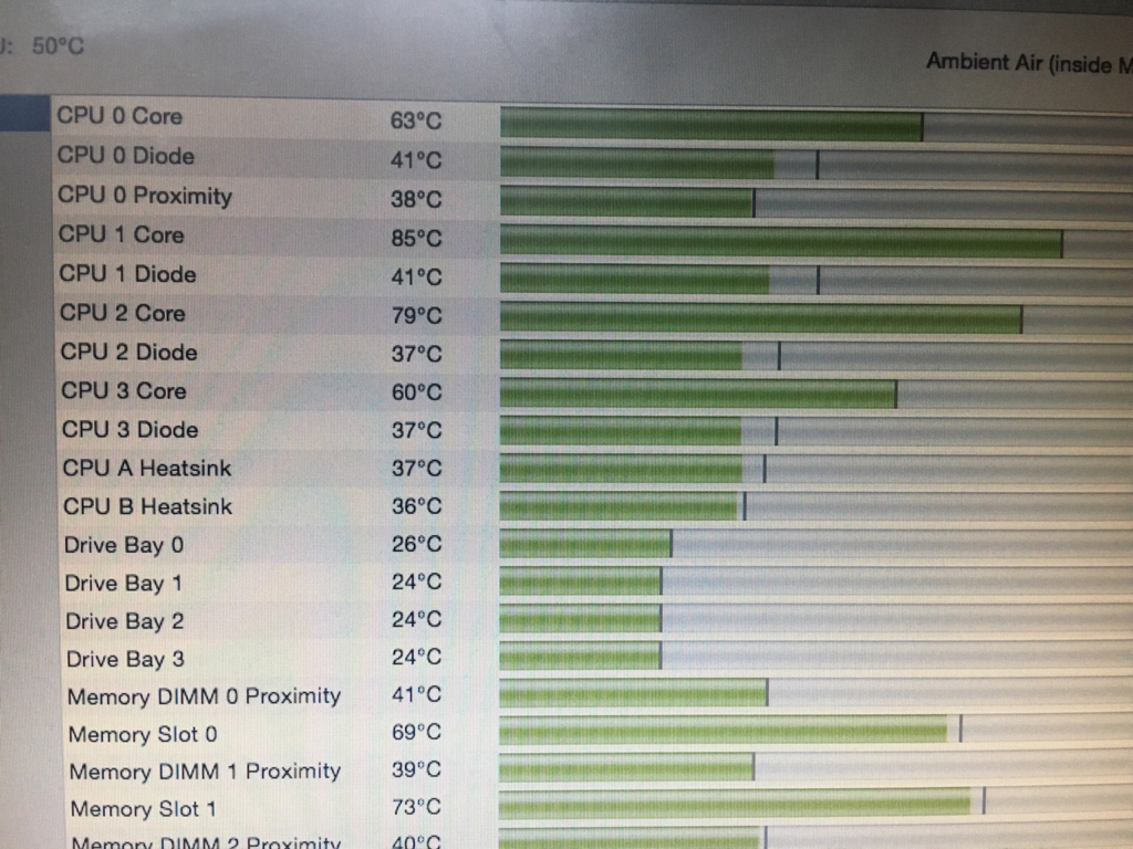

Now... attached is a screenshot of my Temp Gauge readings off my 2006 Pro that I'm typing this from. This computer has the dual 3.0ghz quad cores, running Yosemite, blah blah blah. The CPU core temps are way lower than that of my 2008 Pro. I can't get it to boot and stay up long enough right now to get a screenshot of it's temps but I will ASAP. What are the normal temps? Anyone have any idea what's going on? The temps on the 2008 are in the 70's... really high I believe.

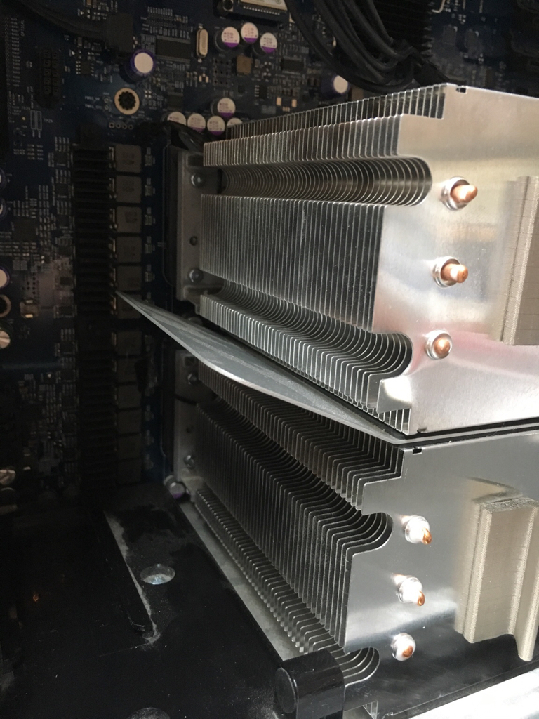

If you have not already done so, disassemble the front fan unit to gain access to the heat sinks. Using a small airblower clean them out. it's amazing how much dust and fluff builds up in those. Also give the machine a general dedustbunnying.
I'll have to look to see what processors I used. I built this machine last summer and don't remember which ones exactly I used.
The inside is hospital clean, including the heat sinks. It looks like a brand new machine inside.
Is it possible to provide a temperature capture of the problematic 3,1? If possible, 2 captures, one for idle, and the other one under stress (CPU).

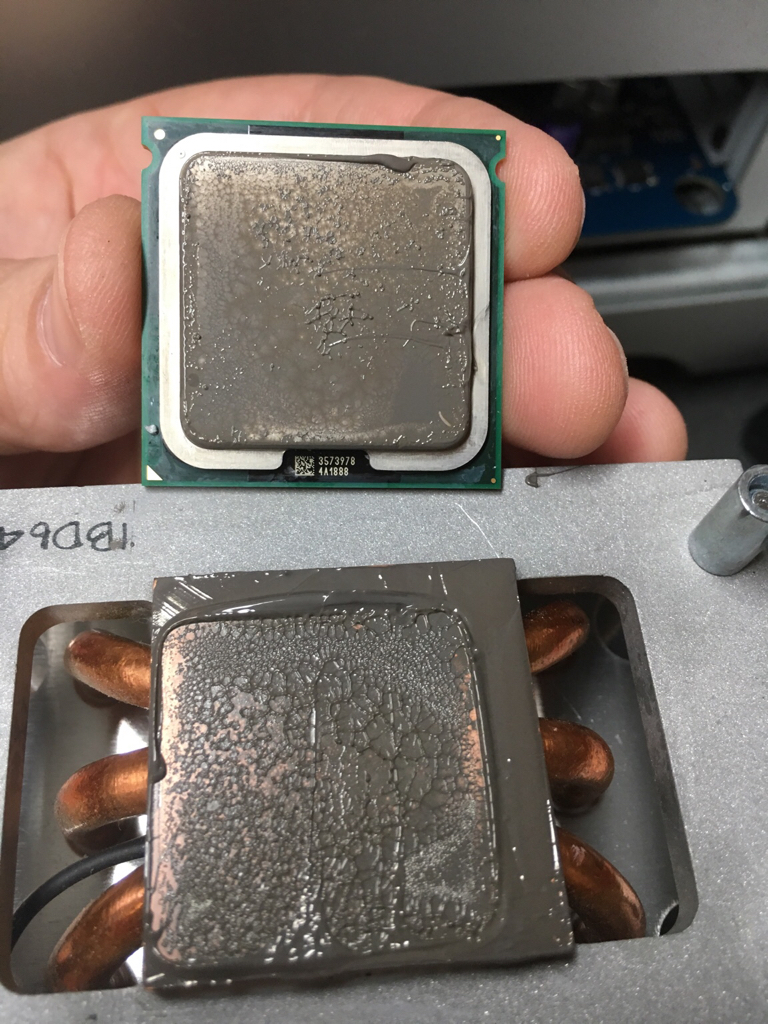

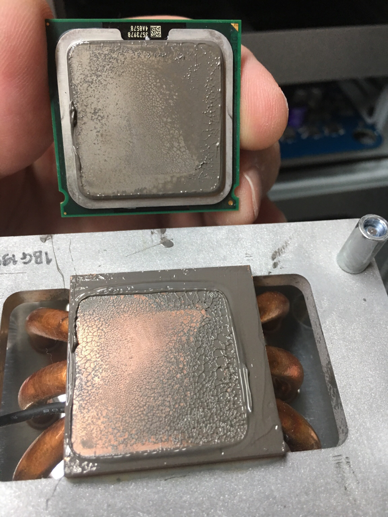

As you can see, it was clean. Like I said previously, I haven't long built this machine and it hasn't been used much. I am in the process of redoing the heatsink compound for the 3rd time now. I will post temp stats if it'll start and run long enough.
This is arctic silver, this is where I just pulled the sinks and processors.

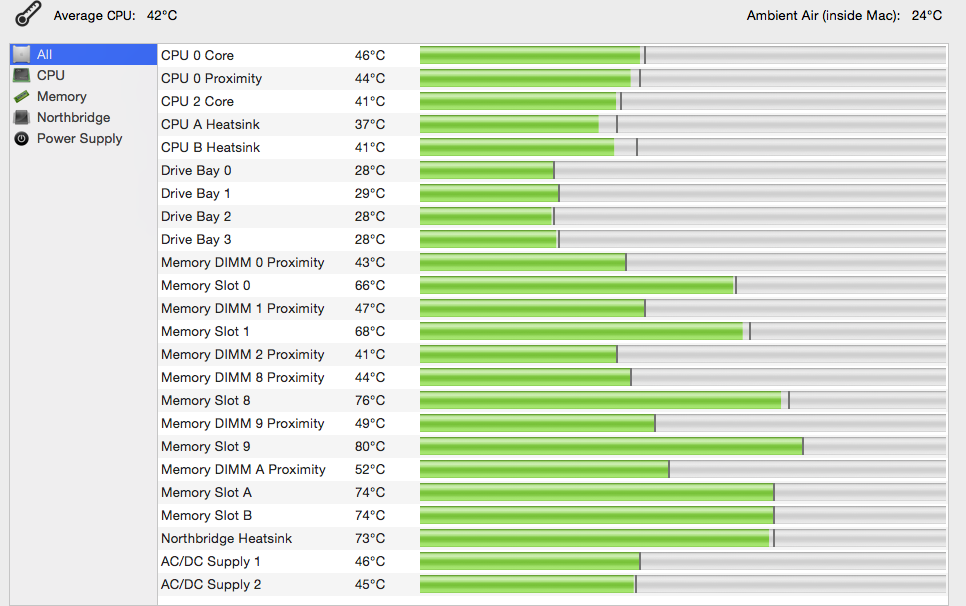

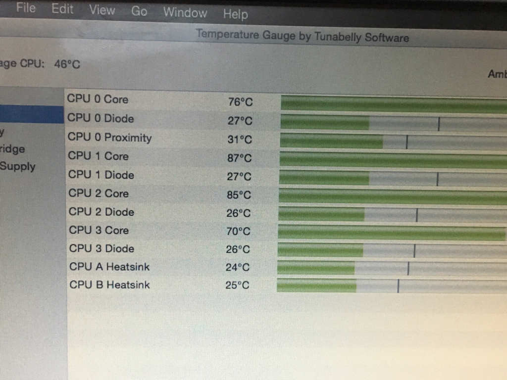

I've tried a little and a lot. Neither way changes. This is the 3rd time and I tried a totally different compound this time. It took forever to get it to boot and remain useable for a few minutes. Here is the temps at startup and idling.
Here are the temps with the fans manually turned wide open. They do not fall, they've remained the same.
Actually it only looks like a lot, I spread it with a razor blade, it was actually thin. It looks like half a tube in the pics but it really isn't. I have tried more and less though, I see no difference in the core temps.

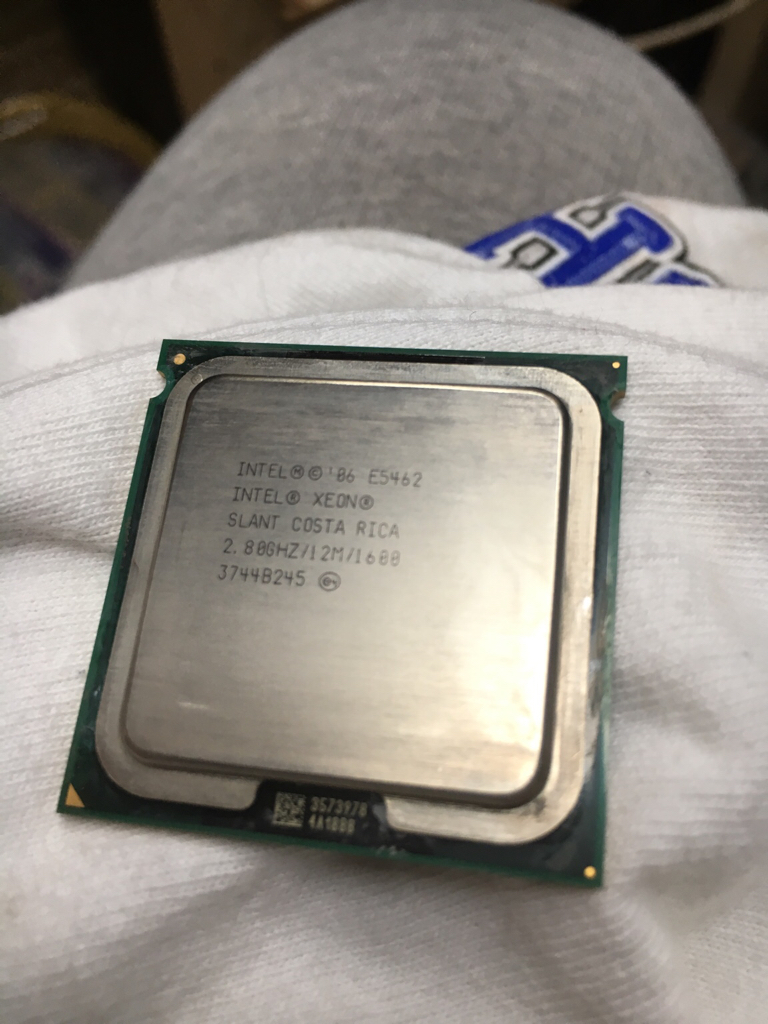

Is it possible to just have bad chips? Maybe I bought crappy processors?
Those are really high temps. The heatsinks don't seem to be doing their job very effectively. In the second picture, the heatsinks are at 24C and 25C while the CPUs are 70C-87C.

Intel's CPU die thermal sensors are not absolute sensors; they don't give a value from 0°C or 0K. They give a value of how many °C below max Junction Temperature(TJ max). The software that gives you an absolute °C must calculate that temp by subtracting TJ max from the sensor value. If it improperly calculates this, or if it has the wrong offsets(these vary greatly among Intel CPU models and lines over generations), you'll get ridiculous numbers.
Temp reading software is not to be trusted blindly.
Example, TJ max on an e5462 may be calibrated to 0°C offset at 85°C with a slope of 0.05°C negative measurement offset per 1°C and a zero point of 105°C. If your CPU is truly at 30°C, the sensor value will be something like 73. If the app is too dumb to calculate this properly and just spits out the sensor value, you see 73°C. That 73 value roughly means "your CPU is 73°C below overheating."
An easy way to test this is to see if the temperature drops when you put a load on the CPU. If the number drops as the CPU heats up, then the software is displaying the delta-TJ Max value. You can read that as "°C below max temp."
This paper explains it perfectly: https://pdfs.semanticscholar.org/c72e/ec75ada03c19580d569d52373ab1c8347544.pdf
Also, those sensors read TJ Max, which is often 20-30°C hotter than TCase Max(inside CPU die vs on top of heat spreader 'lid'). You can have 68-70°C TCase while TJ is 100-105°C, using Intel's reference thermal design. Both max temperatures are correct, just different temps. Think like a motor having 1500°F exhaust gas max and 230°F coolant max. The two are both correct maximums, but you have thermal resistance between the two. Another example, fire on stove burner may be 900°F right inside flame, but water in pot is 200°F.

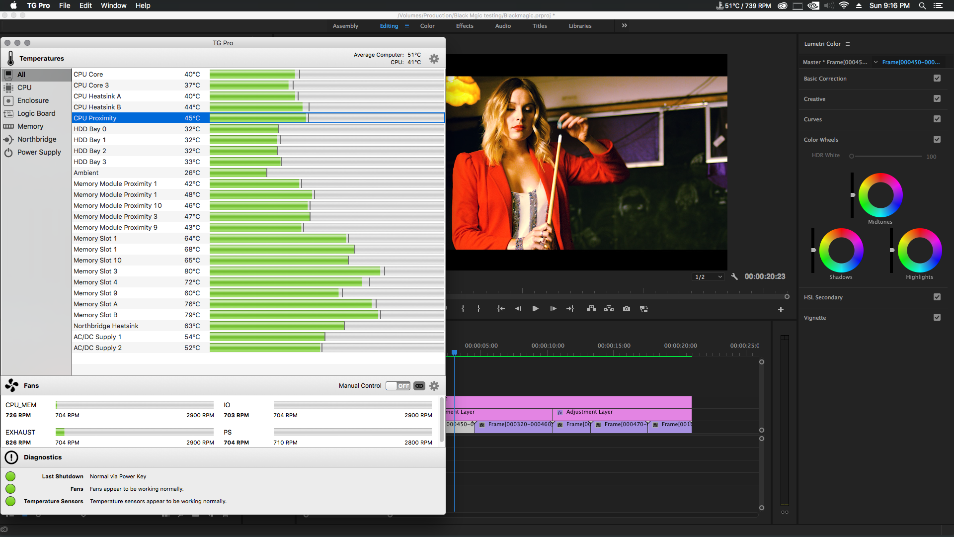

I think we both kinda have the same problem but mine is not that high cause I'm editing 4k video while I'm monitoring the temp

You're also using WAY too much thermal paste. Less is more in this case. You just want to fill the voids between the two metal surfaces. If you're doing more than that, the goop becomes an insulator. Copper and nickel-plated copper are many times better heat conductors than any paste. Having extra paste in the way is not helping.
Read this, or at least look at page 3: http://www.arcticsilver.com/pdf/appmeth/int/vl/intel_app_method_vertical_line_v1.1.pdf

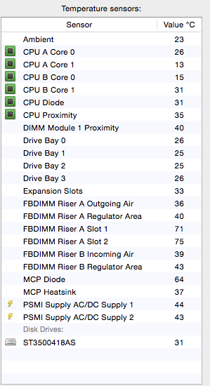

Ok, I got the Mac's Fan Control, attached the capture of what it says my temps are. Somewhat different from what Temperature Gauge says...

Yep. That other app is garbage.
You may still have another hardware issue causing your other problems, but it's not your CPU's overheating.
The core temps are terribly inaccurate at lower temps. They aren't meant to be used for what we're trying to do here. They're meant to indicate to the system a relative value below overheating. In that regard, 73°C below overheating vs 66°C below overheating doesn't really matter. They're fairly accurate as you get close to max temp; lower temps not so much.
There's a per-core offset as well that's registered inside the CPU, but not readable. Good luck with figuring that one out.
