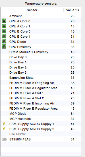

Ok, I got the Mac's Fan Control, attached the capture of what it says my temps are. Somewhat different from what Temperature Gauge says...
I've had it up and running since I posted the captures earlier. This Mac is outside in my HAM shack, so it doesn't see constant use. Just came outside and it's still up and running, the screen had been put to sleep, woke it up and it's still up and running. Odd.
Yes, the RAM has the Apple heatsinks on them. I've tried the thermal paste both ways, very little and too much. I'll tear it back down and redo it for the forth time, using much less this time. See if it'll boot back up afterwards and see what the temps are. Thanks!
I am not familiar with the 3,1, but what catching my eye in your screen capture is the MCP temperature. That's looks like the north bridge to me, and obviously the heat on the chip cannot effectively transfer to the heatsink.
Well I swapped hard drives and it ran for awhile and then flipped out again. I'll look into the northbridge, I hadn't really paid it any attention until you mentioned it.
If it's not a heat issue, I guess I'll start with a power supply and from there.
