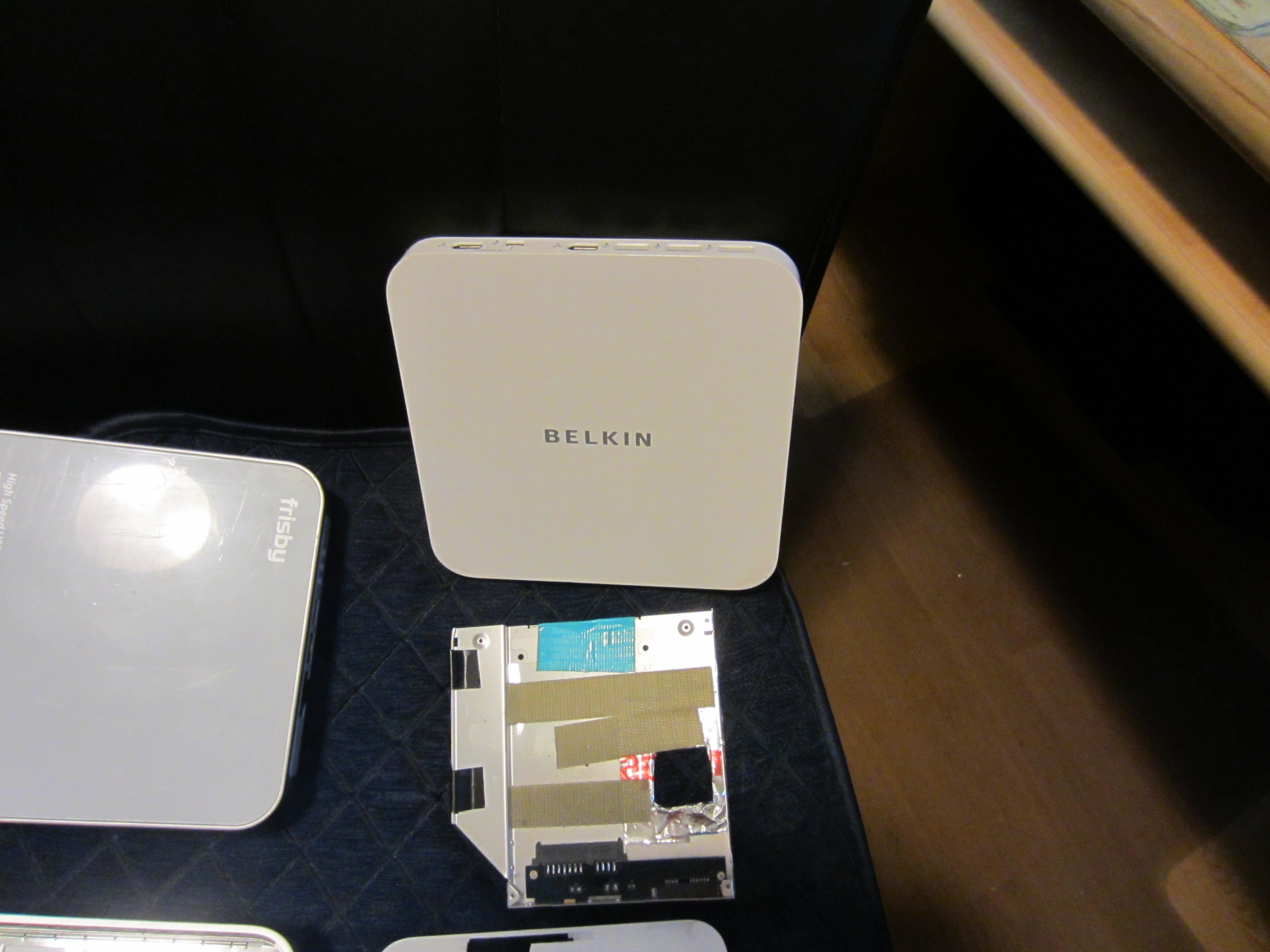

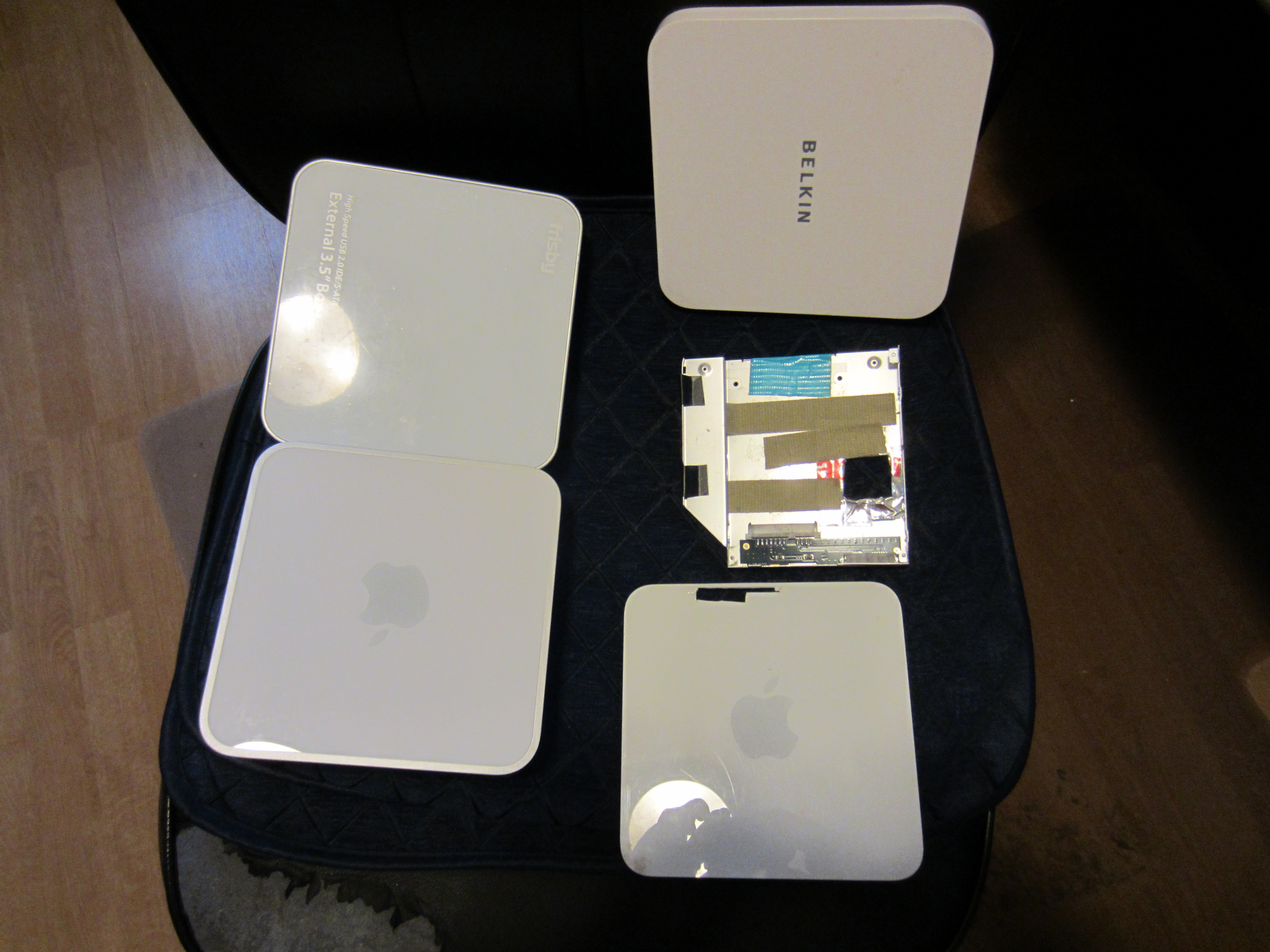

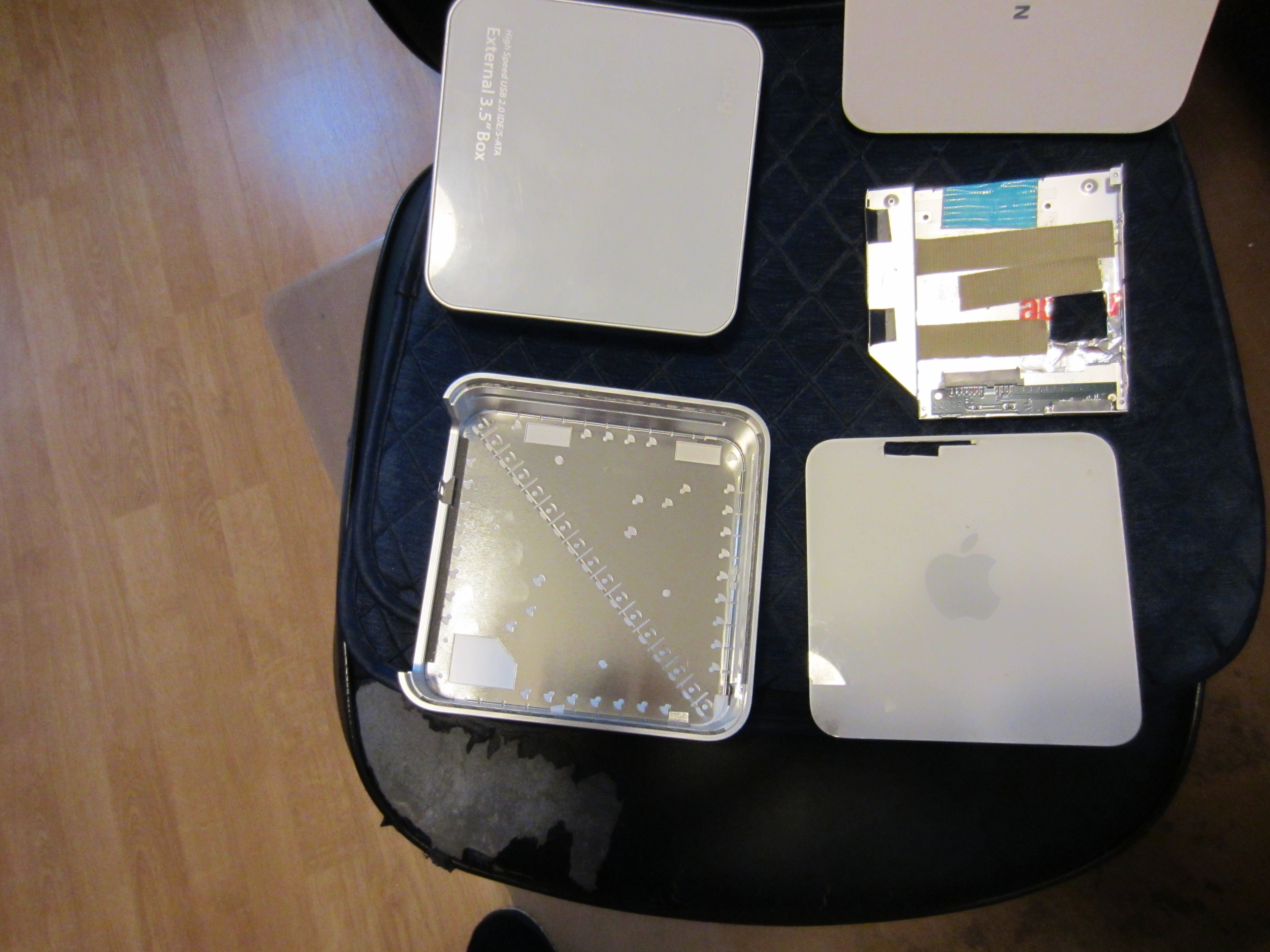

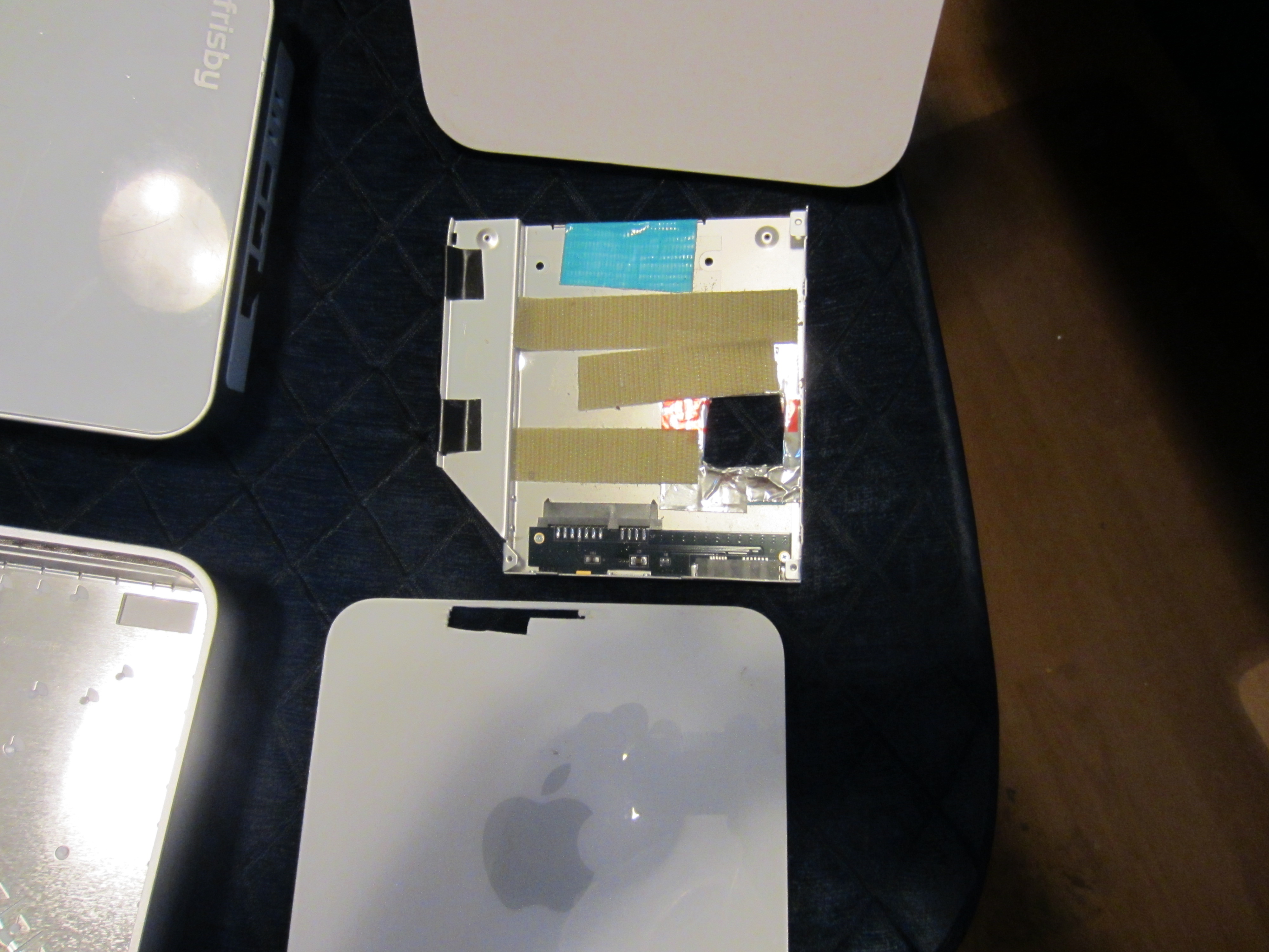

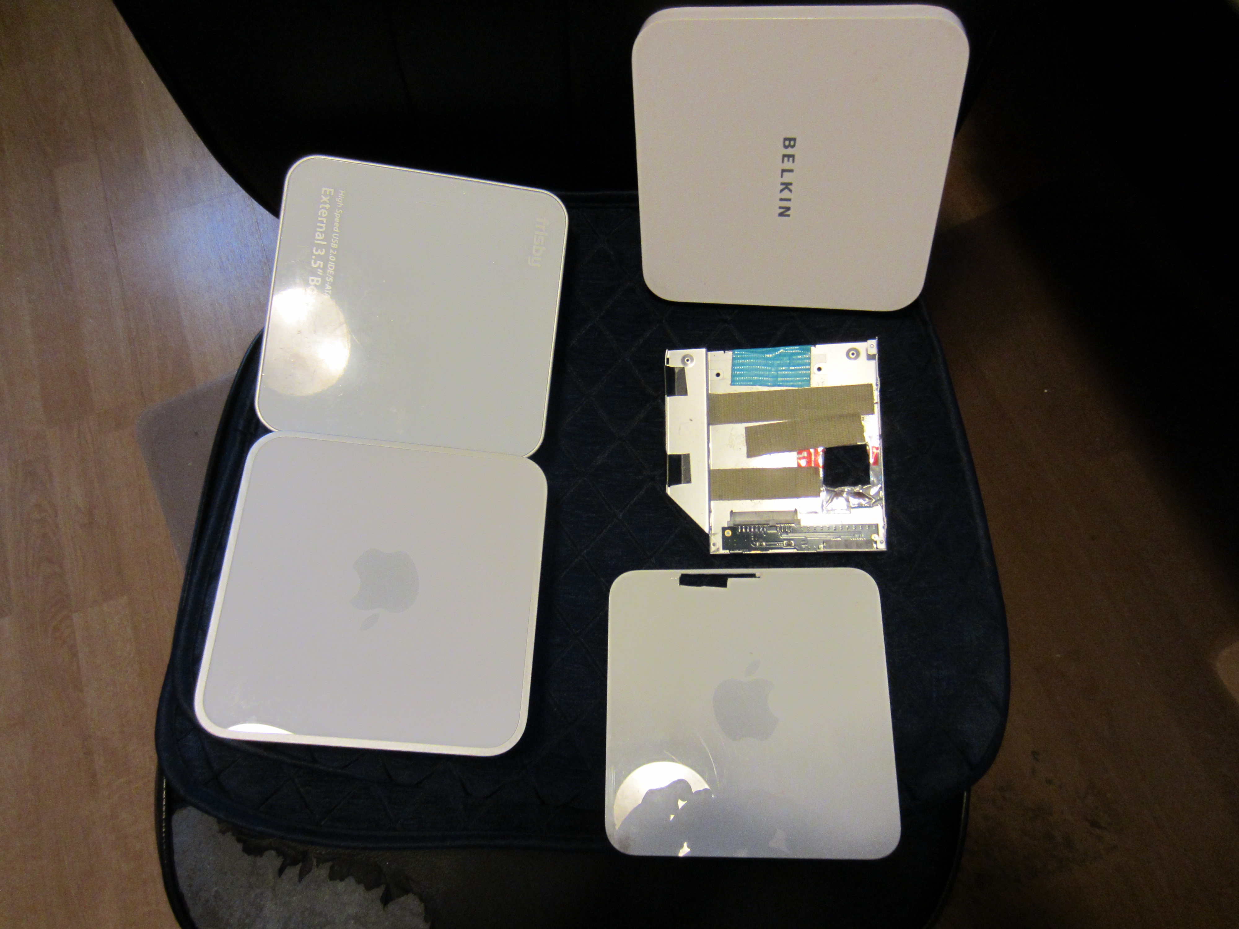

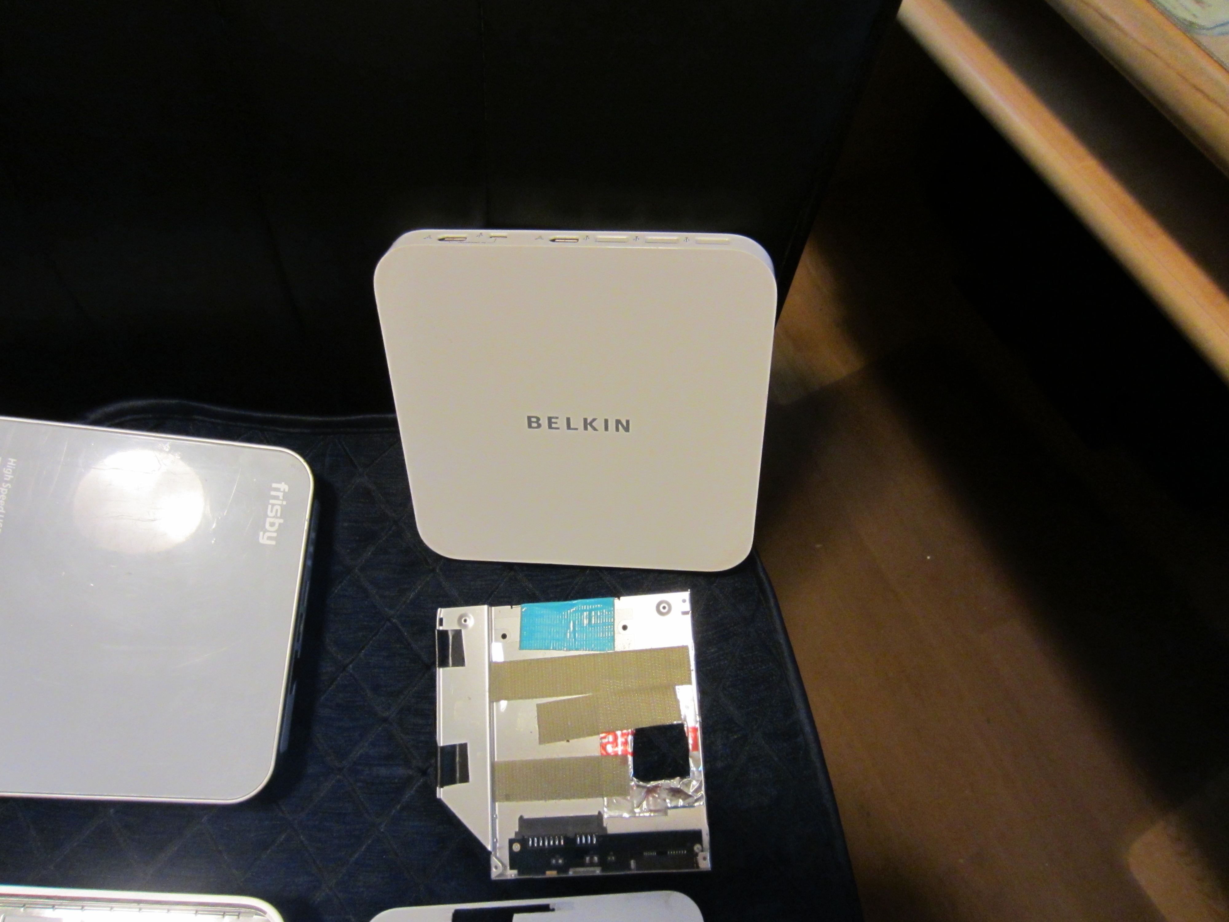

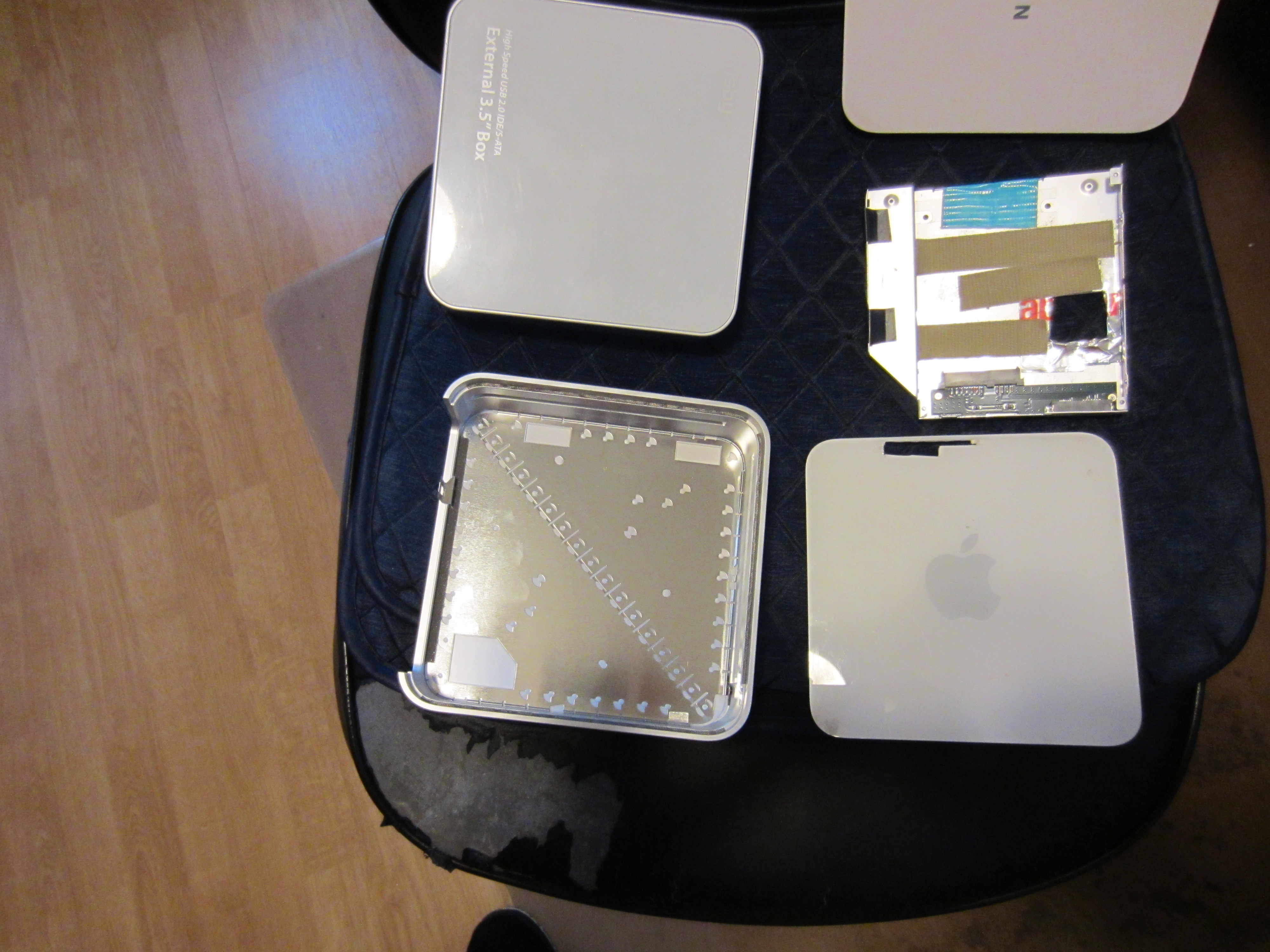

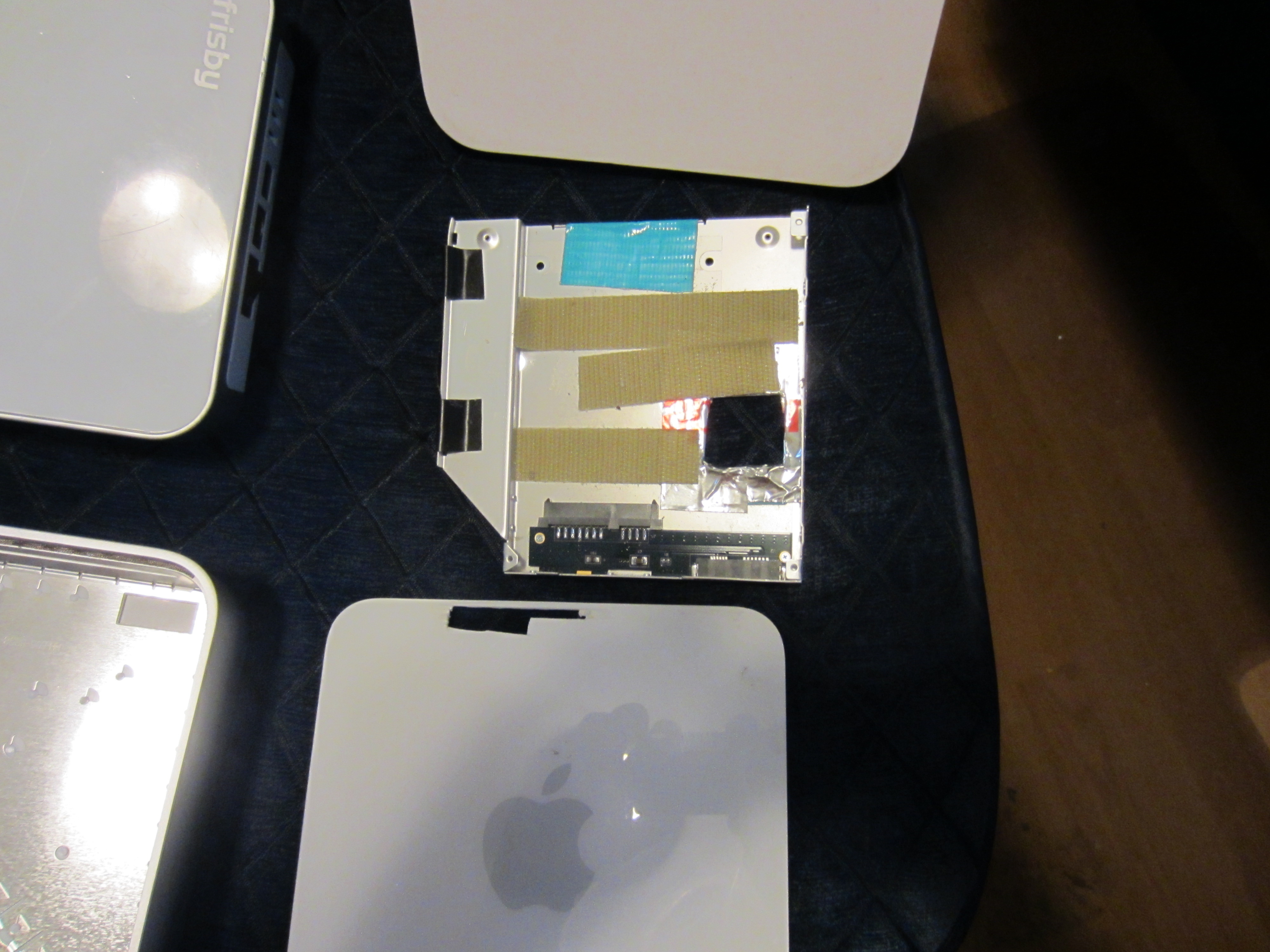

hey guys relax I ran it years ago before 4tb existed.
It worked on 3tb. this is the what it was hooked up to
http://www.sansdigital.com/towerstor/ts1ctplus.html
at the time this unit supported only 2tb.
it then got a firmware and did 3tb.
my mini did 2 of these. so it ran 6tb. I then did the smaller 2.5 each raid cases from owc they had 2 1tb drives each.
to the op give me a minute to post shots of the gear I have left over.
