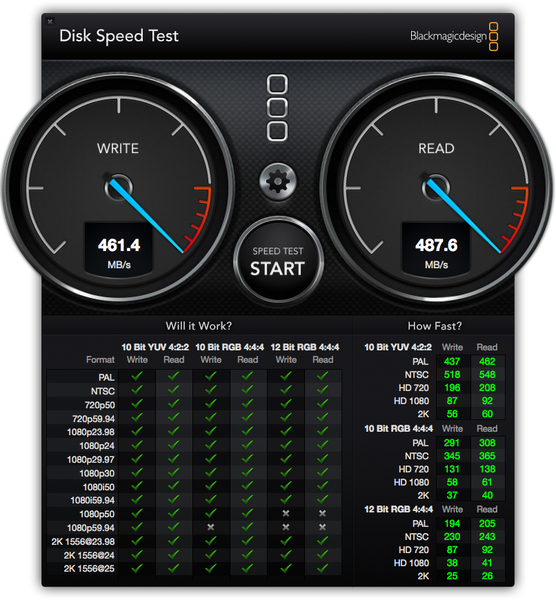

This what I get with my Samsung Pro 512GB on Sata3
I'm getting around 260/270 MB/s write/read without PCI card.

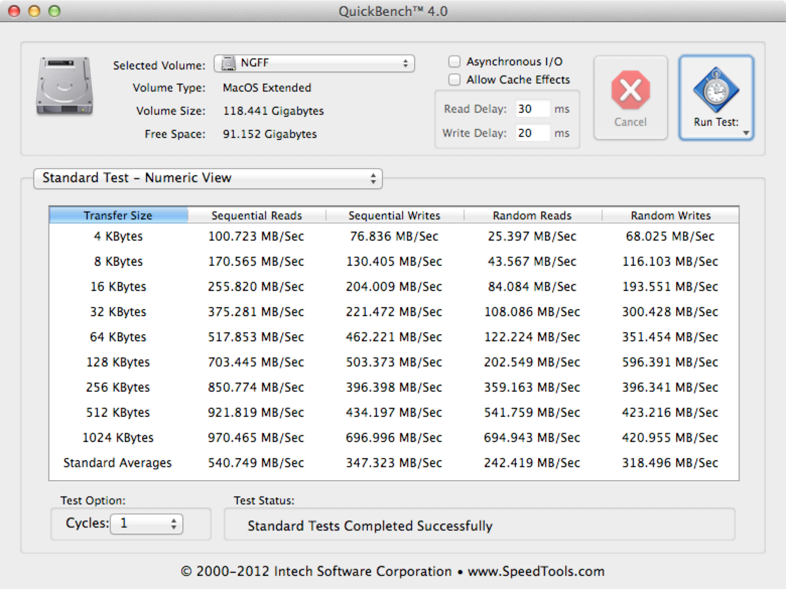

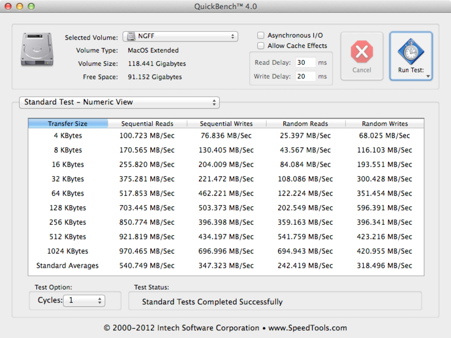

In a 4,1 upgraded with 5,1 firmware: Here is a recent benchmark on a NGFF Flash drive using the same controller in the 6,1, coupled with a 4x PCIe adapter. Market availability on the XP941 is beyond constrained. Adapters can be found, tracking down the SSD is the trick.

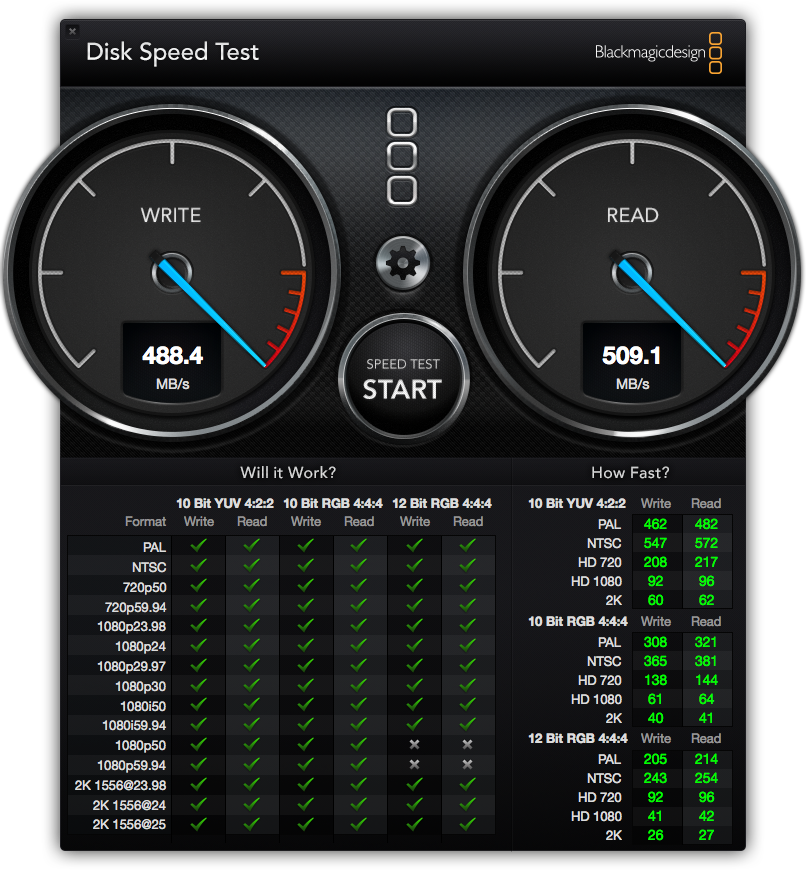

Meanwhile my Mac mini is mocking its older brother:
