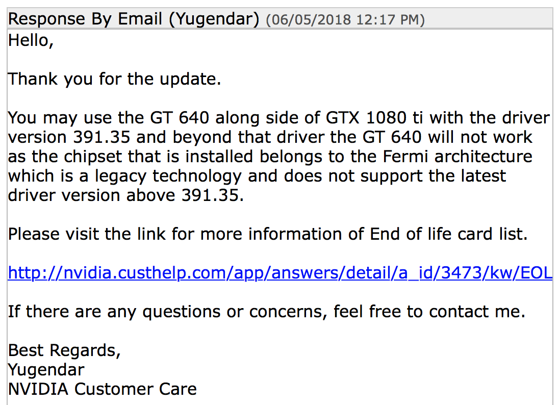

Update 1: Got a confirmation from Nvidia that the GT640 (most likely including any other Fermi architecture GPU) can work with GTX 1080Ti in Windows 10 up to driver version 391.35

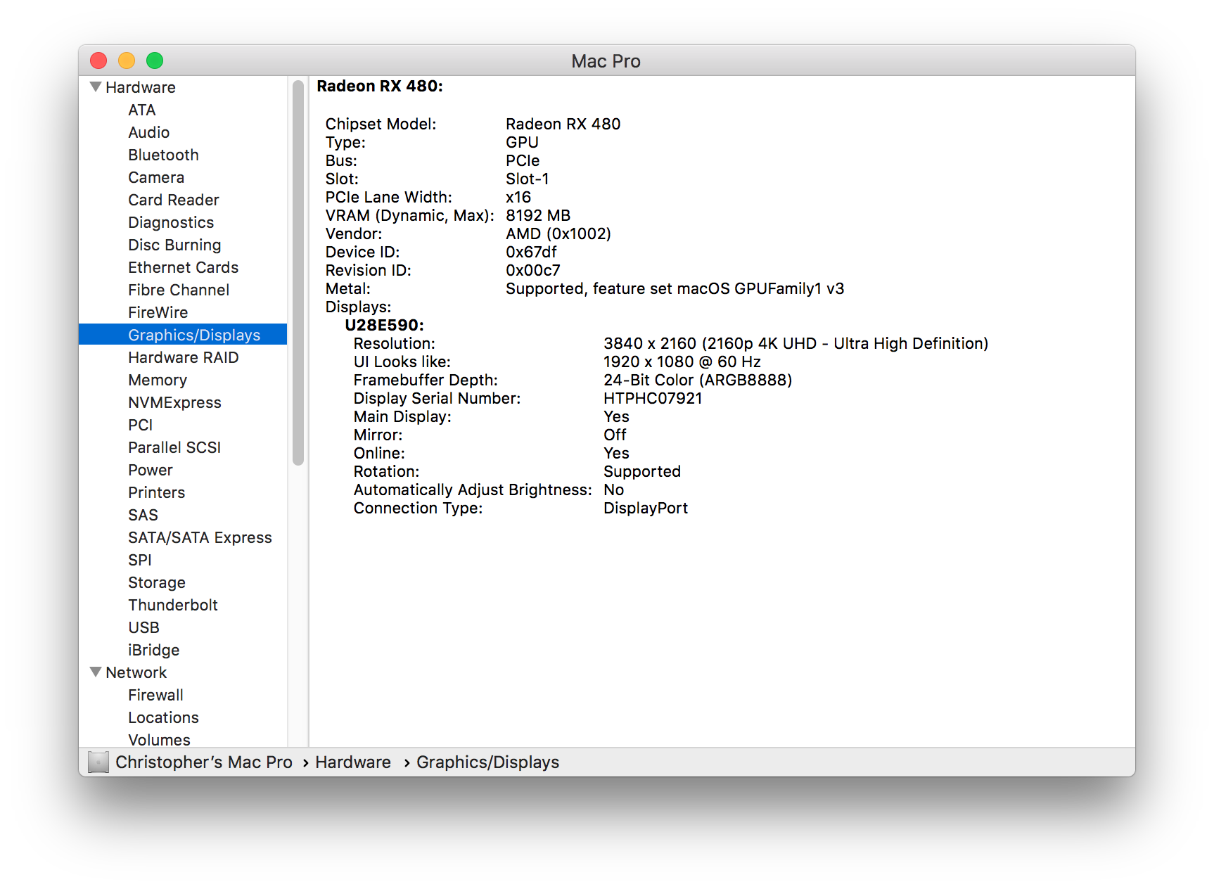

In case it's helpful, the MBP 15" Late 2013 (11,3) shows the built-in Intel Iris Pro as METAL compatible and the NVIDIA GeForce GT 750M as METAL compatible. Currently running NVIDIA web drivers on this machine.
Both GPUs (if you can call Iris Pro that) show "Metal: Supported, feature set macOS GPUFamily1 v3"
