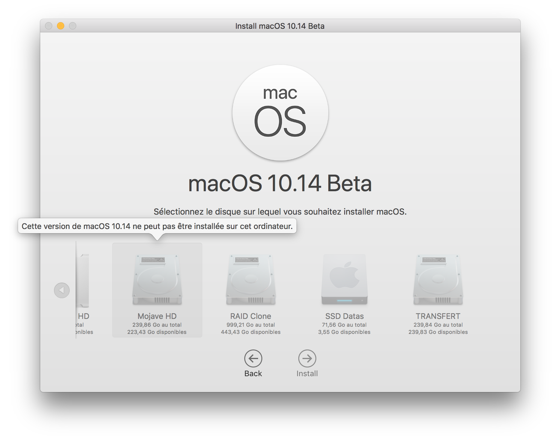

thanks! and how did you get passed the following? tempering a file for check i imagine?

@LightBulbFun i've seen in the installer log it checks the ROM version, so i assume it end up saying "wrong mac" but how did you tampered this? is there an easy way
the Mac Pro 5,1 is actually in the "not supported macs" lists
what I did was install Mojave onto a partition on my MBP9,1 then replace the "PlatformSupport.plist" in /S/L/CoreServices with the one from HiSi (and in the prebooter volume if APFS) then stuck the MBP into TDM, which got it booting on my Mac Pro 5,1 🙂

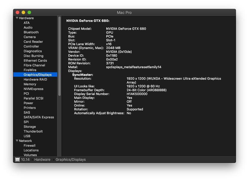

Unrelated question: On your Mojave cMP5,1, Finder works? Always restarting here…
yeah on my 5,1 its worked fine (there where just a couple graphical glitches here n there)
but iv read everyone else seems to be having finder issues...
im curious does it only happen with your GTX 680 Mac Pro or does it also happen with your HD 7870 machine?

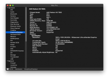

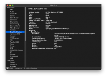

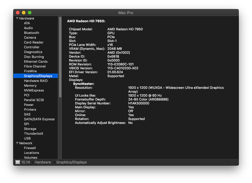

Weird, installed the HD7870 on the same Mac Pro, same restarting Finder - never opens.10.14.GTX680.png10.14.HD7870.png
On thing, Metal support string changes between AMD and Nvidia cards.
