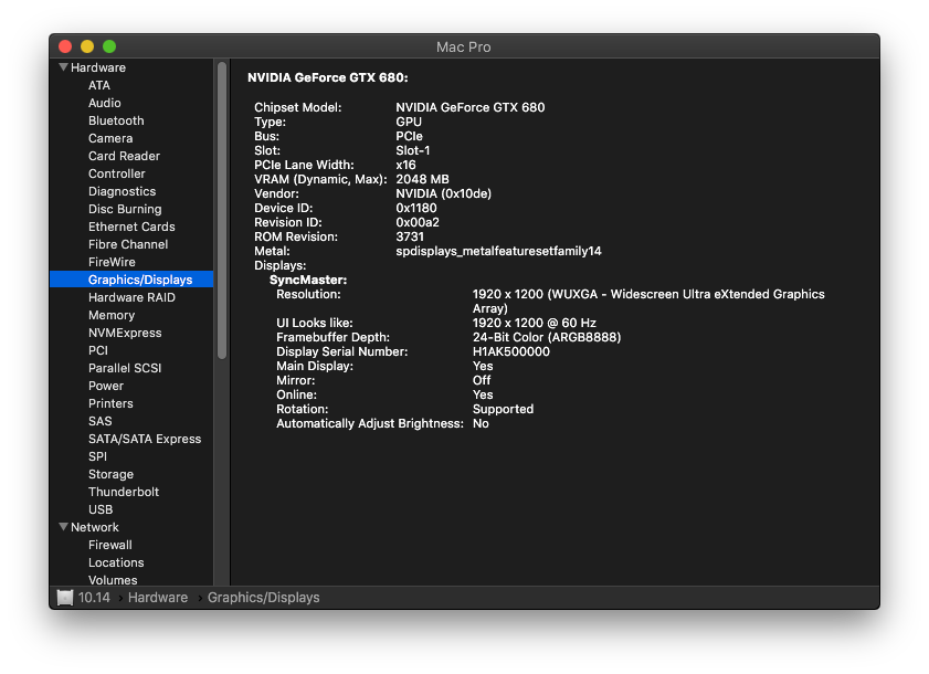

Weird, installed the HD7870 on the same Mac Pro, same restarting Finder - never opens.View attachment 765334View attachment 765335
On thing, Metal support string changes between AMD and Nvidia cards.

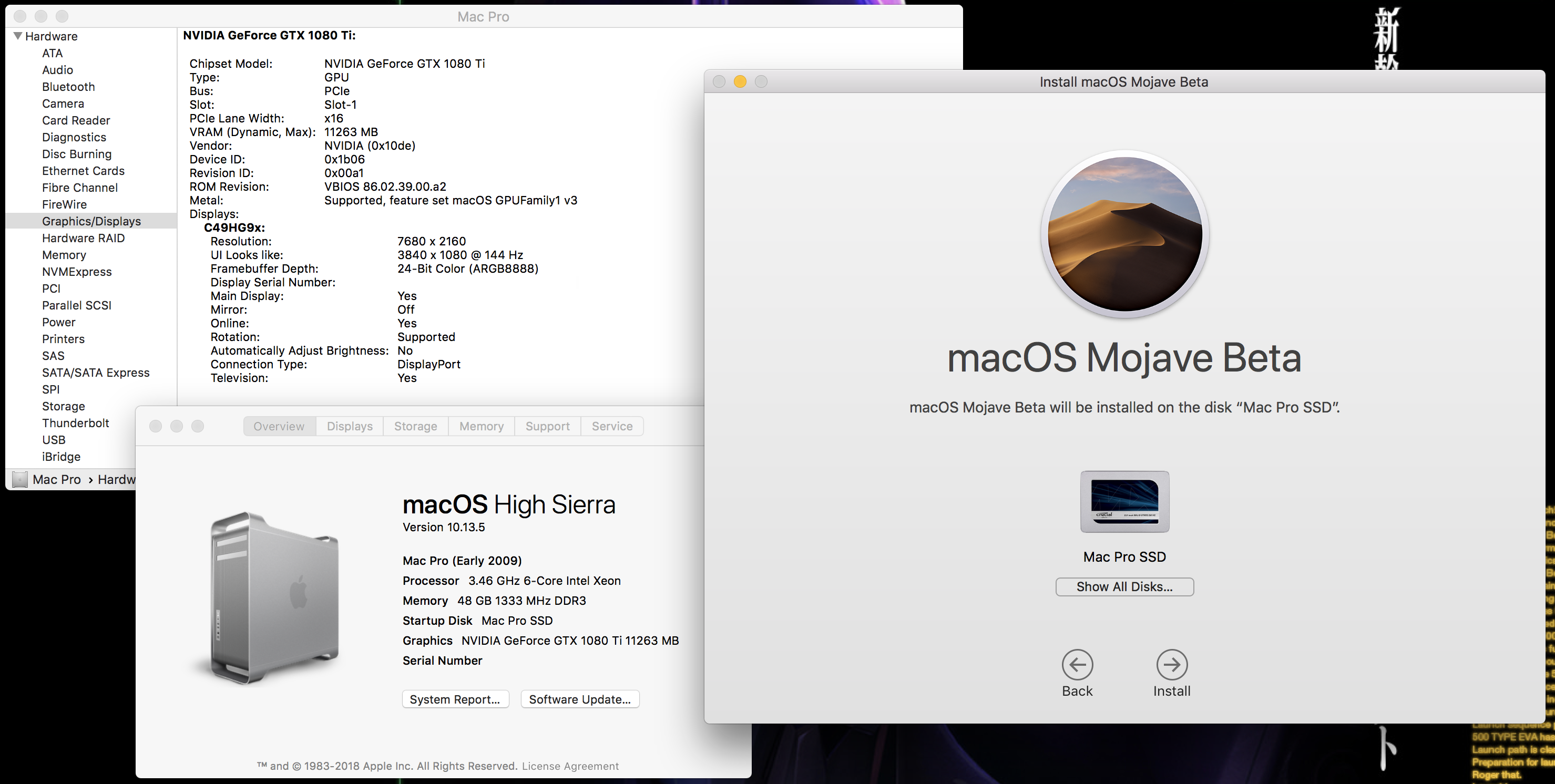

Just Updated Open GL Viewer to new version 5.0.8. Still reading the same as the last one:
I get different results. System Information tells me:
Metal: Supported, feature set macOS GPUFamily1 v3
Opem GL Extensions Viewer tells me:
This is with an MVC flashed GTX 1080.
Apparently still not updated correctly.

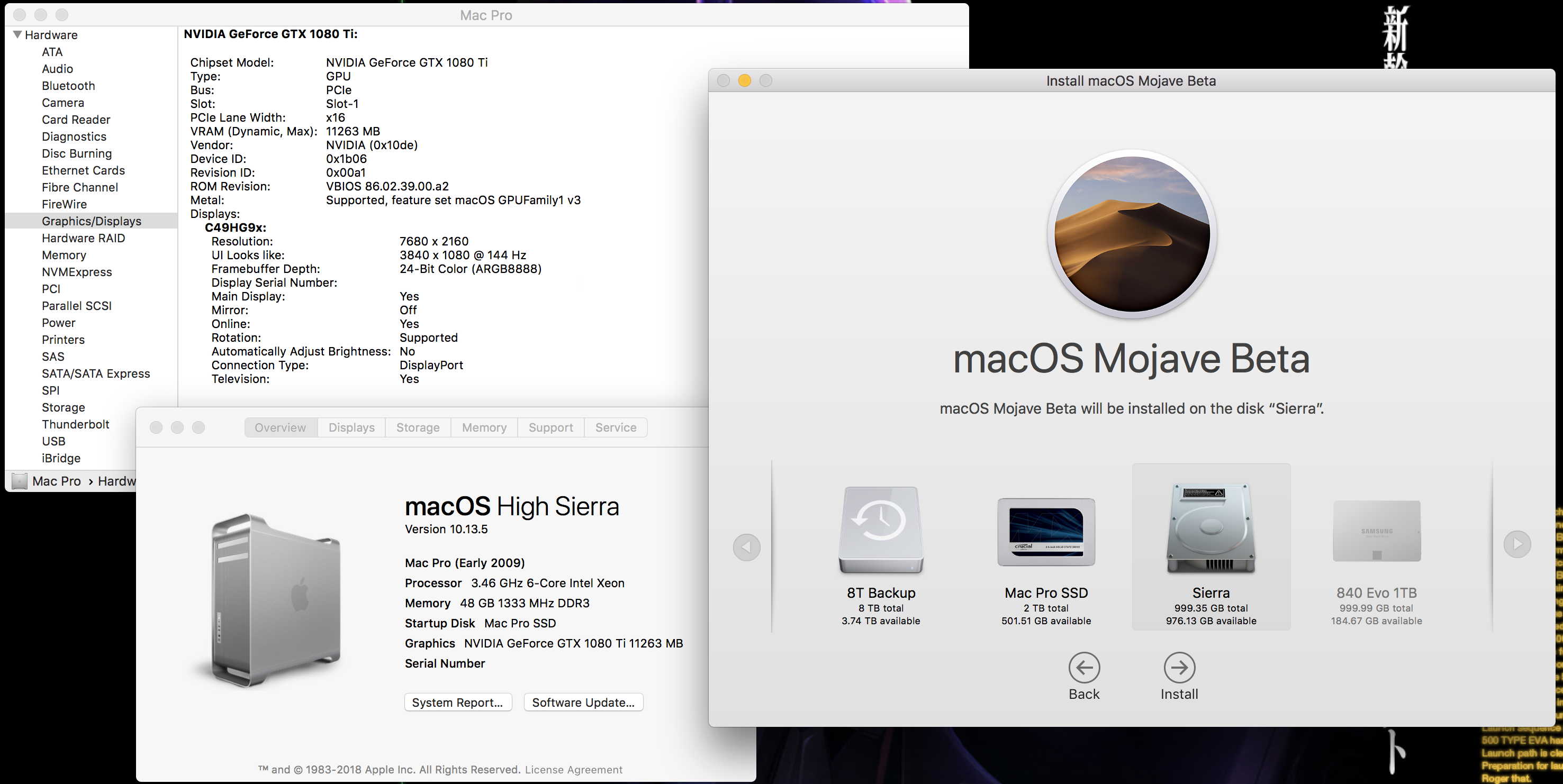

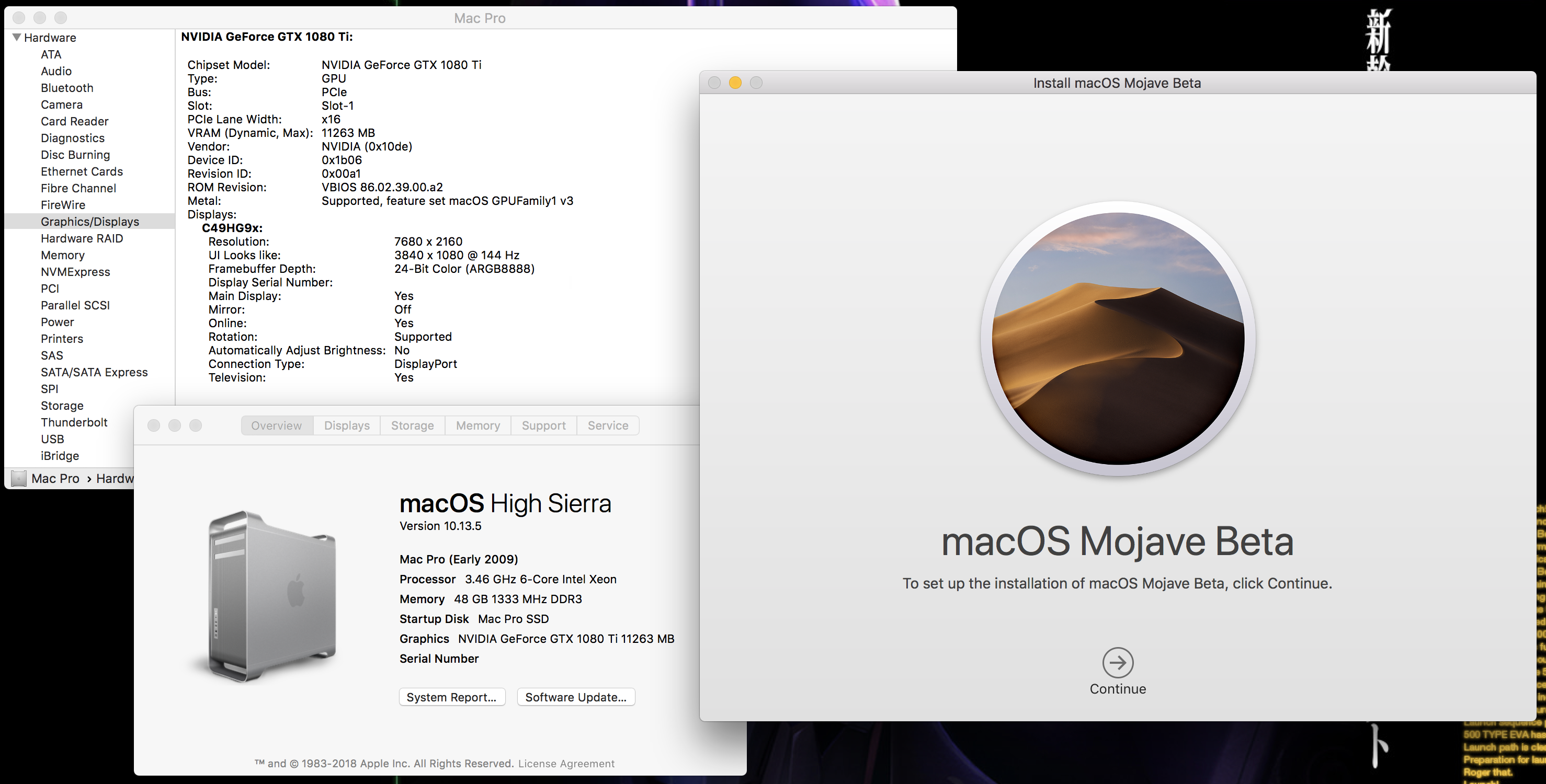

For info, there is no need to worry about if Pascal card can install 10.14 (directly upgrade from High Sierra). Just tested that on my own cMP. Obviously it can.
But I cancelled the installation. Because there is no web driver yet. And I have no spare time to do that yet. I only has spare HDD, the installation will be super long. I want to avoid that. I still have quite a few videos need to encode.

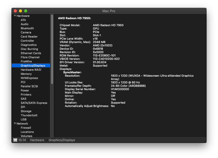

I picked up a AMD HD 7950 last week, just to make sure my 2012 5.1 is Metal-compatible. Nice card, feels a lot snappier than the 5770 that was in when I bought the 5,1 two years ago.
It's not the official Mac Edition HD 7950. Not the white look but the red one. So I'm guessing it must be a PC version. I don't have boot screen but apart from that everything works just fine.
The card is mentioned generically (is that English?) as a Radeon HD 79xx card and has Metal support listed. Is there anything that I should do? Can I check if the card has been flashed? How? If not, should I flash it? How?

I have the same flashed AMD HD 7950 card and is does show metal in HS. Mine shows the Apple logo slash screen during boot-up.
Hoping 10.14 will work with this card too...have not tried.

It's not flashed, otherwise will show boot screen and should show HD7950 in "about my Mac".

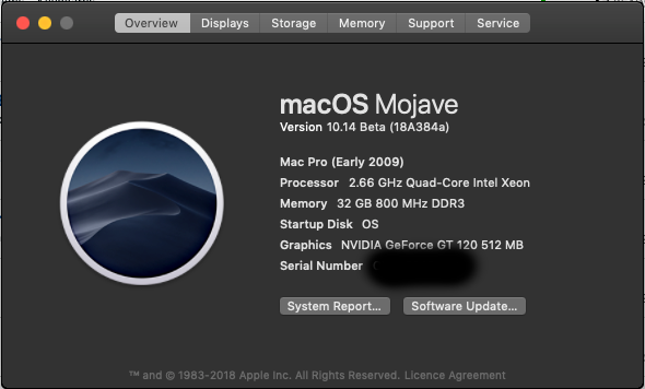

I say, who needs a new graphics card? Thanks to http://dosdude1.com/mojave/ I am running Mojave!
Reactions: tipoo and orph
How interesting. So someone even with a supported model could install the legacy video card patch to get acceleration running on a non-Metal card? It looks like it doesn't' support the HD 5770 or 5870 though? But fine for older Nvidia cards like GT 120? Very cool.
Apparently there are a couple of cards that don't support acceleration but happily my Nvidea GPU is not one of those, and I have to say that to my, admittedly untrained, eye the graphics seem quick enough!
