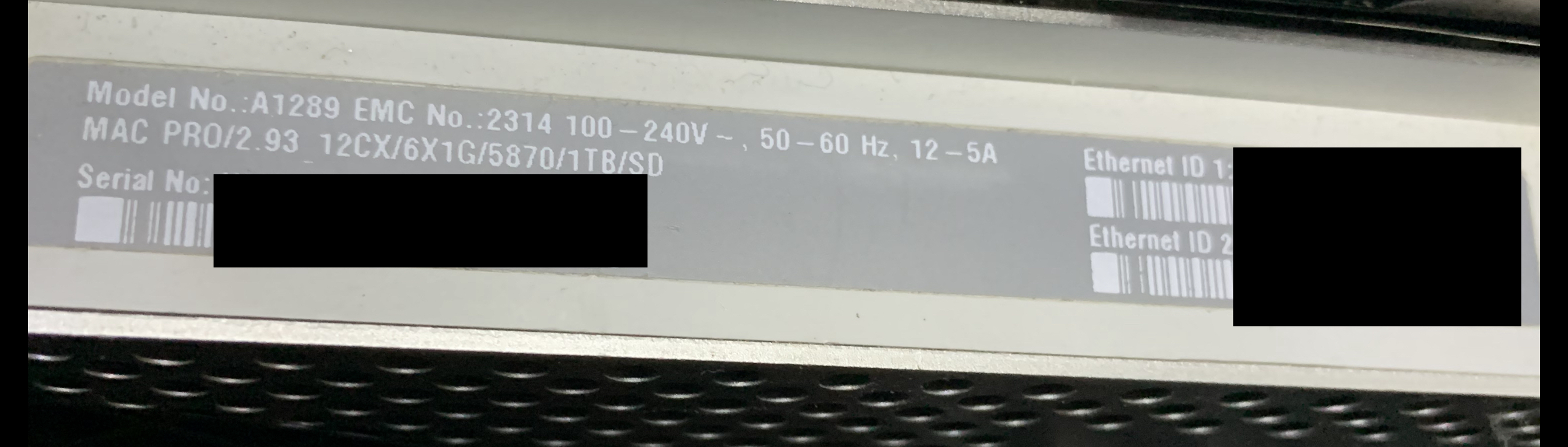

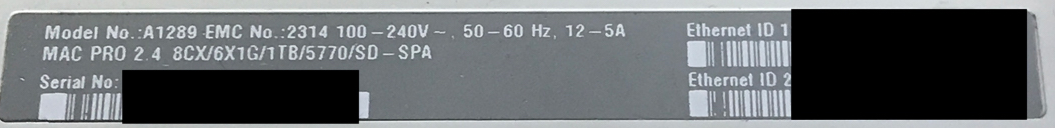

The best way I know of is to check the images for an EMC number on the back label. If there isn't one showing, ask the seller for it. For a 2009 it is 2314; for a 2010 it is 2314-2.
A lot of EMC labels of real MP5,1s don't have the -2, so, this is not a reliable way for differentiating a MP4,1 from a MP5,1.
Below are two examples, I have lots more, you can confirm that both are real MP5,1 easily just looking at the GPU.
^^^^But, GPUs are replaceable. When I bought my 5,1, the first thing I did was replace the GPU.
Lou
It isn't the GPU itself. 🙂 The GPU version number is etched in those plates. There is a 5770 and 5870 in the examples above. ( some system specs are etched there too. )
Won't be able to tell if 2012 or 2010 since those didn't change, but there isn't much of a difference there at the firmware level.
Checking the serial number is a good additional sanity check. https://checkcoverage.apple.com
( Folks can go through significant efforts to fake that but the more work to do fake the more likely will run into someone a bit lazy. It is not perfectly effective but incrementally better. Some forgers work harder. ). If two checks line up there pretty good chance it is 'real'.
You can tell 2012 apart because they're EMC 2629.
