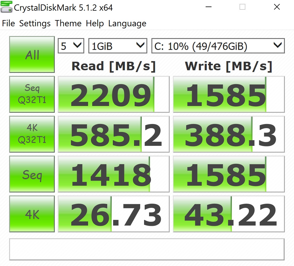

I also have the same drive in my new laptop and as you can see the drive reads much higher but that's about it, your not loosing that much performance on the Mac Pro and in real world normal computing you probably wouldn't even notice the difference when accessing files.
