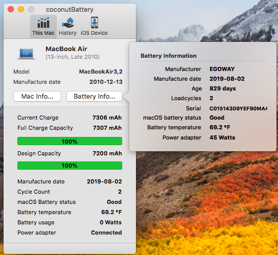

Have the results here. It's a third party battery and reports back to the computer as "normal". It's brand new so it's kind of odd to be seeing that. It's worth noting that the original battery that came with this computer also reported back as "normal" but sometimes said "service battery". Both batteries experienced throttling under 40 percent.

Thanks for sharing those results. Your battery has been in operation for longer than the one in my 2011 MBP and would appear to be in a much better state with 100% for both the design and charge capacity. Have you tried recalibrating the battery? Check out this guide and follow the steps - it might be helpful.
I have calibrated my battery and it still did the same thing. It’s brand new so it shouldn’t be in operation for that long.
Can you try running pmset -g thermlog in Terminal, once while on battery and once while on charger and watch it for a couple of minutes? If CPU Speed Limit is less than 100, that confirms throttling is active - if so, by how much?

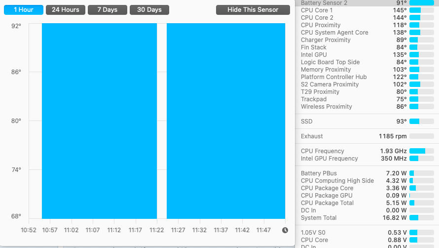

Just wanted to ask if you used iStats menu and monitored battery tempratures does it get stuck at one battery temperature range? iStats noted that my XINGLIT battery was stuck at 85 and 91 degrees respectively. If so then this might be the behavior of third party batteries.
Here's my results from a session watching several 720p and 1080p videos from the battery:
The temperature remained static at 25 degrees. It might be worth checking with coconutBattery to see what the results are. I'm not informed enough to confirm whether this is an accurate method to gauge the battery. Perhaps others can clarify?
