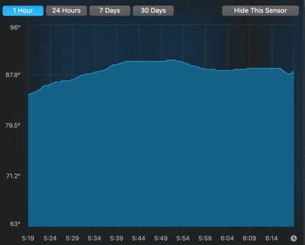

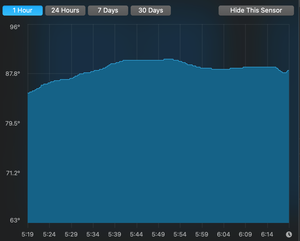

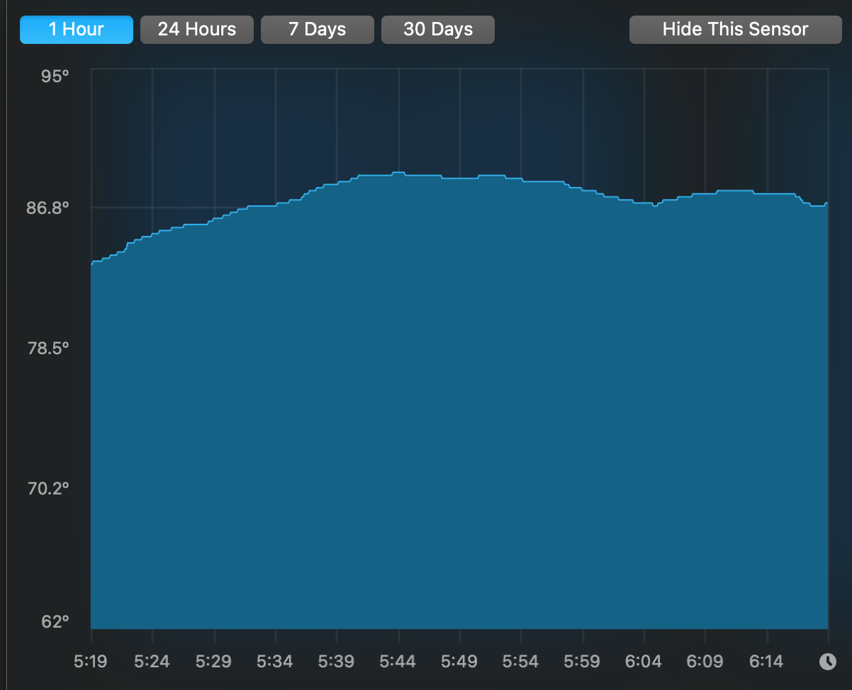

It appears that your battery is third party or counterfeit as having static values is something that seems to be a commonality with third party batteries only but on real apple batteries the values fluctuate as seen in the pictures below. Coconut battery's battery value is I believe a sensor on the MacBook but not actually on the battery cells or third party batteries only have one battery sensor but genuine apple batteries have three battery sensors that monitor temperature. I'm assuming the third party battery is sending back fake temperature values for sensor 1 and sensor 2 but that is just a prediction.
