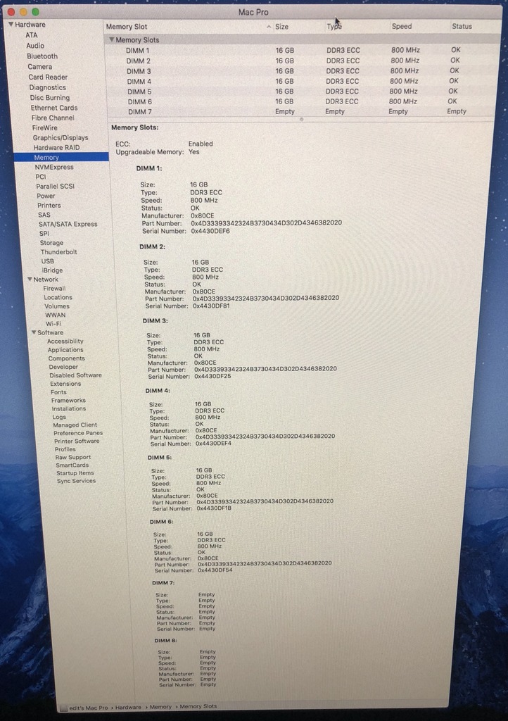

Hi all,
I have a 2010 5,1 with dual x5690's that ha 8 16gb sticks in. In the about this Mac, it is only showing 96gb and when I click over to memory, it shows two open slots, so before troubleshooting the ram sticks, I was wondering if there is anything else I should be looking at in software before going back to the RAM seller.

Strange my Mac Pro 5,1 6core has DIMMS with a clockspeed of 1333 MHz.
I was also wondering why your memory shows a speed of 800 MHz. Any compatible sticks would show (as a minimum)1066, and usually 1333 MHz if yours is actually a macpro5,1

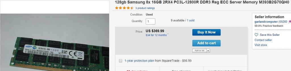

Can you post what memory sticks you are using? If they are all identical - what is listed on each stick's label?

It's likely that your RAM is simply not quite compatible. Yours has a ranking of 4Rx4, which others here (such as the talented H9826790 has suggested) say that you need 2Rx4, as the 4Rx4 typically will not clock at the full bus speed, and may cause other issues, and may simply be unreliable in the MacPro5,1 (just not a good match with the memory bus on your MacPro)
Any clues looking at About this mac -> system report-> memory ?
Clues? The OP doesn't need much more after what was posted in post 1(showing that the RAM may not be running at full speed), and then the label in post #12 shows that the OP has RAM that is considered to be out-of-spec for a MacPro5,1

If 4r4 was 'out of spec' then none of it would show. We know 2r4 works based on some members. Extensive testing of 4r4 hasn't taken place. Apparently, this spec of Samsung 4r4 is working. 😵 I tend to trust the OP's observations.
IMO... Looking at that unnecessary screen can help to determine if a memory channel is blown on one of the CPU's. I've seen many x56xx CPU's with blown memory channel(s) on ebay. 😎

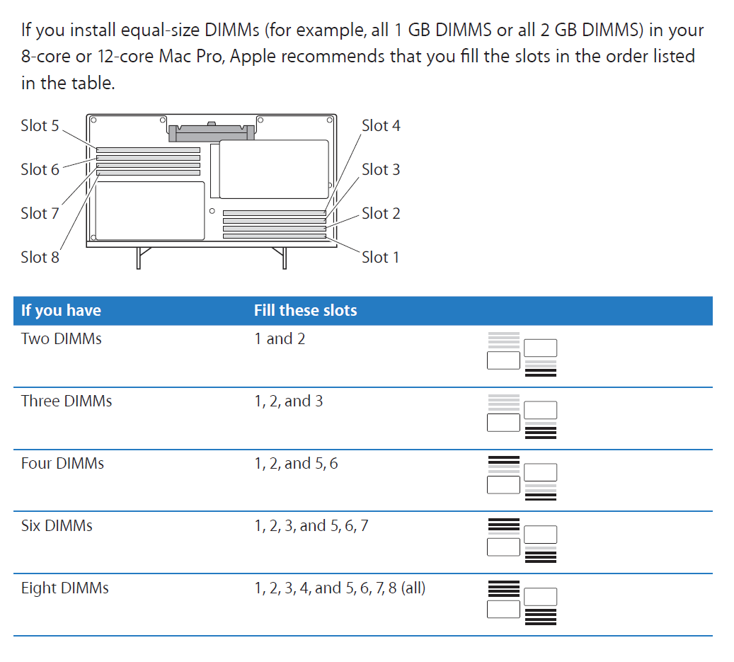

Slots 7 & 8 (and 3 & 4) are physically tied together. And if slot 7 is bad or empty slot 8 won't show. Slot 7 needs to be populated for 8 to be recognized and work. Looks like something is wrong with slot 7 or the CPU. Have you tried switching the CPUs to see if the issue follows the CPU? Have you tried switching the sticks around? As suggested, is there a red light beside slot 7?

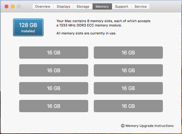

Well, after all that I moved the sticks around and I'm now getting 128gb? Are there any memory stress/test programs that work for a Mac to let me know if I'm good or not?

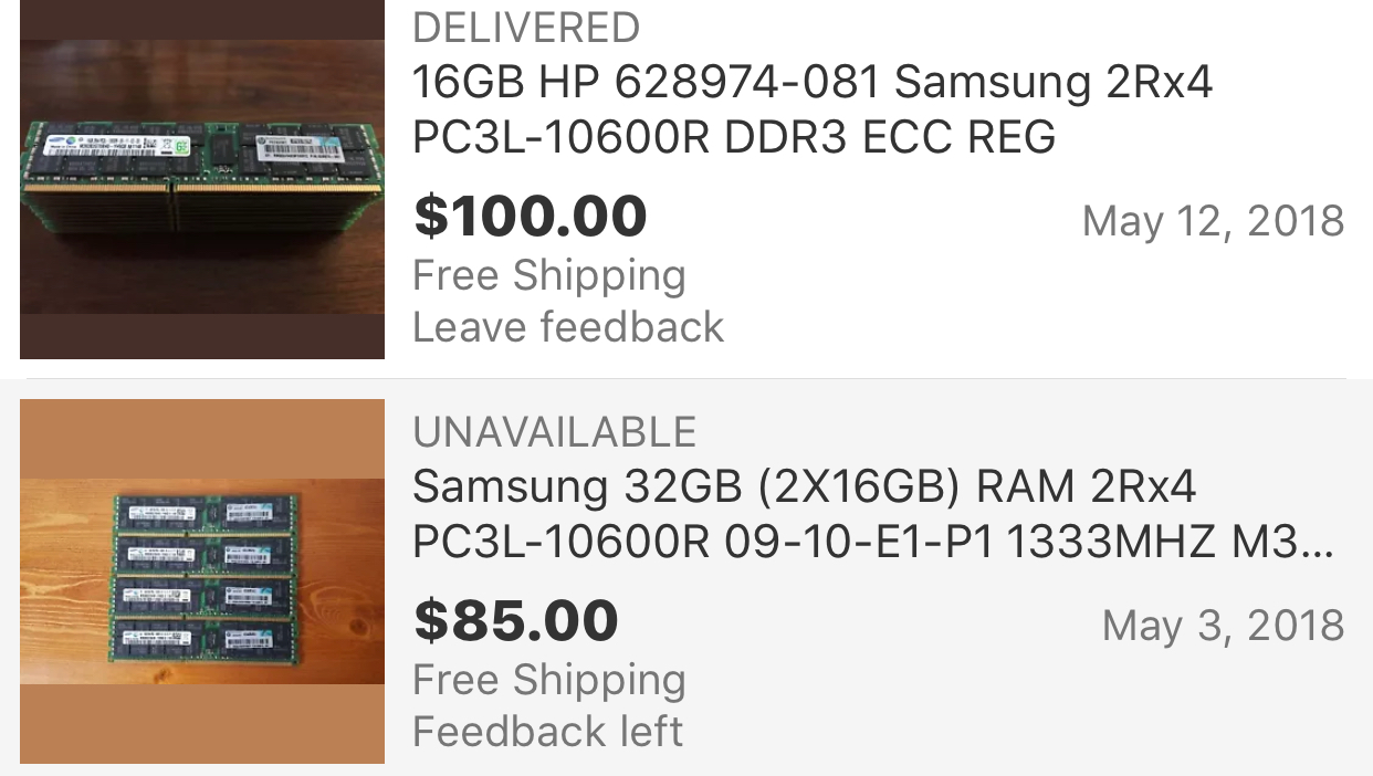

The memory that I was eyeballing is
