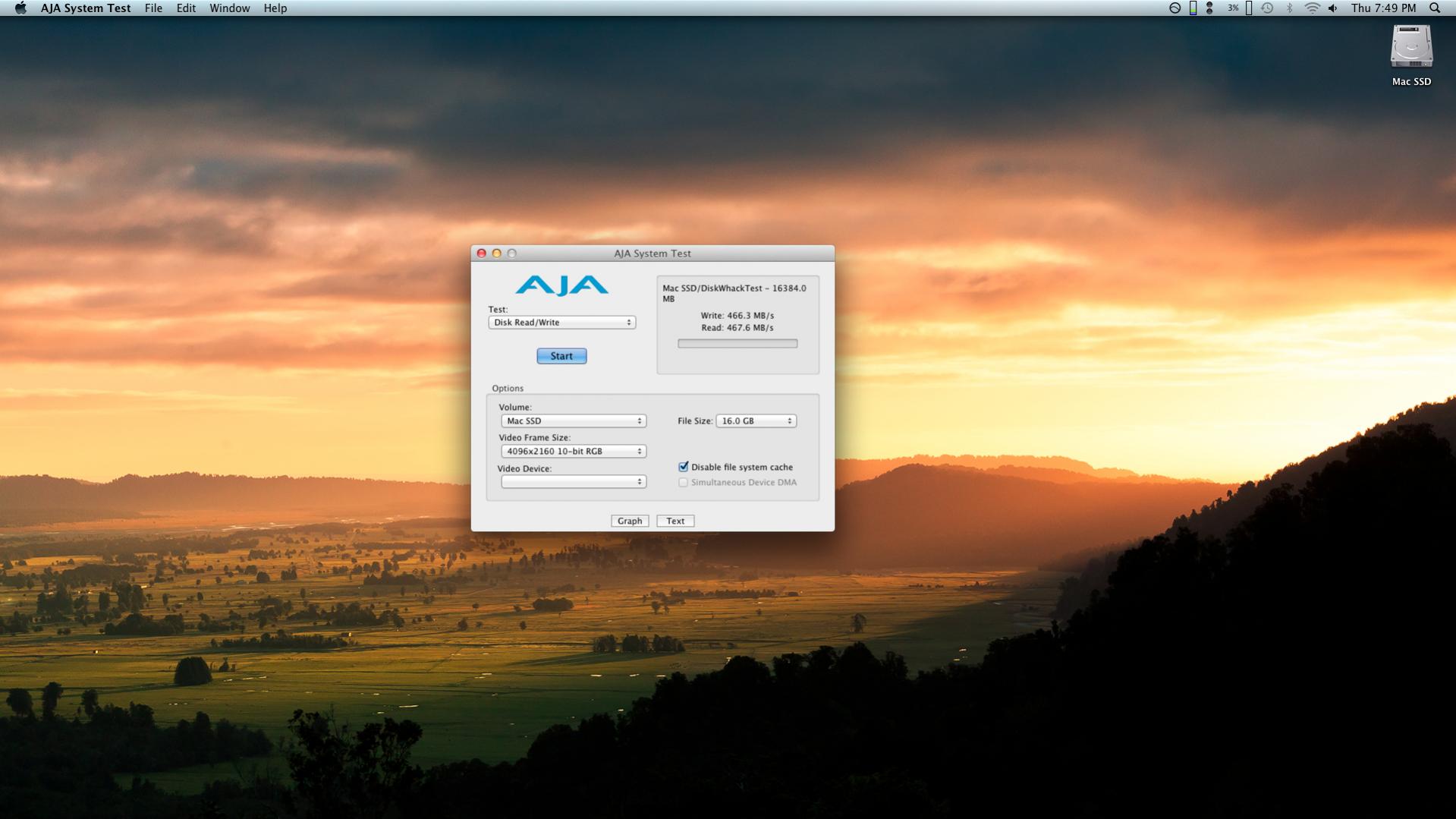

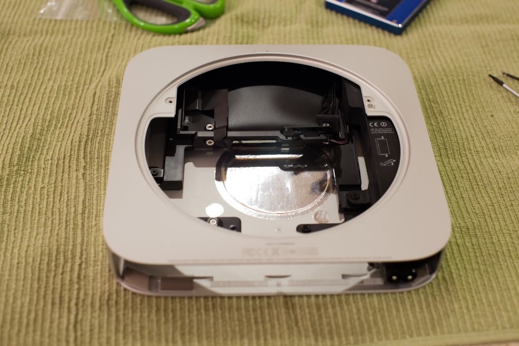

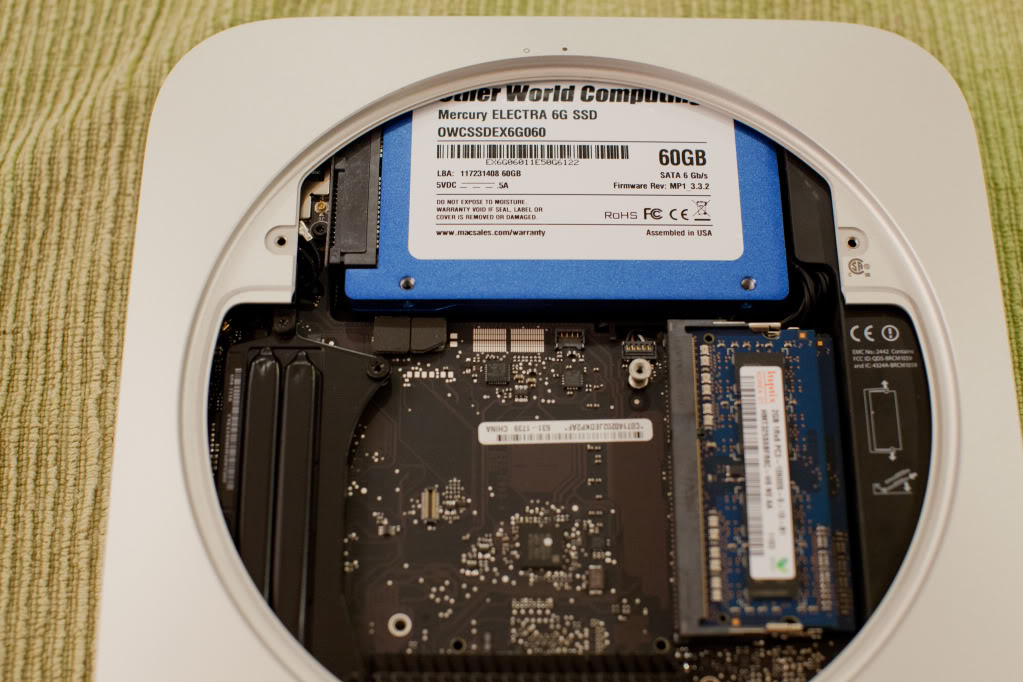

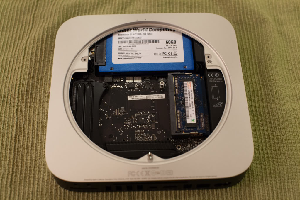

i installed a 60gb owc ssd in the mac mini today. i have ordered the bottom flex cable and will install the second hard drive when the cable arrives. Heres a screen shot of the read and write speed of the 6g drive.

honestly, I'm happy with the performance of this drive for my usage. all i use the mac mini for is the internet, movies & some light photo processing. i have a mac pro and mbp for my heavy video editing for work.
what is the write speed you are getting?

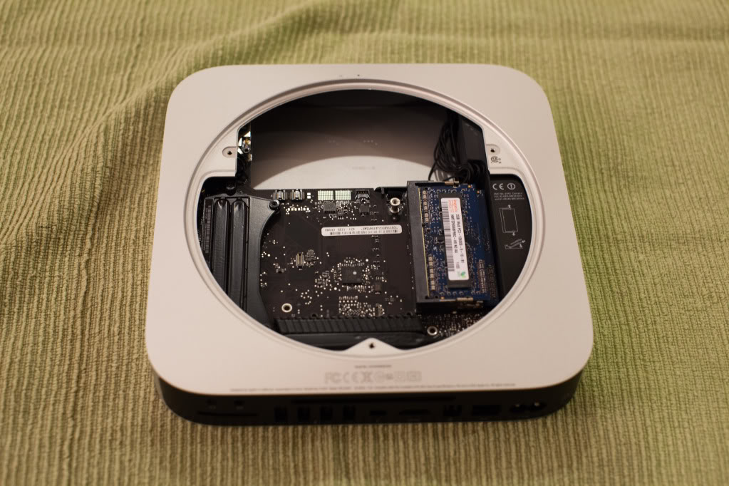

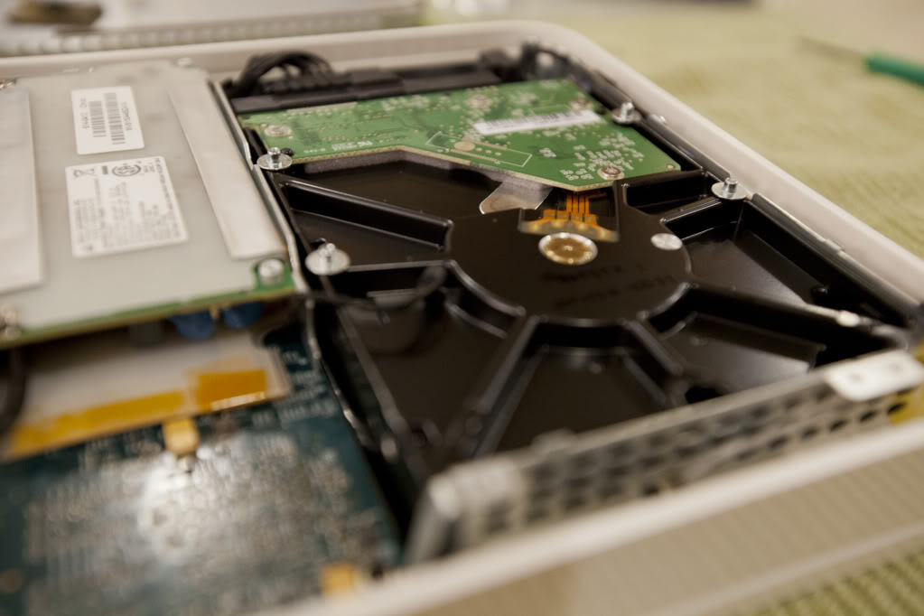

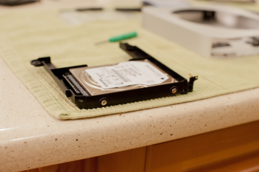

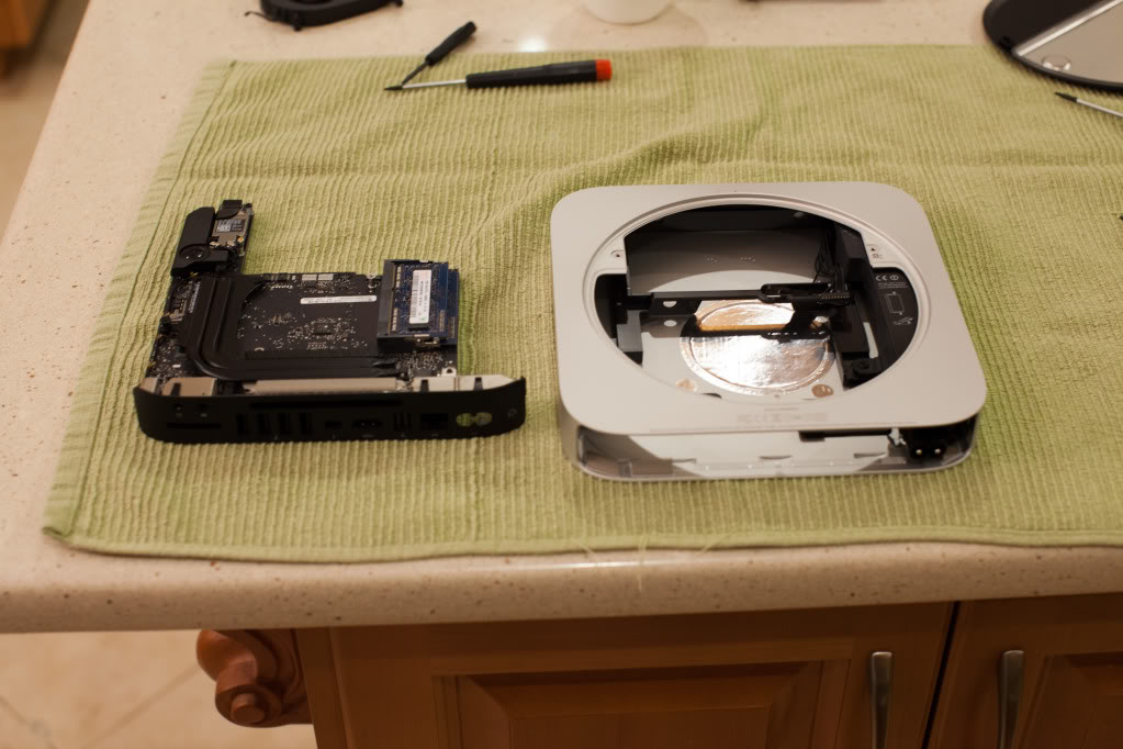

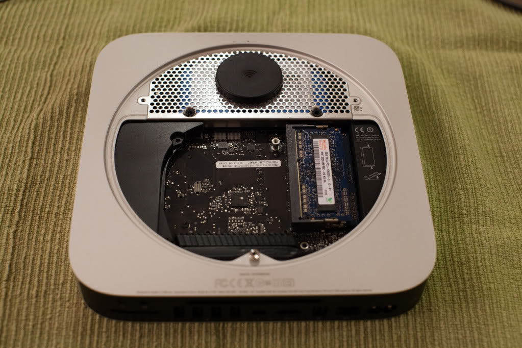

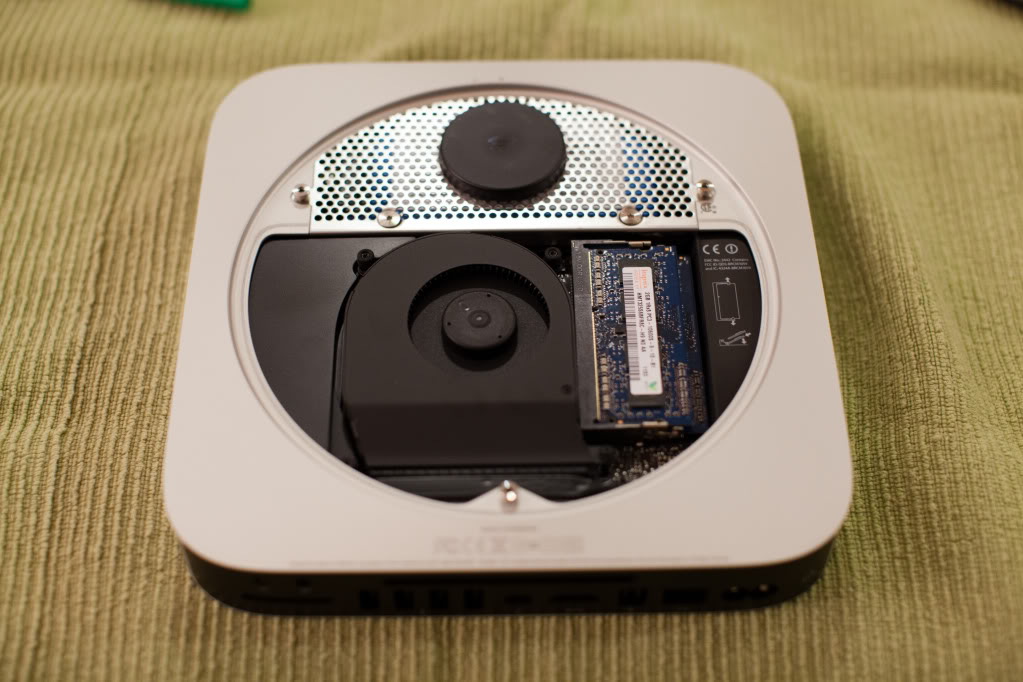

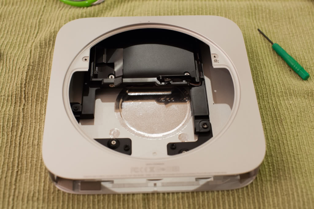

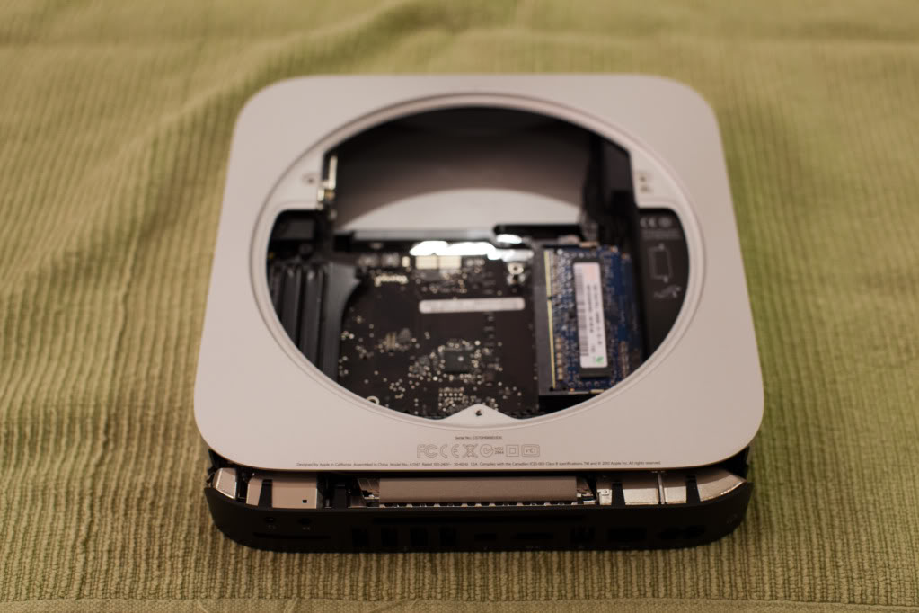

the bottom hard drive flex cable arrived today and i opened up the mac mini again. as others said, taking the logic board to install the second drive helps a lot.

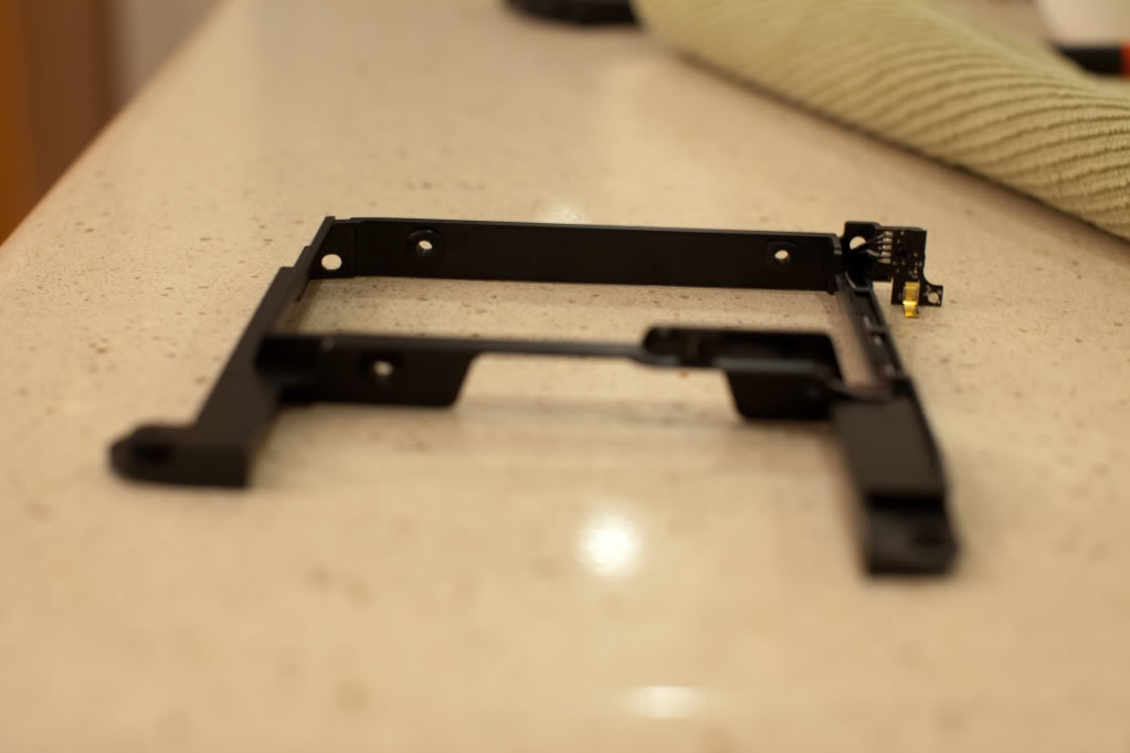

i eventually had to remove the screws from this side of the tray because once inserted into the mac mini the screw holes for the bracket wouldn't line up. i tried shaving down the grommet but with the screws it was still to big. i ended up only using 2 screws on the other side to secure the hard drive. its a snug fit and i don't think the hard drive will move.

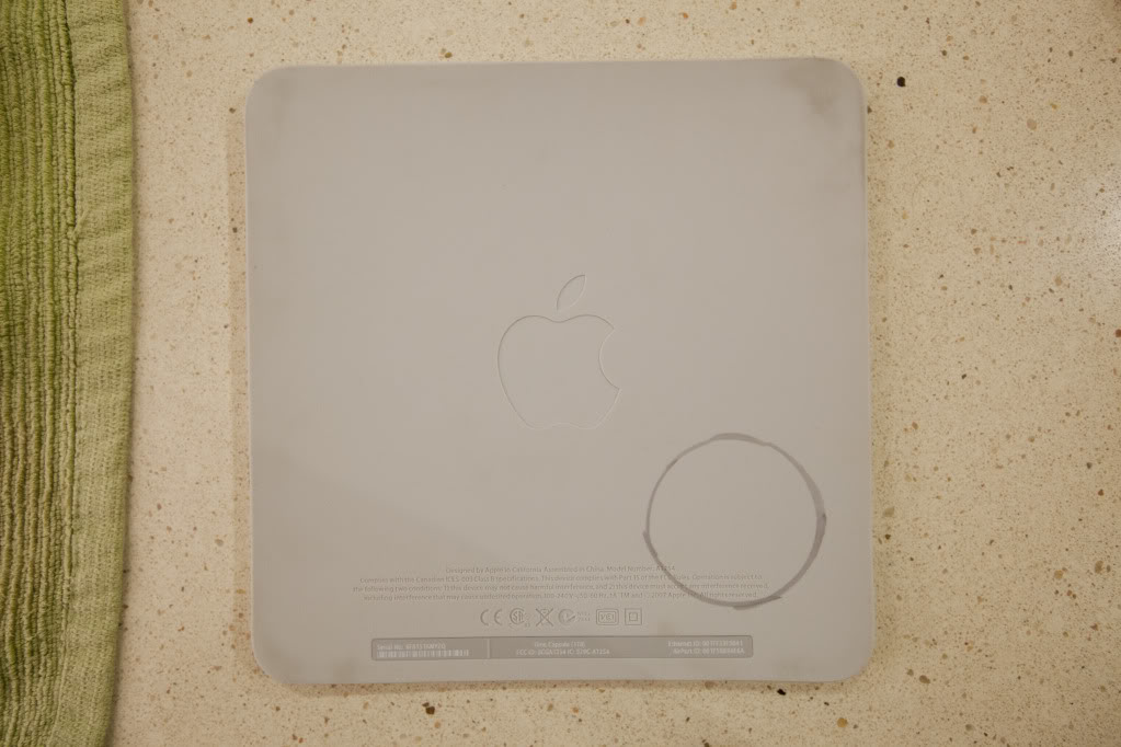

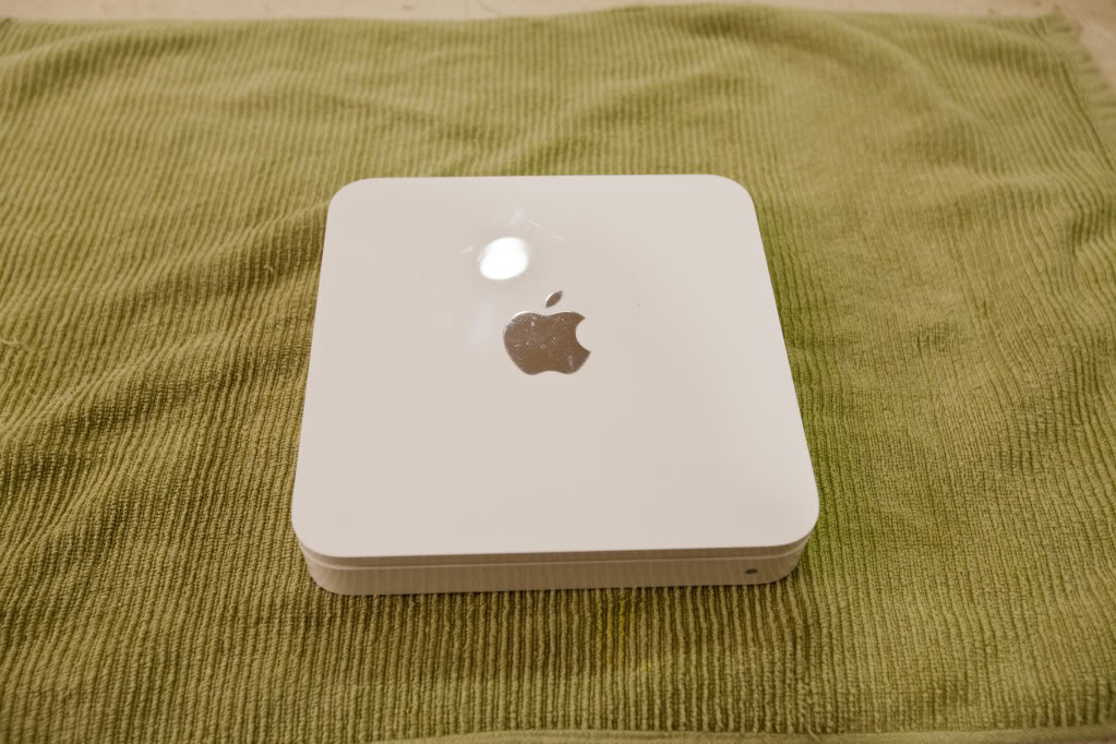

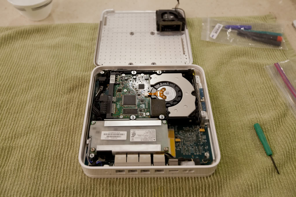

this is a little off-topic but ill post it anyways
I've had my 1st gen TC since its been released and its been running flawlessly for many years. I've read many horror stories online about the TCs breaking down but fortunately I've had no issues. at this time the 1tb hd isn't enough for my backup needs so I'm installing a 2tb western digital caviar green hard drive.

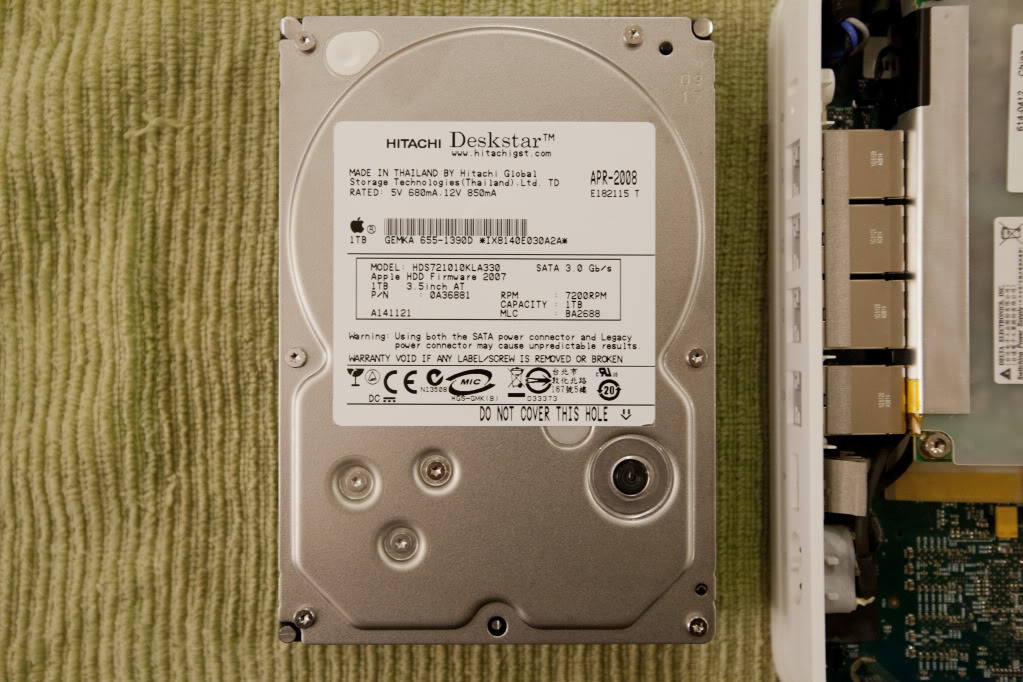

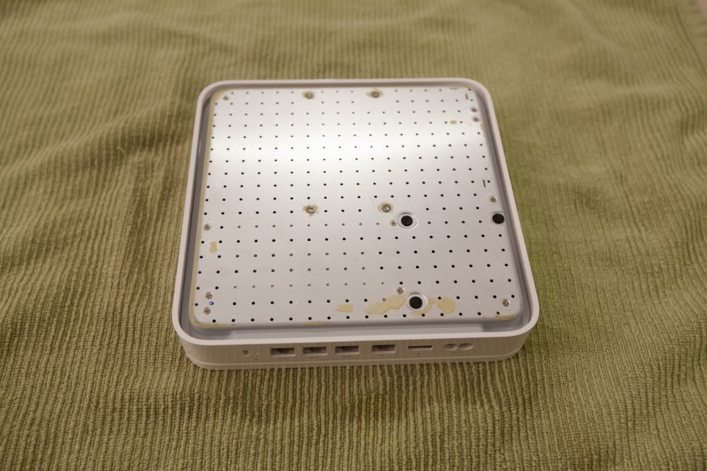

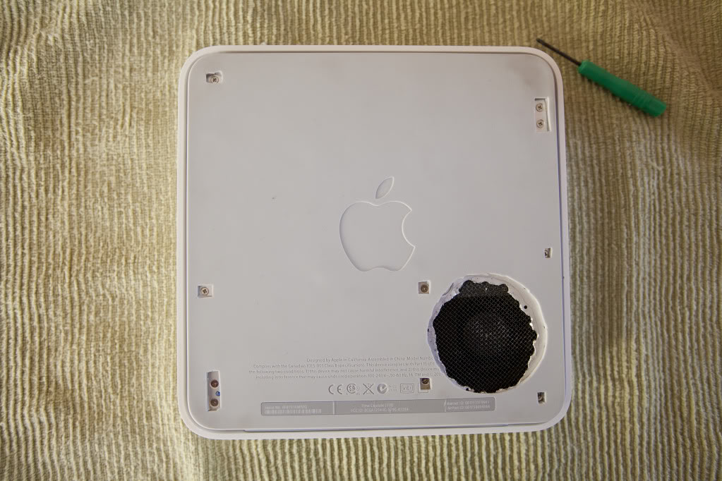

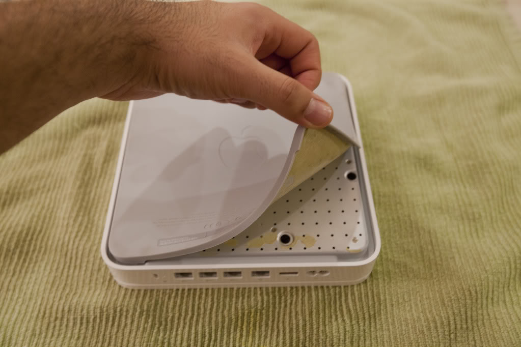

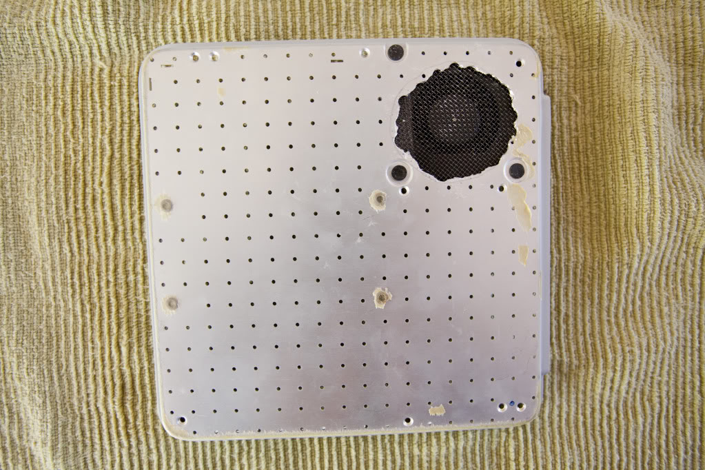

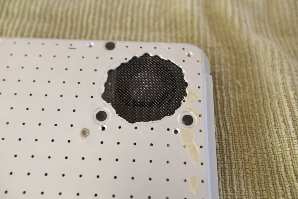

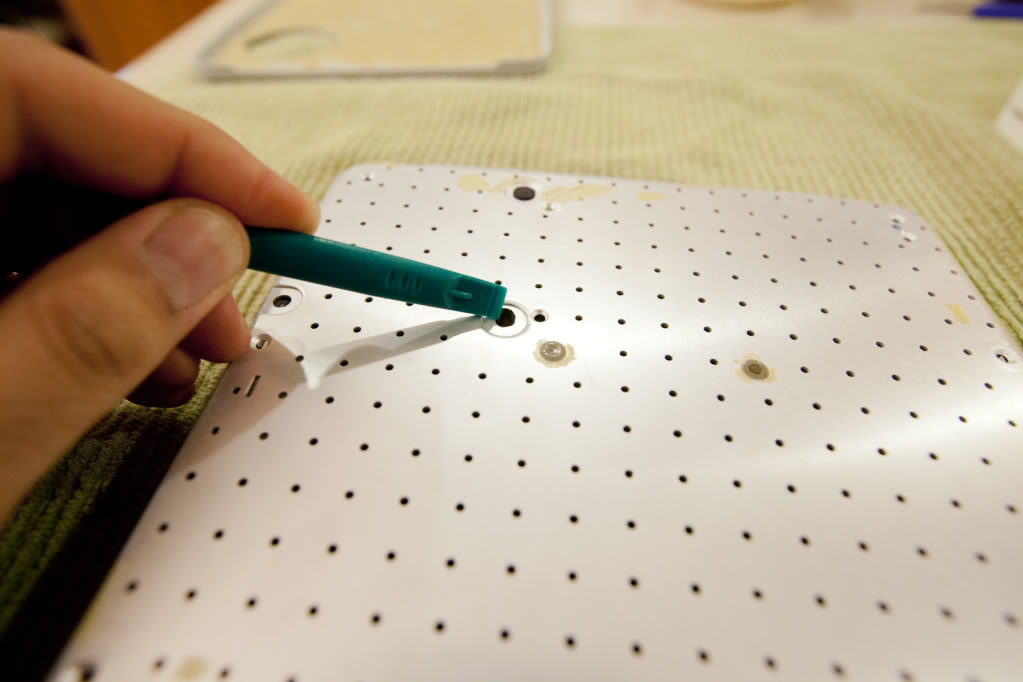

I'm also doing a fan mod by cutting a hole in the metal tray to allow better airflow. overall the install was pretty easy and took about half a day. i must warn you guys its not the prettiest job and i would do somethings differently if i had to do it again.
heat up the rubber with a blowdryer and peal it off slowly
remove the 10 screws
bottom tray removed

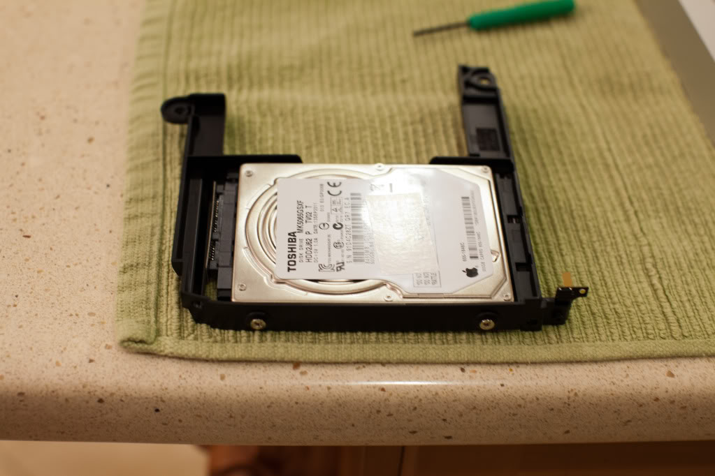

old 1tb hard drive

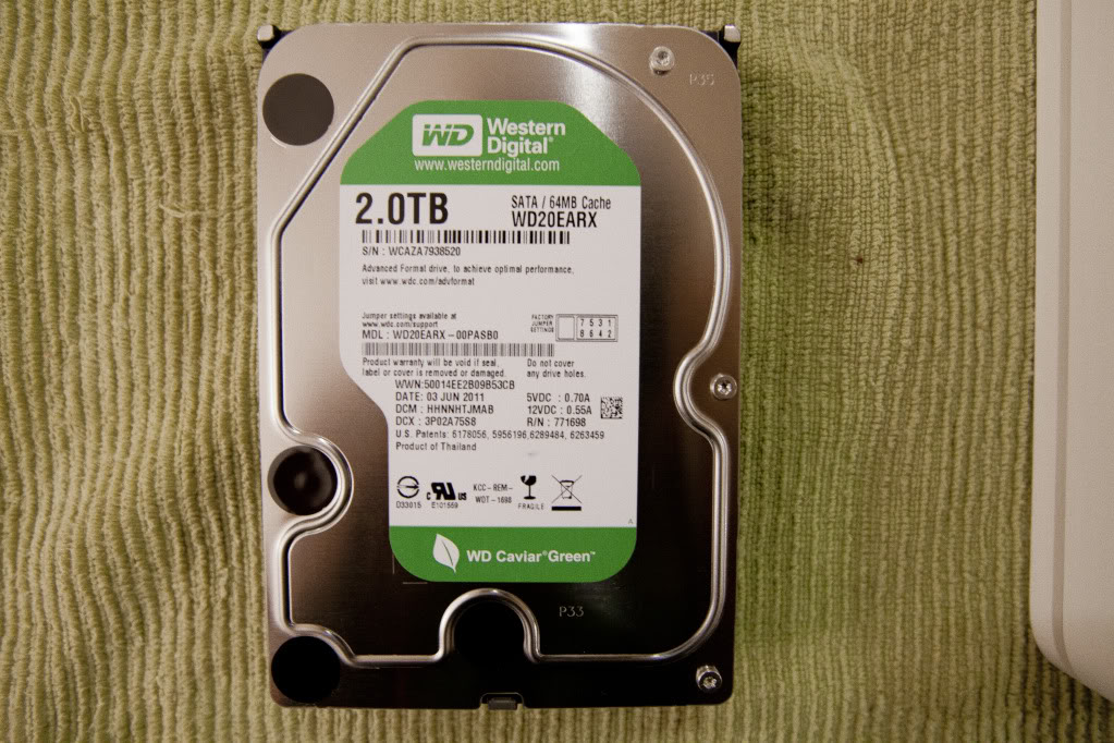

new 2tb western digital caviar green hard drive
remove the screws from the old hard drive and install them on the new hard drive

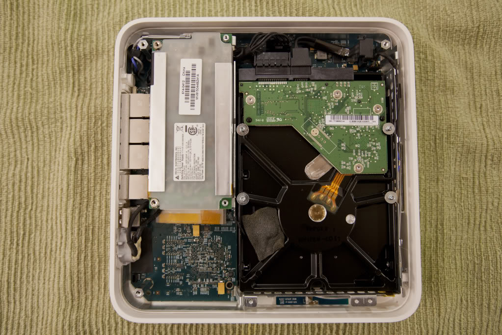

remove the fan by pushing out the rubber tabs. (its a lot harder to install the tabs back into the plate.i used a tiny bit of dish soup on each tab to help them slide in easier)
fan removed

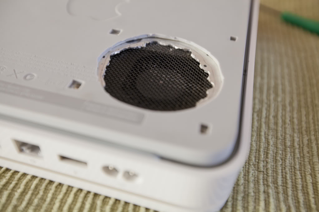

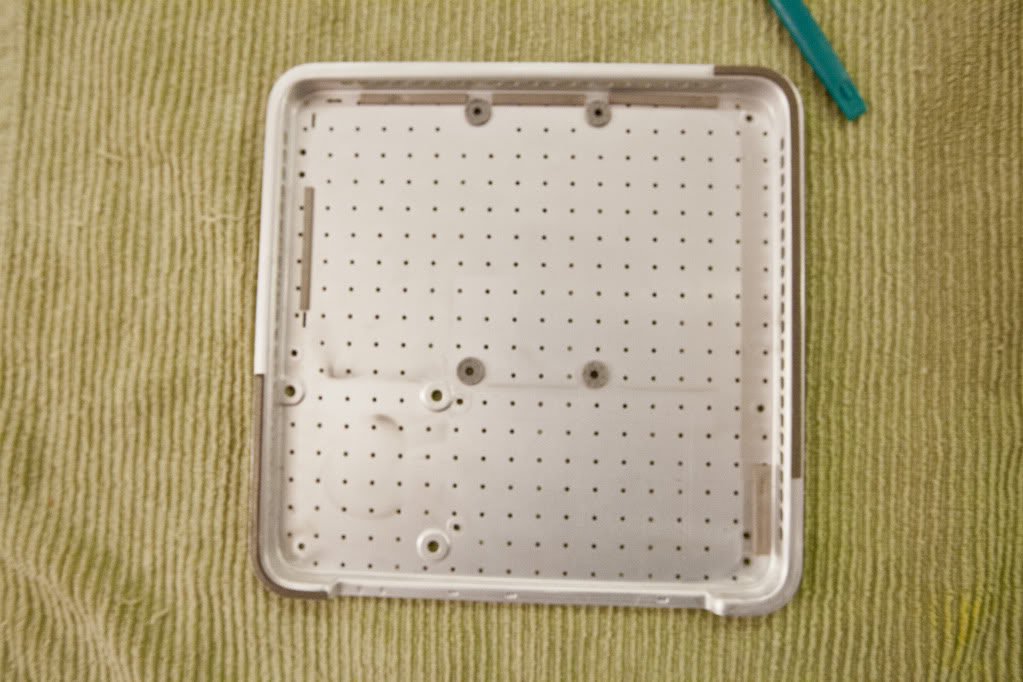

cut a hole in the rubber backing and metal tray
i added a fine metal mesh so protect the fan from debris
i also made 10 holes in the rubber where the screw holes are. doing this will allow me to open up the TC without pealing the rubber backing off.
it just isn't finished. the hole was cut like lot's of people do it, only they use a file (iron file, as it has finer carvings than wooden) to make the circle round.
so get back to work 😀
i also think it sits directly to a desk? so the airflow isn't maybe altered this much? you can maybe put some little rubber feet under the time capsule.

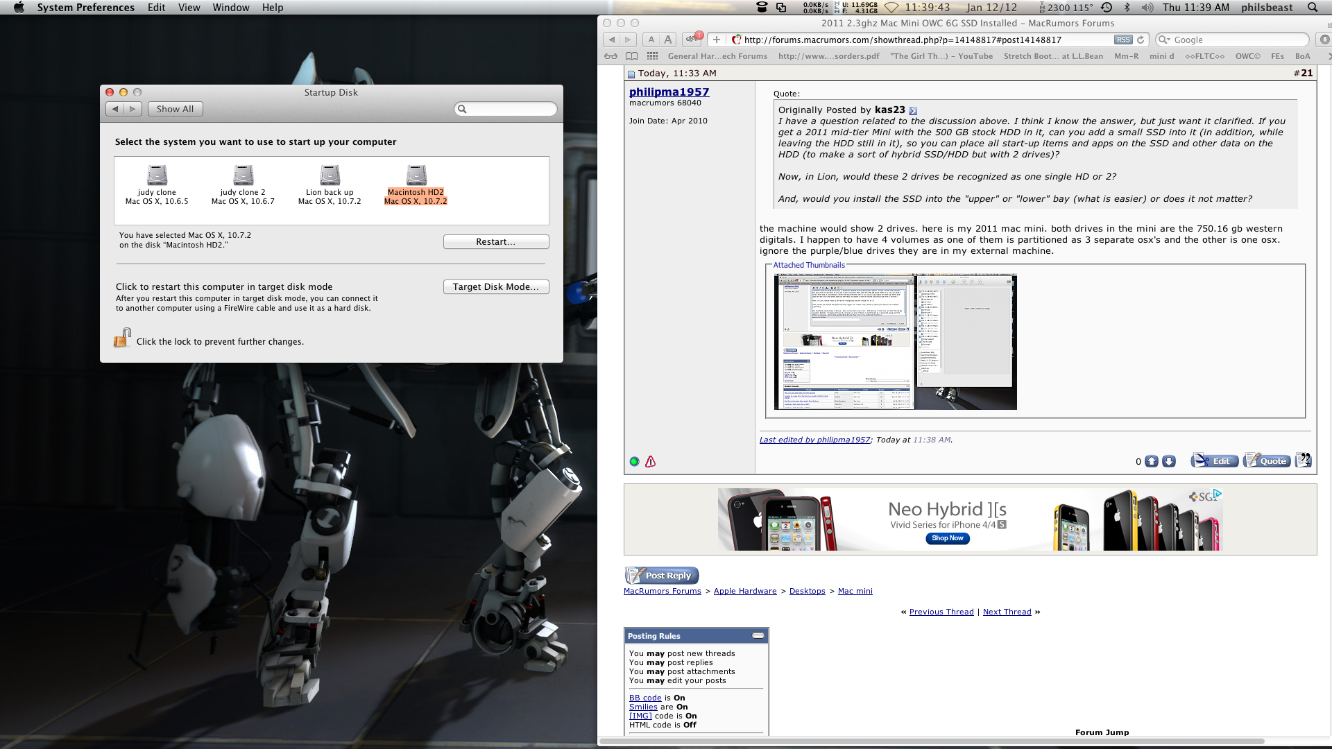

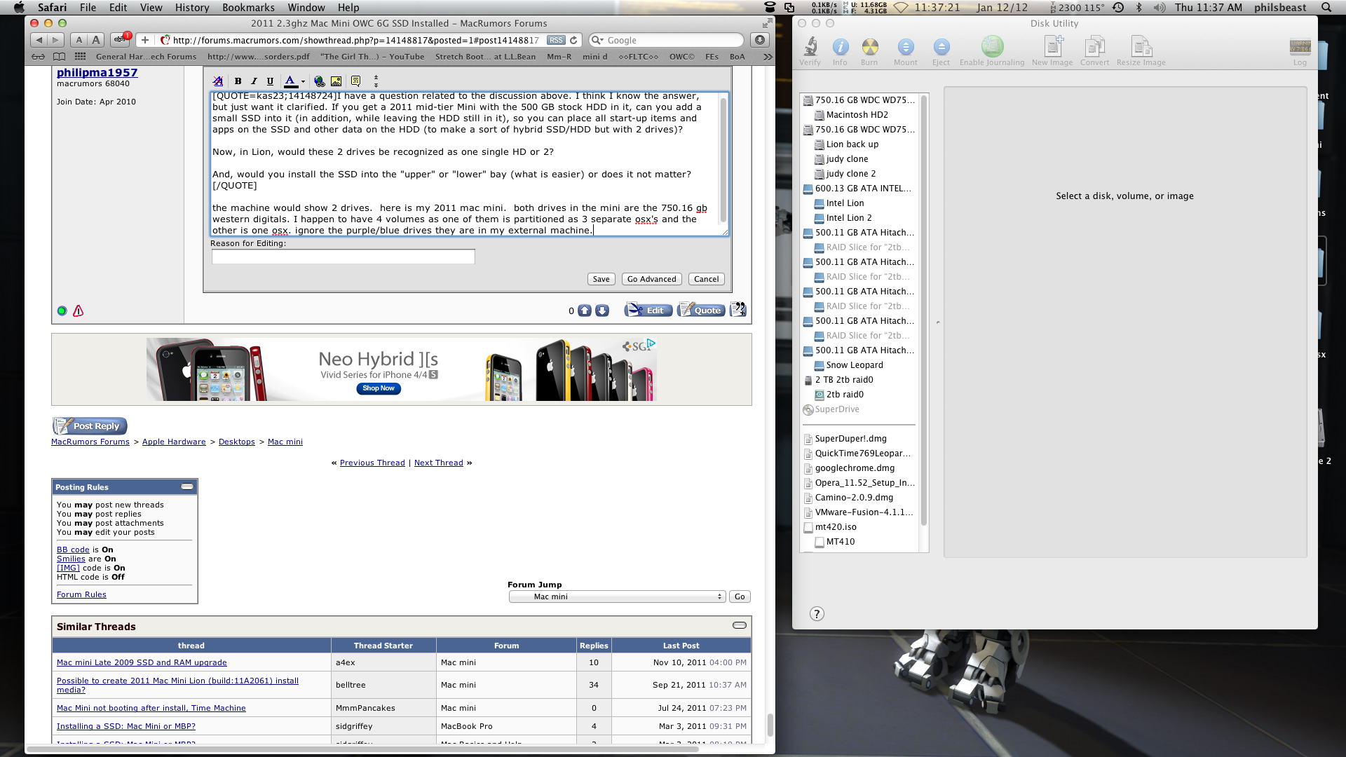

the machine would show 2 drives. here is my 2011 mac mini. both drives in the mini are the 750.16 gb western digitals. I happen to have 4 volumes as one of them is partitioned as 3 separate osx's and the other is one osx. ignore the purple/blue drives they are in my external machine. the second thumbnail shows I can boot with four choices of osx. in your case I would take the 500gb drive make a 60 gb osx backup a 470 gb storage partition and I would take the ssd say a 64gb and use it as the main osx. when you looks at the utility you would see
hdd a
ssd osx
hdd b
back up osx = 60gb partition
storage section = 440gb partition
this can save your butt if the ssd crashes on hdd a you can boot from the osx back up on the other hdd.
hdd a
ssd osx
hdd b
