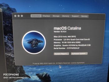

I am wondering if I did something wrong. I followed all of the instructions I could find for my set up.
21.5 mid 2011 iMac with the K2100M.
Everything seems to be working except...
The card was supposed to be 2gb but when I go to About This Mac it lists the GPU as having only 1gb. Is that the way it is supposed to be?
Lol how ? I have same
