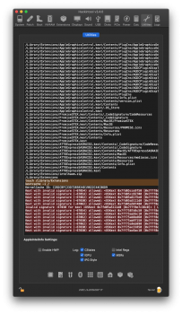

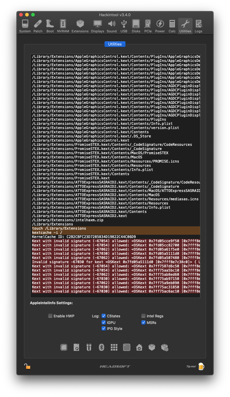

Hi. I've successfully installed 770m to my 27 iMac 2011 then flashed vBIOS with Nick [D]vB beta 3 rom. Both high sierra and bootcamp win 10 worked great, idle temperature is ~50 for the heatsink and ~55 for the PECI. After that I've decided to install Catalina (the reason I did an upgrade) with the dosdude1 patcher. I didn't uncheck "Auto-Apply Post-Install Patches" option because the OP says that it doesn't necessary for my 12,2 iMac. The installment process was passing with the blank screen and I think that's because of 10.15.4 version that's currently installing with the patcher (latest version from the apple servers). After the install process i've managed to successfully boot to 10.15.4 with the screen working from boot menu (holding the alt key). Now i'm trying to install the AppleGraphicControl.kext with the Hackintool utility as described here and I think that everything worked as expected - the process ended up with an error (screenshot attached) and the kext file has been copied to the /l/e/ folder. After that i've opened the terminal and executed "sudo reboot" command but it seems that nothing changed because if the system boots in normal way the screen is still black and I can make it work only if I'm using the boot menu. So the question is what I'm doing wrong or maybe I need another kext file to be added? What exactly I'm doing:

There is no errors in hackintosh log, only warnings. It says "kext with invalid signature allowed".
So my log looks normal? What is wrong then?
AppleGraphicControl.kext is in S/L/E folder. To replace it you need to inject the patched AppleGraphicControl.kext in S/L/E too. And remove the one which is now in L/E folder.
And if it is not done, you should have a clone of your system, in case you make your main system unbootable, playing with system kexts. An error like the one you did can be fatal.
It worked! Thank you!
I have a bootable high sierra usb hdd for that, thank you.
UPD: Maybe we need to add an info about AppleGraphicControl.kext destination to the original post because I think that right now it's unclear.
