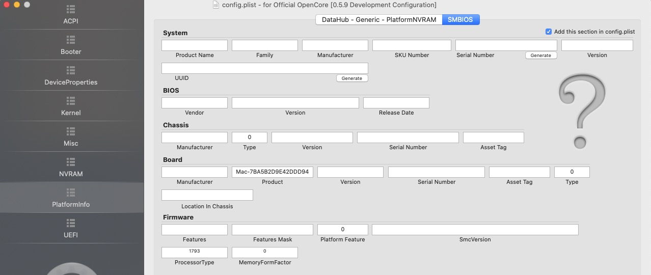

I can only boot to a white after I reset the PRAM. Otherwise the screen is black. Any ideas?
mid 2011 iMac. Catalina 10.14.x. Flashed K610M.
To avoid Black Screen after May 2011 update for High Sierra and using OpenCore with AMD card, there is a solution that works for me.
Replacing AppleGraphicsControl.kext was not enough on my AMD card, i had to block AppleGraphicsDevicePolicy kernel extension too in OpenCore kernel section. (This parameter is checked originally in Catalina Loader AMD config.plist)
As i was on it, i patched too AppleGraphicsControl.kext for Mojave 10.14.6 and Catalina 10.15.5 injecting our iMacs IDs as HighVoltage12v did before.
