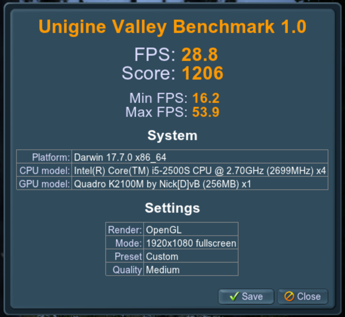

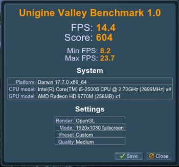

Hi All!
Success here upgrading my iMac mid 2011 27".
From retail it was a i5-2500S with Radeon HD 6770M 512mb.
I got a K2100M from Aliexpress, Dell version and followed exactly the steps from post #1, specially this two:
1) Post #4363 (https://forums.macrumors.com/threads/2011-imac-graphics-card-upgrade.1596614/post-28184981) with the steps needed to flash via linux USB. It was quick and safe.
2) Post #4921 (https://forums.macrumors.com/threads/2011-imac-graphics-card-upgrade.1596614/post-28281414) with the steps to mount OpenCore image on SD card.
With the SD and Usb-drive ready, I swapped my video card (With the X brace from HD6770).
Connected via SSH from another mac, I've flashed the new card.
With the SSD cables attached and SD card inserted, I've rebooted and everything works flawlessly!
High Sierra booted up OK, brightness control working and the best part: almost 2x more powerfull than HD6770.
Tomorrow I'll try to upgrade my CPU too. I've bought a i7-2600S to replace the i5. I know there is a little (or zero) improvement lol
Many thanks to everybody that put so much effort on this project and made all this possible!
Sorry about my english!
