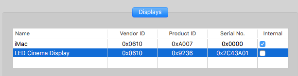

Hi All, I have a question regarding external displays - I have K1100M on iMac 27 2011, running Dosdude1's Catalina Patch, custom bios and OpenCore loader all working fine, when connecting to an external HDMI monitor, the mini-dp to HDMI cable works fine, graphics shows.
However when used with Apple's LED Cinema Display (27-Inch)(non thunderbolt), I can only get Bootcamp Windows to show up on the Cinema Display. When in Catalina 10.15.4 (With OpenCore or not), the Cinema Display remains undetected (either from OpenCore or not). When in High Sierra with or without OpenCore, it works fine.
This is really strange as it is only Catalina that it is having problem with.
Any one can shed some light? Thanks.
Works on High Sierra

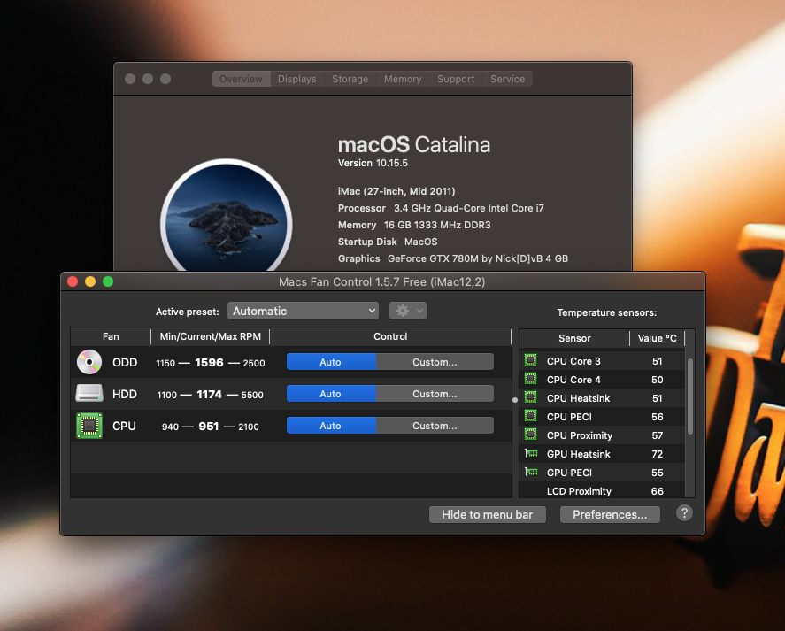

Hey guys! Big thanks to everyone who made these upgrades possible! I successfully upgraded mine to a 780m but the GPU heatsink temps seems a bit high at idle and wanted to compare them with the rest of you. I have the optical drive removed, maybe that is the issue? I also have an issue with connecting a second display, it doesn't work in MacOS but it works in Windows weirdly enough. Any advice please?
Update: Doing a PRAM and SMC reset seems to have solved the high GPU temps for now but i still have the issue with the second display not working in MacOS.
