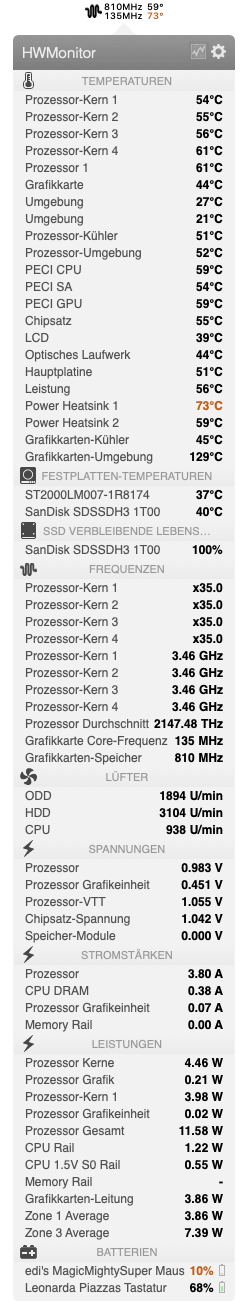

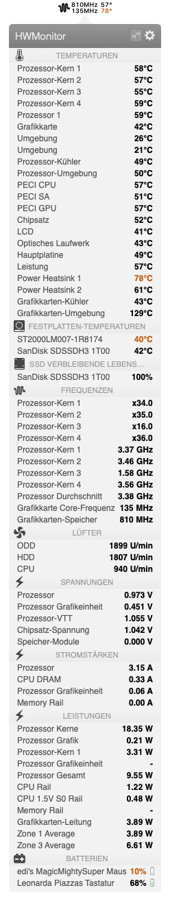

thanks for the updated guide! that helped A LOT.
2011 iMac12,2 with Nvidia K2100M
- sleep is working
- no black screens anymore after 10.15.4
- reflashed Catalina Loader with Etcher > now I can select it as default Startup Disc!
- H.264 acceleration is working
my temps (especially Power Heatsink) are still high, during normal surfing and that's bothering. I thought that is not an issue anymore when I switch to K2100m with native brightness control
any ideas?

Probably you should have reinstalled the i7 CPU or at least the thermal paste on it? I rarely see (if ever) 60 C on the CPU core. The GPU is idle (135Mhz core and 810 MHz memory) , the CPU is not. Probably spotlight is re-indexing the internal MacOS data?
The brightness control does not affect in any way your CPU usage!
Reactions: snam11
you are right, its working right now, and I switched the cPU so its brand new thermal paste and I know what I'm doing here 😉
ok i will report back, I thought that Power Heatsink 1 was not CPU but GPU. will report back, the temps are crazy, see screenshot

Probably you ran a valley benchmark just before because the GPU Peci shows 59 C, too. I use Mac Fan Control and a more aggressive setting ramping up the ODD fan to control the GPU heat sink temperature. You cannot start with it after reaching 70C - this is too late.
You are going to kill your card if you do not adjust this! Watch the sensors - there is reason why the HW Monitor is provided on the Catalina Loader.
One of the most serious issues is the loss of the thermal sensor on the GPU for the Apple thermo regulation. Even Mac Fan Control gets no access to the sensor of the new cards - so you have to control it using the heat sink data and having a good installation!

I also have (what seems like) very high "Power Heatsink 1" temperatures and after my years of working with these machines, I'll reiterate what someone once told me when I bought my first Mac Pro - "If you stare at the sensors too long, you're going to find a problem." These guys ran (and still run!) VERY HOT, and are just fine. Last week, I had a power flash overnight and woke up to all 5 of my iMacs running full blast at the OpenCore screen, almost burning to the touch, and they were fine. I guess that's what you get with 10 year old electronic? 😛
But isn’t power heatsink 1 On the let side of the Mac where the power boards are? When I put my hand on the iMacs frame I can feel the heat and where it’s been generated. The odd fan is on the right bottom and is going above the hdd/odd and gpu heatsink.
AFAIK the high power heatsink 1 is like with a 770m and without any brightness control = Maximum brightness all the time. But here with k2100m it’s controlled and should be cooler
I misread you first post, was just focussed on the GPU heat sink. Assuming the power heat sink is located on the power supply your only choice to cool this down is ramping up the CPU fan... but I do not know.
Just search the web for more temperature data of the 2011 power heat sink, I guess the value shown in your post is not a problem. The Apple thermo management should work on this side of the machine and you probably had the very same values all the time before watching it closely.
And, no: The LCD becomes cooler because the OpenCore allows the brightness control to work, again. Unless you boost it to max. again... There is no link between brightness and the power heat sink as far as I can see. Do not ask me where you got the 78 degrees from. This is a separate issue/feature/problem..
I have 50/51 for both power heat sinks 1/2 after a full day running and working at my 2011. And 61/53 after a half an hour running Valley using a 70W card with brightness control enabled. Mac Fan Control shows me a PSU Primary sensor - try to control the CPU fan using this one. Of try to ramp up all three fans a little bit...
