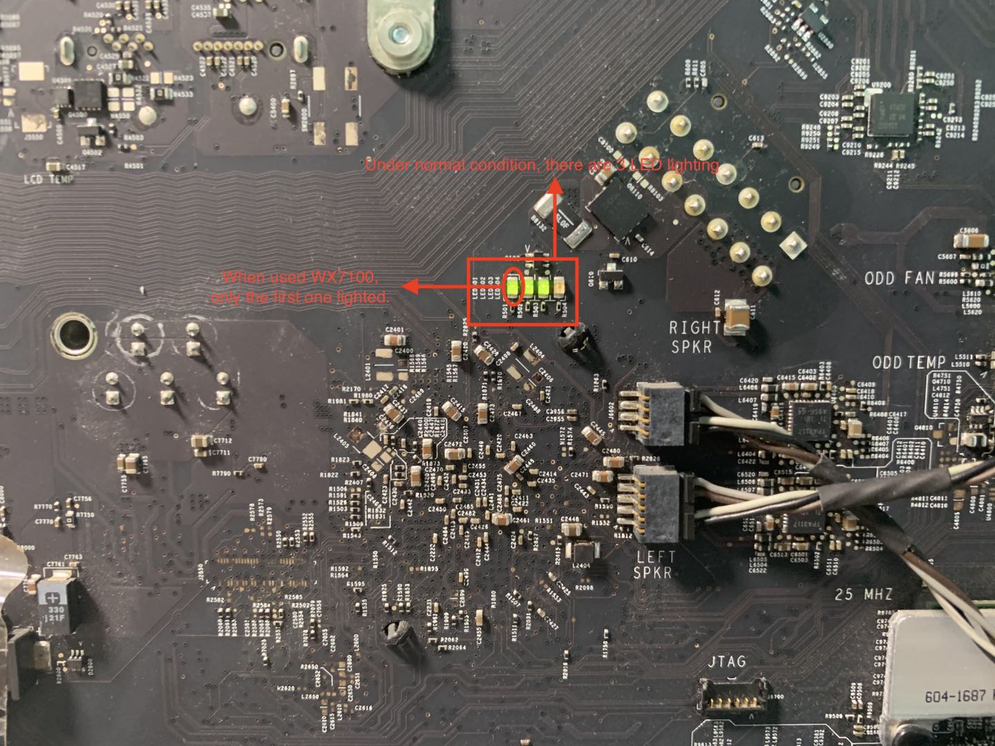

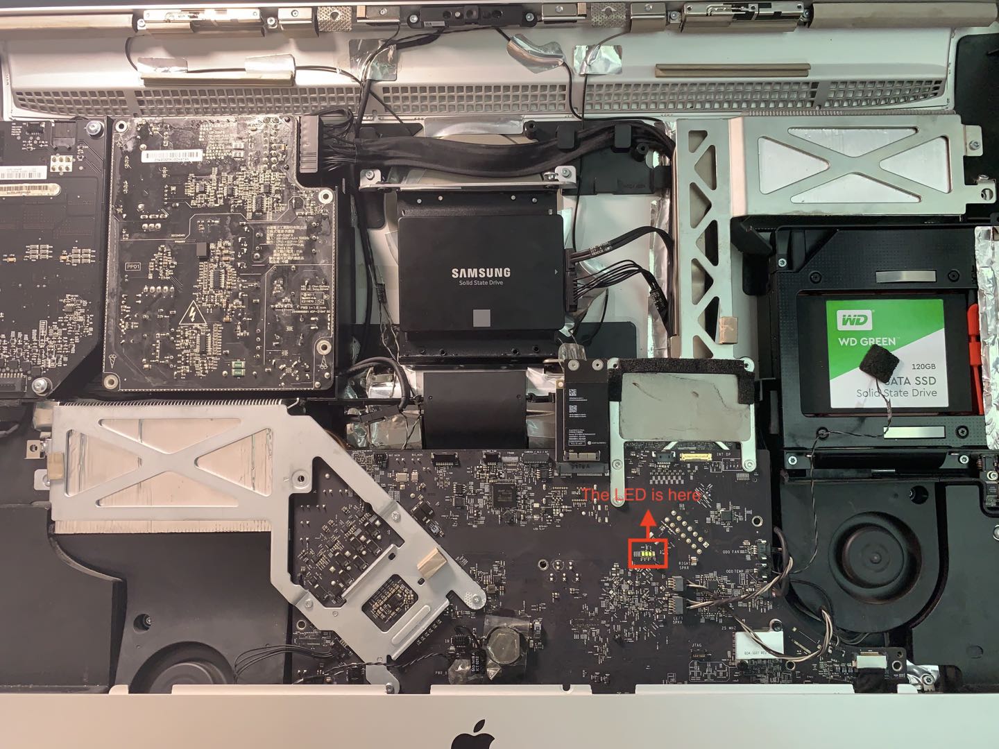

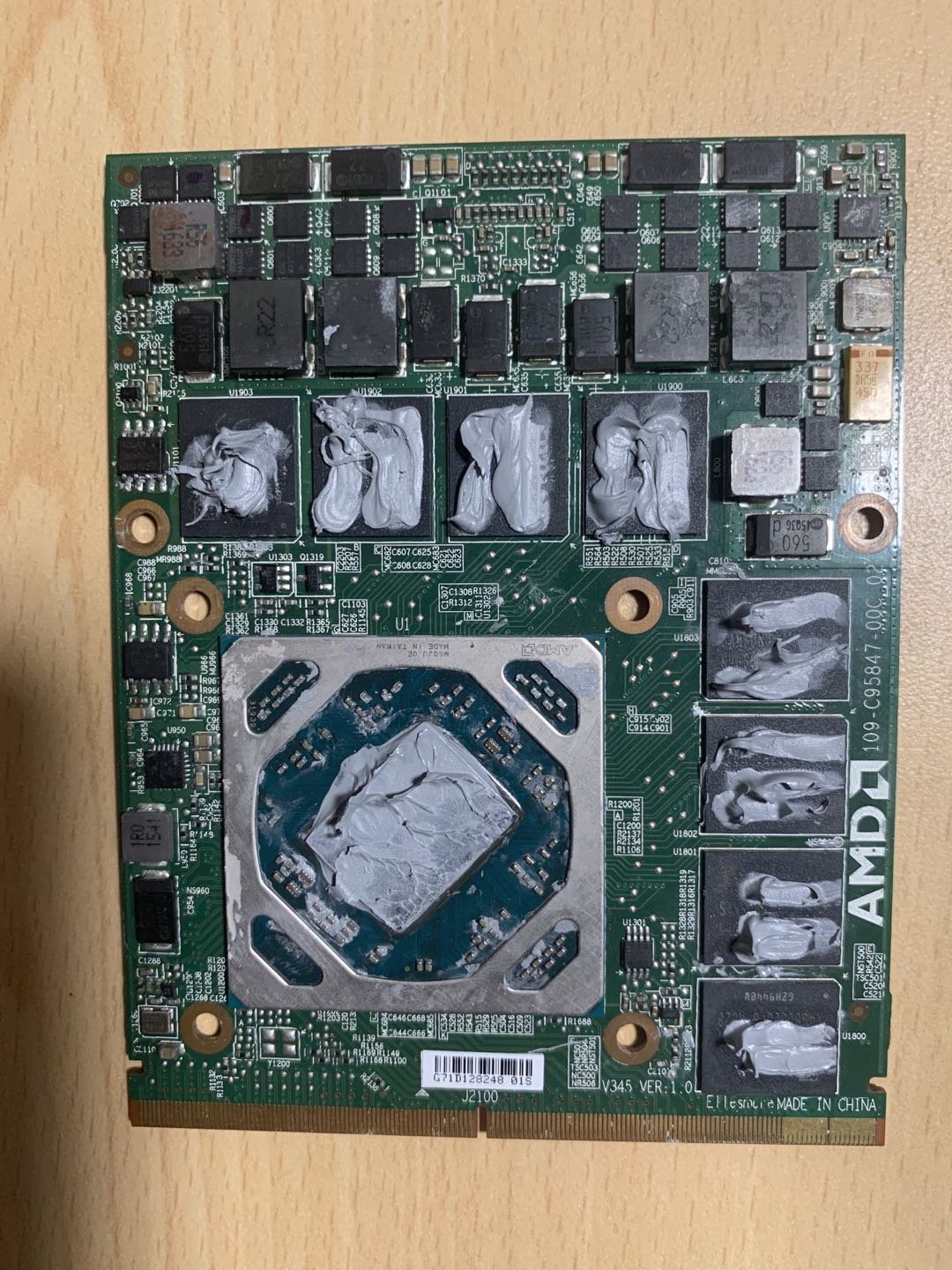

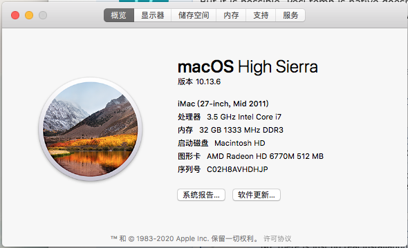

Hi guys!
I'm a university student from Beijing,China.
I have been following this post for some time. Sorry for my poor English. I hope you guys can understand what i mean.
I'm using a 2011 iMac 27’ with AMD Radeon HD 6770M 512MB, and actually my graphics card works well, except when I using applications like Adobe Illustrator it warns that it's out of graphic memory, my graphics card must be more than 1GB. So I want to change a grapic card.
I bought the WX7100 with109-C95847-00C 02 from Alibaba, but unfortunately it doesn't work properly.
The fan only turns on for one second when I touch power on, and the screen stays black.
I observed some anomalies on the motherboard. Under normal condition, there will be three regular lights on the host LED lamp, but only the first one on the left will be on after the replacement of WX7100, and the power supply has a subtle ticking sound, like the sound of a clock's second hand turning.
In addition, I didn't use the GOP ROM of @ Nick [D] VB because I didn't have any other computers to flash the ROM……
(I guess it's probably the lack of power supply? Because the power of the wx7100 is much higher than the original amd radon HD 6770m)
(The seller tested the card works well in a Dell laptop before he sent it to me……But he allowed me to replace it:)
Now, I'm going to replace wx4170. Can someone give me some details? Are all models available for normal use or must it be a specific version number?
Thank you all,
Have a nice day!
Benham

Hello and welcome. It is really important to check the first page. You will see that the WX7100 card is hit and miss. Did you flash it with the ROM from the first page? Follow all the instructions on the first post.
Good luck!

You need to flash with the GOP ROM in any case. Using the ROM delivered on the card will likely end up in a non posting card as you have it. And even with the ROM flashed you may have a not working card in the 2011 - the reason is unknown. The MXM standard has not been used by any vendor in the same way...
If you get the WX4170 you need one with a BIOS chip on board.
EDIT:
Your card was a VER 1.0 card which is now known to fail in iMac12,2 systems.
You would have needed a more recent VER 1.1 revision.
